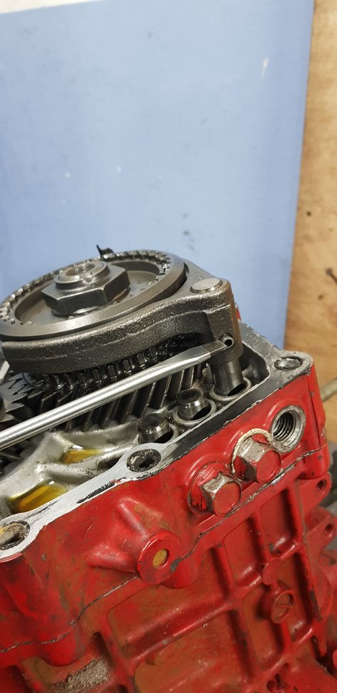

Hi guys. Need help and advise on how to actually strip down the gearbox. Ive openes up the top cover and i am stuck on how to remove the middle portion. Trying to figure out how to remove the fork. Ive removed the ball bearings held by a bolt on the side of the gbox and i still cant slide the fork out.
Ive also removed the syncro placed at the the nut im pointing to in the picture. On the other pic i saw a pin. Should i remove that pin to get the fork out? And should i remove those nut i pointed in the pic as well?
Those experienced please shed some light tq 😁

This Video might be helpful to you :

its. CE9A evo iii gbox
https://m.youtube.com/watch?v=cqMKHwen1Do
the video really helped thanks buddy
