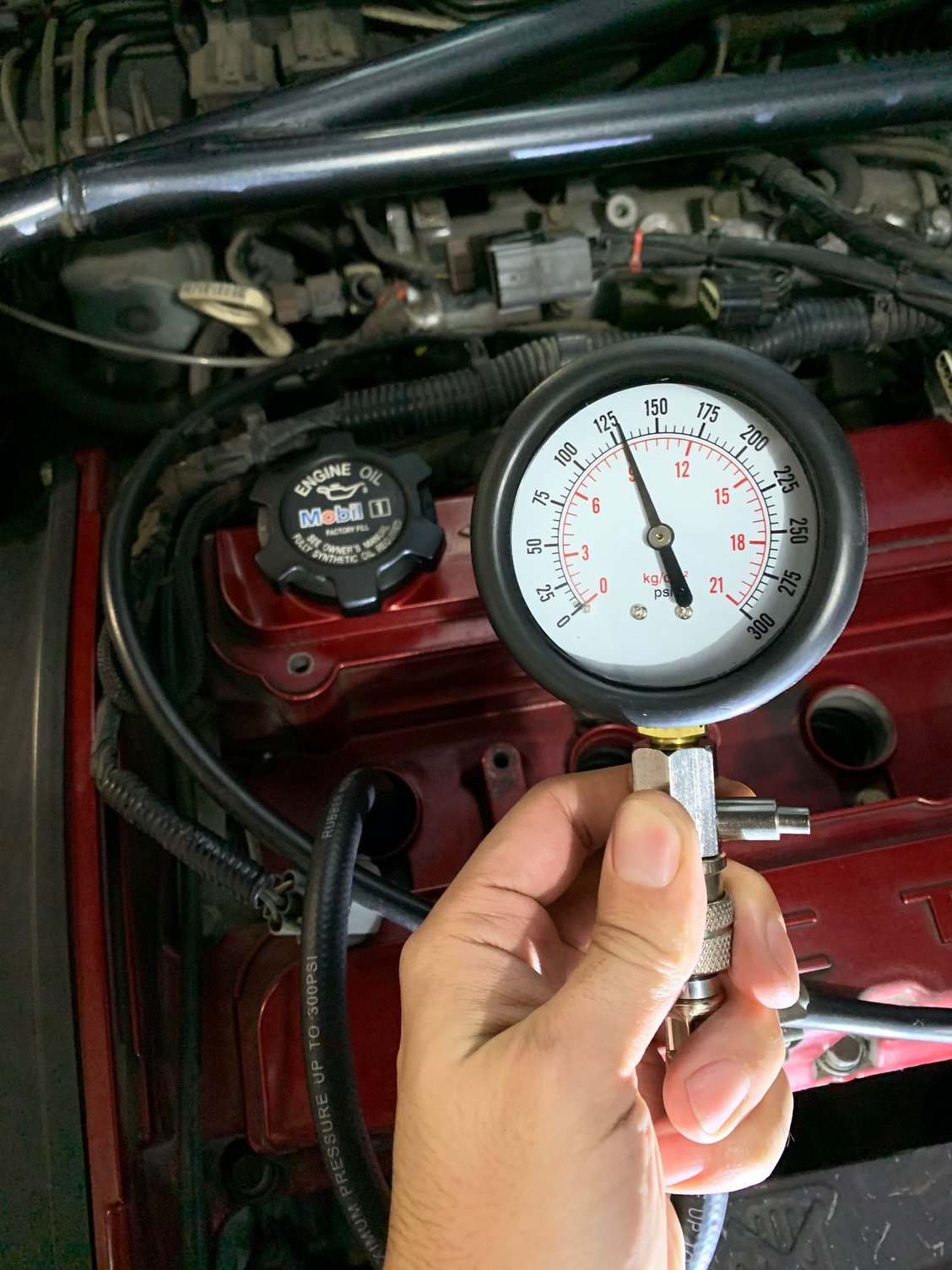

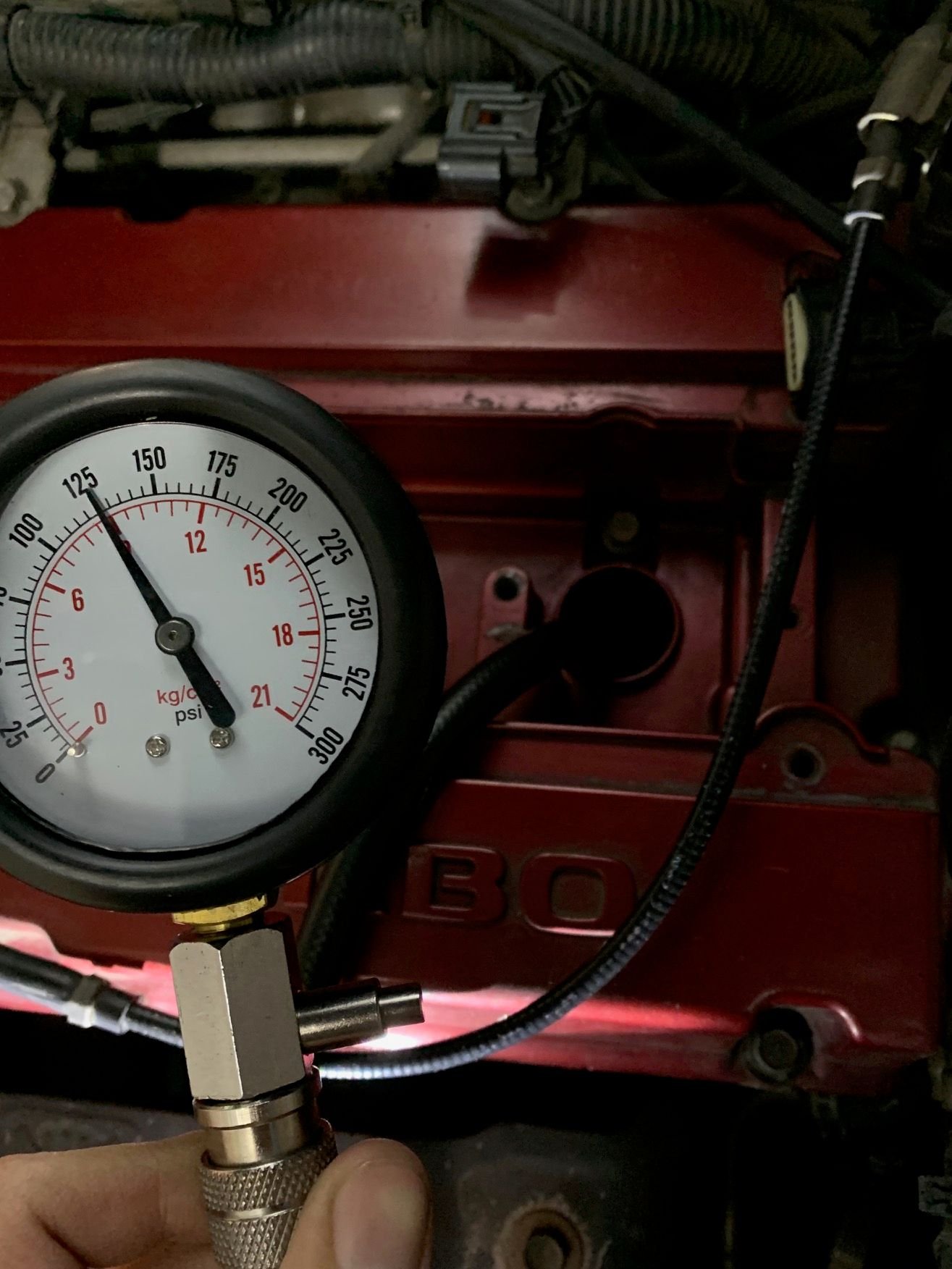

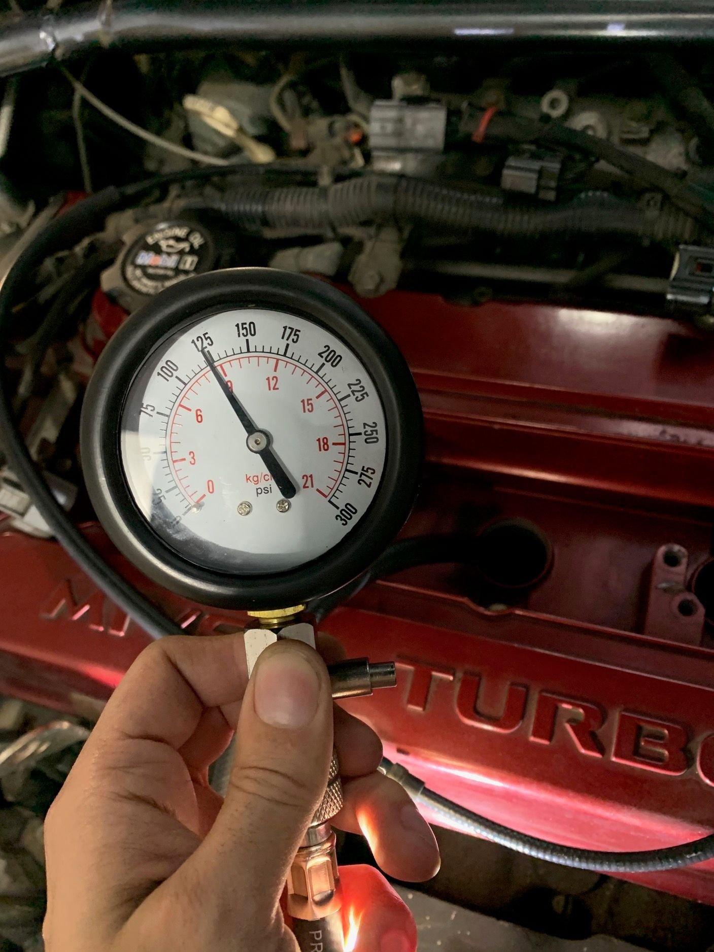

Hello all*currently have a evo*9 with around 70k miles that has started to develop a new undesirable sound. A little history this is a built engine making around 400hp. As of right now*it is not being driven, but does not*seem to suffer performance issues when it is. The sound is audible on startup. Been running on a E85 map/tune*longer than normal (got stuck in traffic a bit more than normal past month) and noticed the car was eating up quite a bit more oil than normal when checked. I do see some white coming out the exhaust, and the car has normally eaten some oil but not as much as recent which causes concern. The sound seems to lessen when the car warms up. It goes with the speed of the engine and comes from the Serpentine belt/Timing belt side of the engine. No Check Engine
Just want to narrow down the list to what some other evo owners think.
Ran a compression test all cylinders fire even across*the board 125-125-125-125

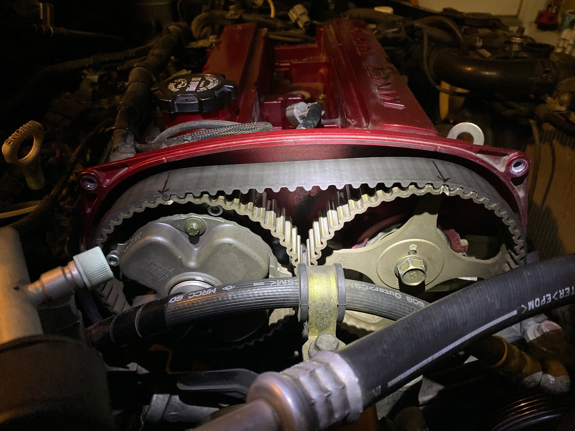

Took the timing belt cover off. (belt looks to be in decent condition no cracking)
Removed the Serpentine/accessory belt and fired up engine. Noise still remained so can rule out pullies for the alternator, steering pump, etc etc

thanks for the response hutch, so upon further investigation I have discovered that it is in fact the water pump (Partially) I took apart the cover and sprayed wd40 until it reached the bearing and the noise stopped so it was defiantly the water pump making the sound.... HOWEVER I'm still in for more fun. I'm starting to believe the head gasket is toast now due to the amount of oil consumption I've been seeing. Also it smells like burning oil. I would still like to confirm this if someone else has experience this before. The car is still under 70k miles, very surprised about the potential head gasket.

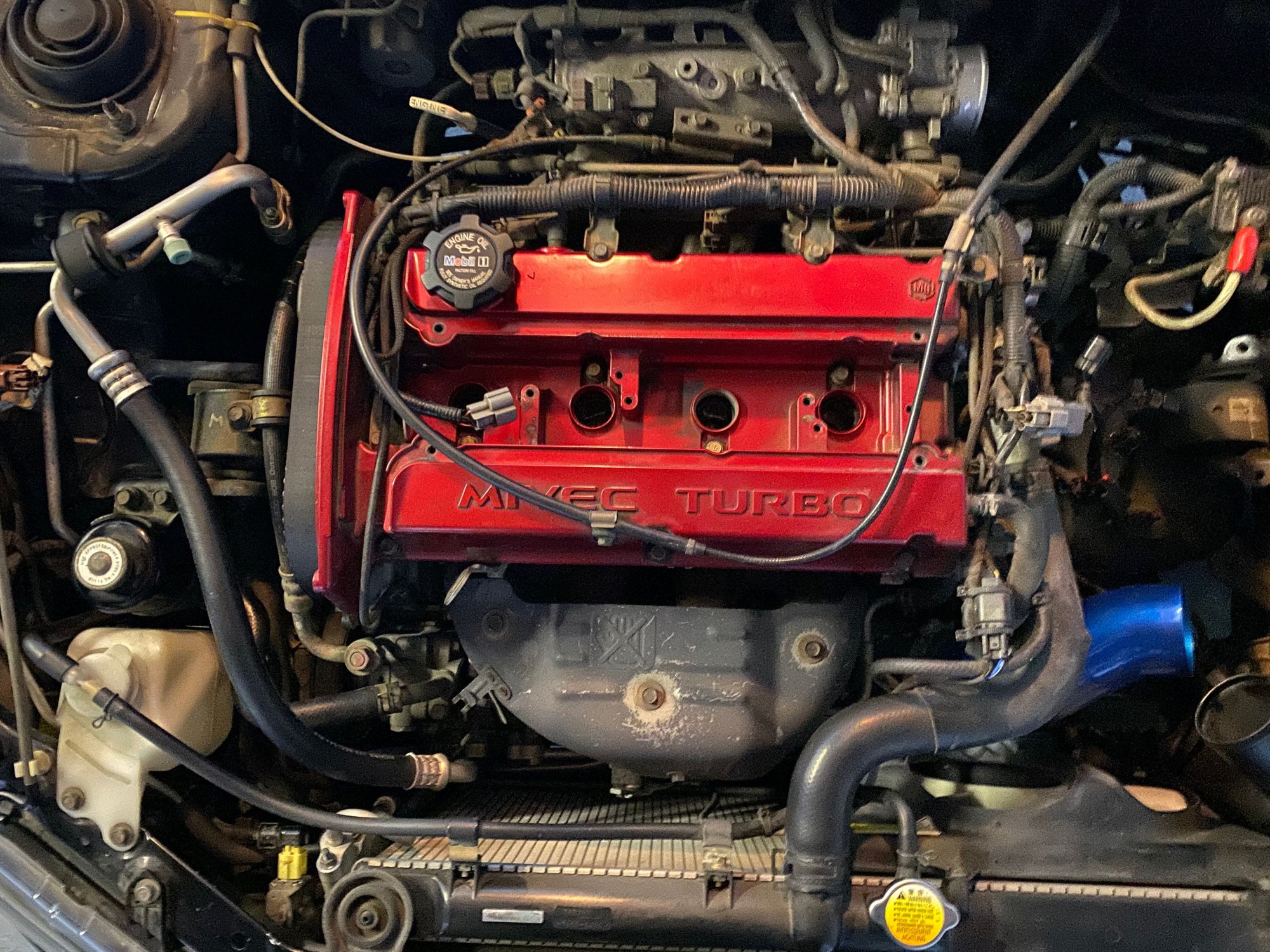

They vehicle may very well be a 2006 I will correct it. I just know it's a late model EVO IX SE. So I am currently tearing into the engine to replace the head gasket, thermostat, water pump, timing belt, and whatever else I find along the way. It may not be the water pump if it is run off of the serpentine belt as 2006EvoIXer stated, but I know it comes from the timing belt. When wd40 was applied the noise stopped within a few seconds. It is likely a dry bearing on one of the pullies, but if I'm going to tear into it I might as well replace the whole setup. I will post more pictures along the way, but so far coolant drained and a bunch of stuff removed a couple of the pullies on the passenger side are off as well. More pictures to follow, but waiting for blackfriday promos and parts lol. Thanks

Wait, why pull headgasket? I'd rather have a nicely seated headgasket over a newly installed one any day. It soulds like your timing belt tensioner pulley bearing needs grease, so only replace that if your timing belt is new. If timing belt is old, then do full timing belt replacement with tensioner pulley bearing replacement (may as well change idler pulley bearing at same time). Don't go crazy and replace everything. Lol
