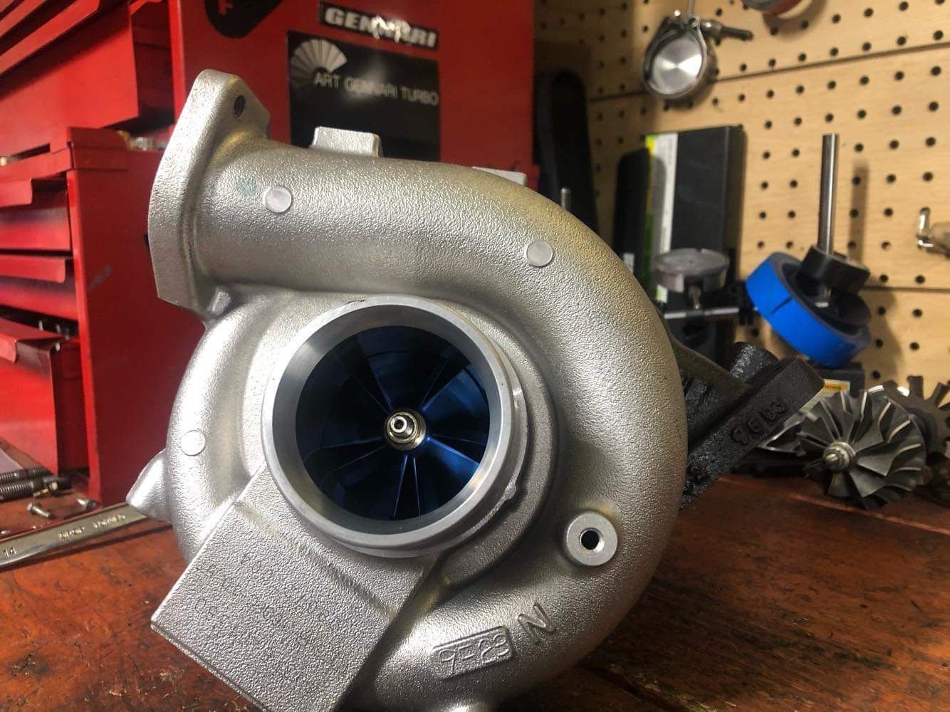

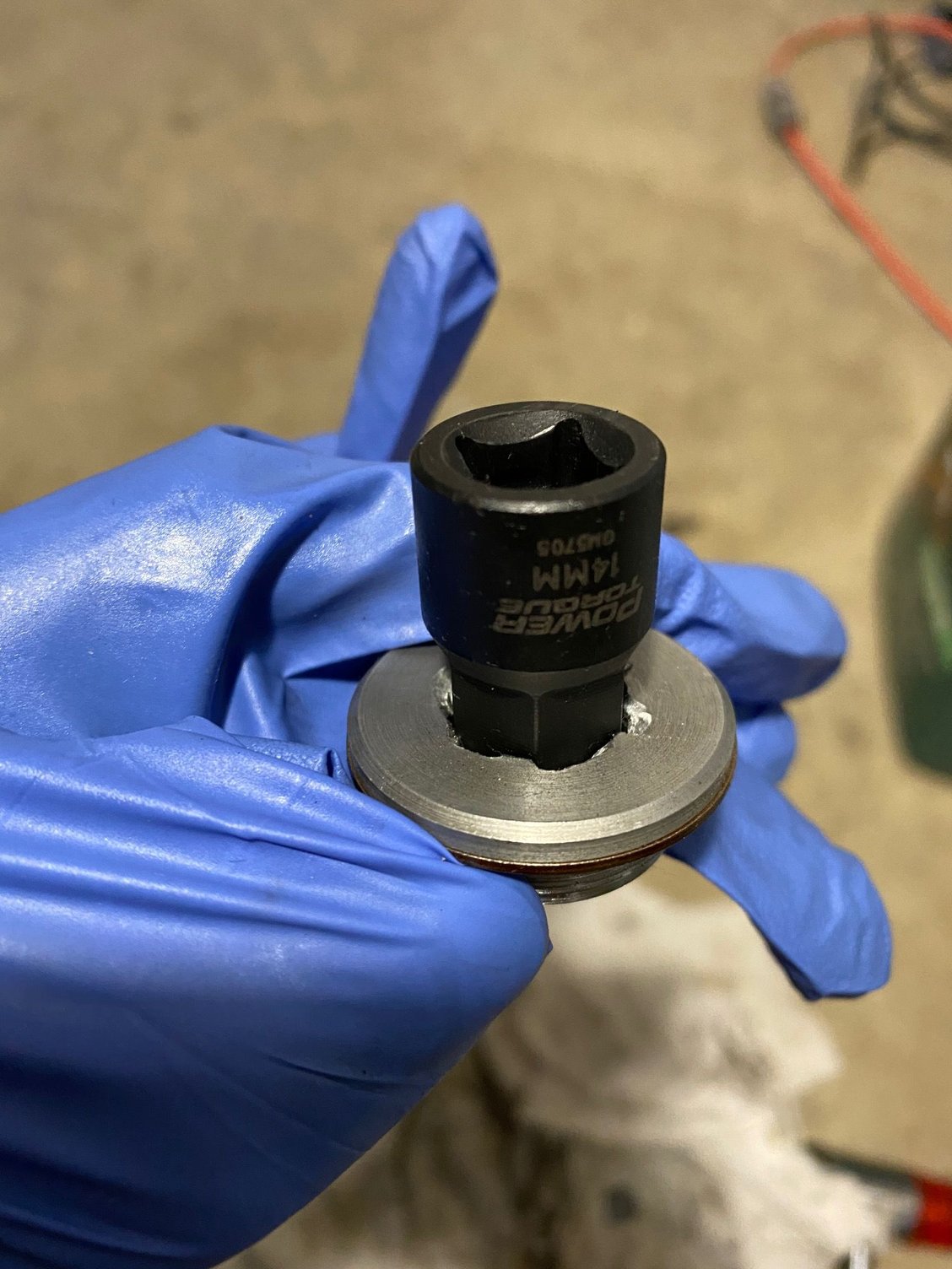

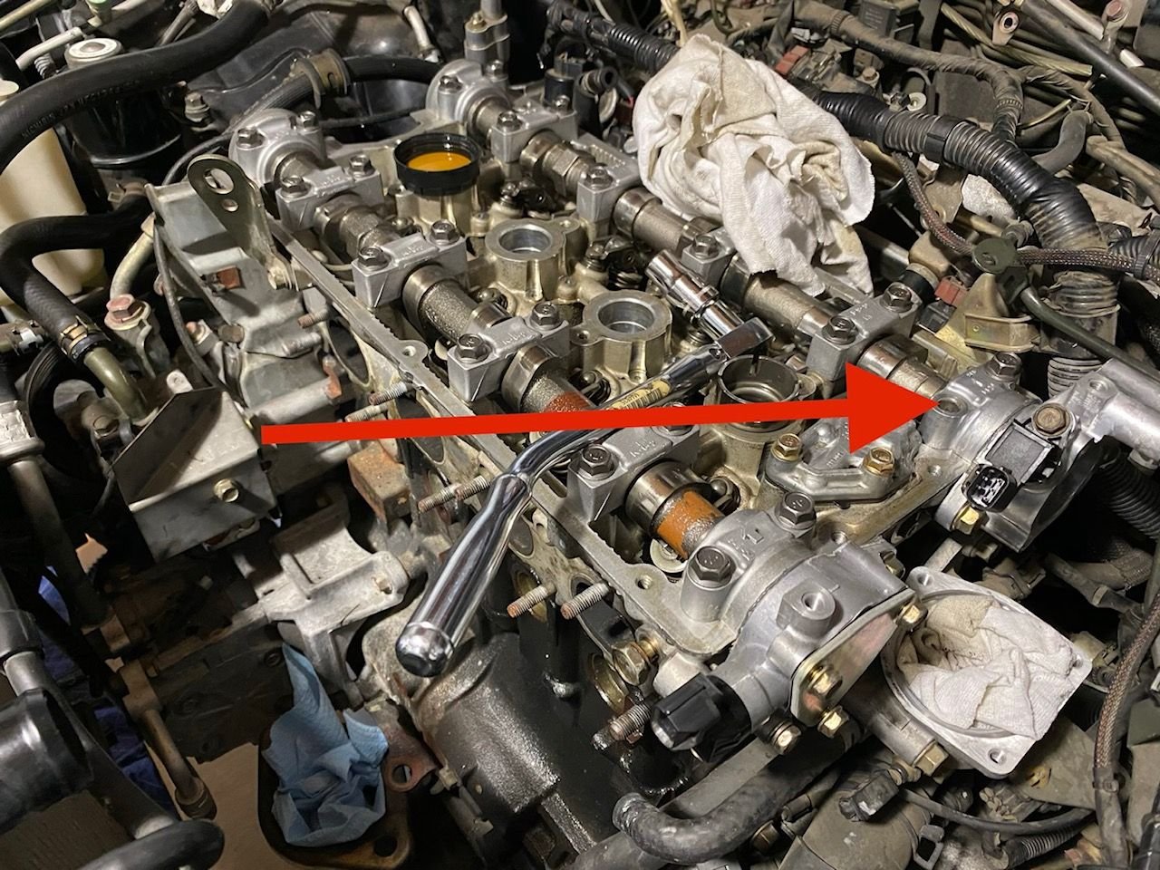

Been a long time since I've updated this, but turbo was completely rebuilt. I had a cam tower bolt what was damaged (ordered replacements) and needed new head bushings (ordered more replacements) on the intake side. The mivec camgear cover (intake) with the 14 or 17mm alan got stuck... ended up impacting through it to get the dang thing off and (ordered a new replacement). Then I was like what the hell might as well pull the injectors out and give those a clean so they came out and got a ultrasonic cleaner bath. SO finally with the turbo set to arrive in a week, I'm planning to put the car back together. Just been reviewing all the secret mitsubishi tricks for putting things back and finding all the places to add sealant etc etc. Heres some pictures of the voyage along the way.
Broken Cam Cover lol

The broken tower bolt mystery and pretensioning the new timing belt tensioner after I screwed it up
and finally the beautiful shiny rebuilt BBK turbo
