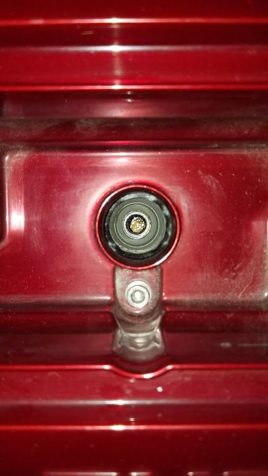

Just purchased an Evo 9 with an engine that was rebuilt by a local shop ~15k miles ago. Here's what I've observed:
  • On startup, smoke coming atmospheric catch can
  • Noticed some oil splatter from exhaust on cold start
  • Blows some black/blue/grey smoke under WOT
  • Puddling oil on top of piston after driving
  • Compression test results on cold engine 110, 110, 113, 103
  • Rich AFR on cold start, once engine is warm idle is ~14.7
  • Burns oil
  • Vacuum at idle is ~15 in/Hg at 4300' elevation
  • Tuned on speed density
  • Dyno'd @ 350 whp ~12 months ago
Rings? Valve seals? Glazed cylinder walls? What could be causing oil to pool on top of piston like that? See attached picture.
Thanks for any help/advice!

Do a leakdown test.

Hopefully, it's the valve seals and not piston rings.
Old Feb 21, 2020 | 02:39 PM
LetsGetThisDone's Avatar
Joined: Oct 2013
Posts: 15,973
Likes: 1,629
It's rings. Valve seals don't cause low compression. Time for a refresh.
Define rich on cold start? Its typical for stock ECU speed density to cold start in the 11.0-12.0 range to make it run ok. It doesn't hurt anything.
The AFR gauge will sit at 10.0 (the lowest it'll read) sometimes bouncing up to 11. On a built motor with forged internals could the tolerance be a littler looser in anticipation of making more power? In that case, might my compression test be ok? I'm going to perform a leak down test once I can get my hands on the requisite tools

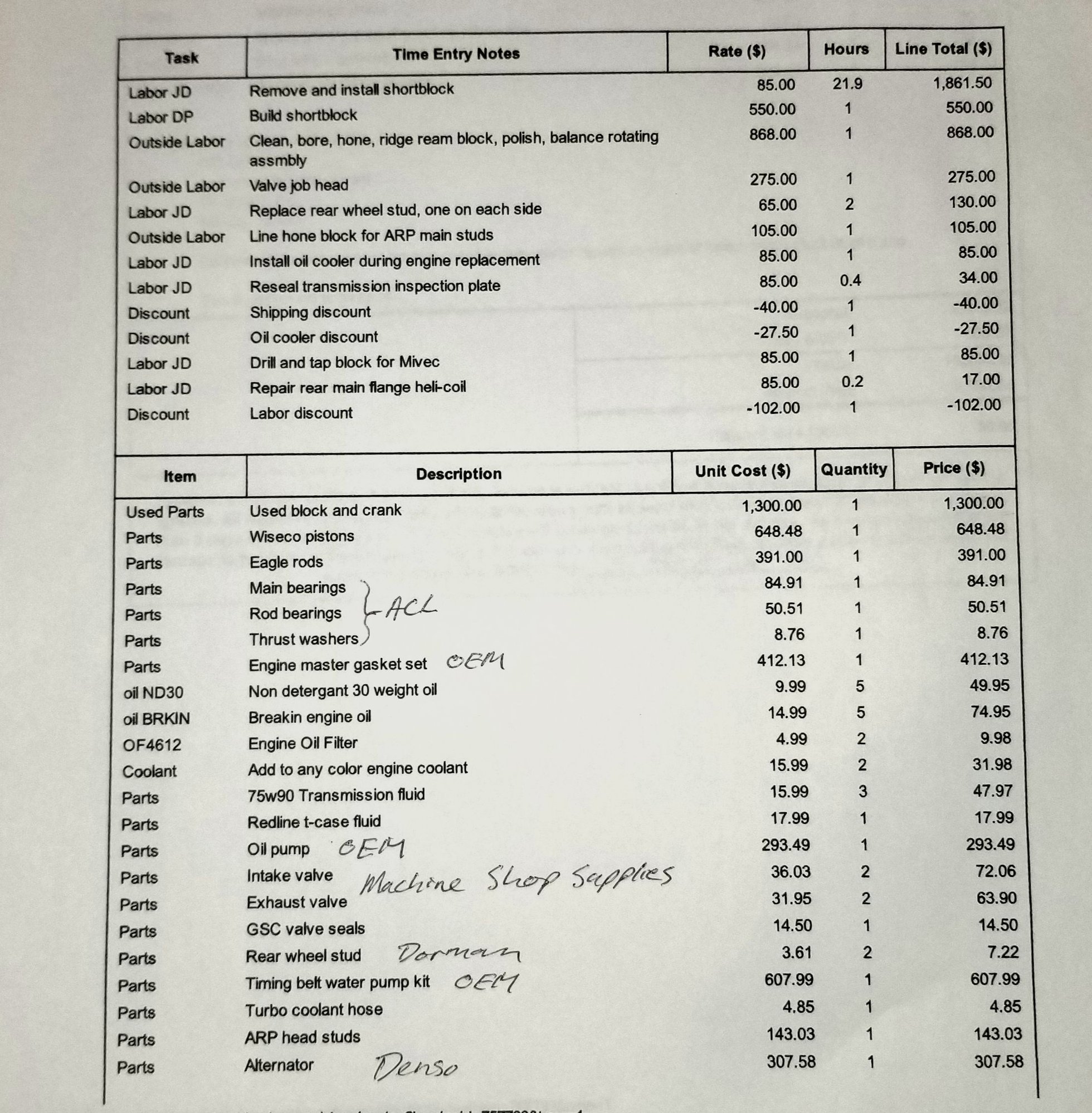

Originally Posted by Pal215
- What was the reason for the rebuild?
-What kind of cams are in that engine?
-Was the cylinder head rebuilt too or just the shortblock?
- Previous owner said the original engine threw a rod, a used block was acquired and overbored .020
- I should know that, but I don't. How could I find out? [EDIT: Cams are stock, texted previous owner]
- I've attached a picture of the build receipt that details the work done prior to purchase

Originally Posted by MIVEC_IX
Also... how can an engine built 15k miles ago already require a rebuild? Improper assembly? Improper break in?
It's not break in. The best way to break in an engine is moderate boost levels with lots of vacuum pulls. You want to take advantage of the fresh crosshatching on the cylinder walls while you can to sand the piston rings into the cylinder wall for a better seal.
I was hoping they weren't stock cams because there are some cams that cause low compression readings naturally. Your currently tested compression is too low, but compression isn't the real problem. The real problem is that the oil you are burning will lower your fuels octane rating and cause unpredictable knock, which could blow your motor again.
To answer your question though, this is caused by either parts failure or improper assembly. I wouldn't go back to the shop who built it either because they or their machine shop is doing something wrong. There are a lot of places to make mistakes when assembling 4G6x's. If the piston to wall clearance, ring gaps, and cylinder health (bore, crosshatching, ovaling, tapper) were all within spec, then your engine would not burn oil. If your cylinder head is straight, valves, valve guides, and valve stem seals are good, then the shortblock needs a rebuild.
Also it looks like they probably gave you an evo 8 block since the receipt says "drill and tap for mivec." Nothing wrong with that part if done right.
