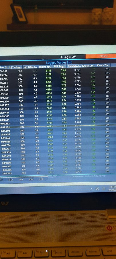

If u open the log u can see everything...but ill post the knock graph as some dont have the link software installed
Or you can just export as a .csv file

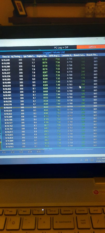

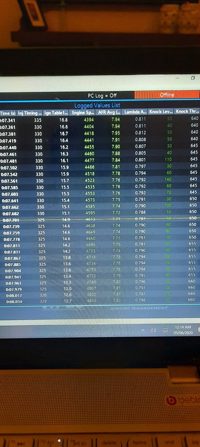

maybe the ECU was pulling timing? I didn't see a graph of knock.

It's hard to say because your datalog doesn't make sense. If it really is 60psi of boost, that is 100% insanely aggressive on E85, it doesn't have the octane for that. So, if thats true tune could be an issue. Especially with 8* of timing, that timing is slow it could be causing mini misfires on ethanol. But 60psi doesn't make sense for 780whp.
Datalog makes sense because it is reading absolute pressure, which means atmospheric pressure is ~100kpa. Therefore, looks like he is running ~46psi of boost.
Kpa to psi converter on google said 60psi.
Actually pressure makes more sense. Timing is still way low. Like about half.

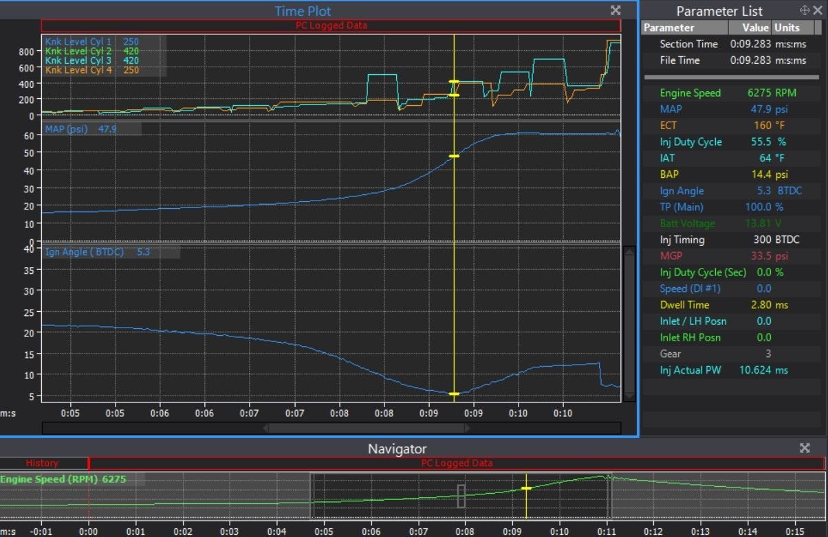

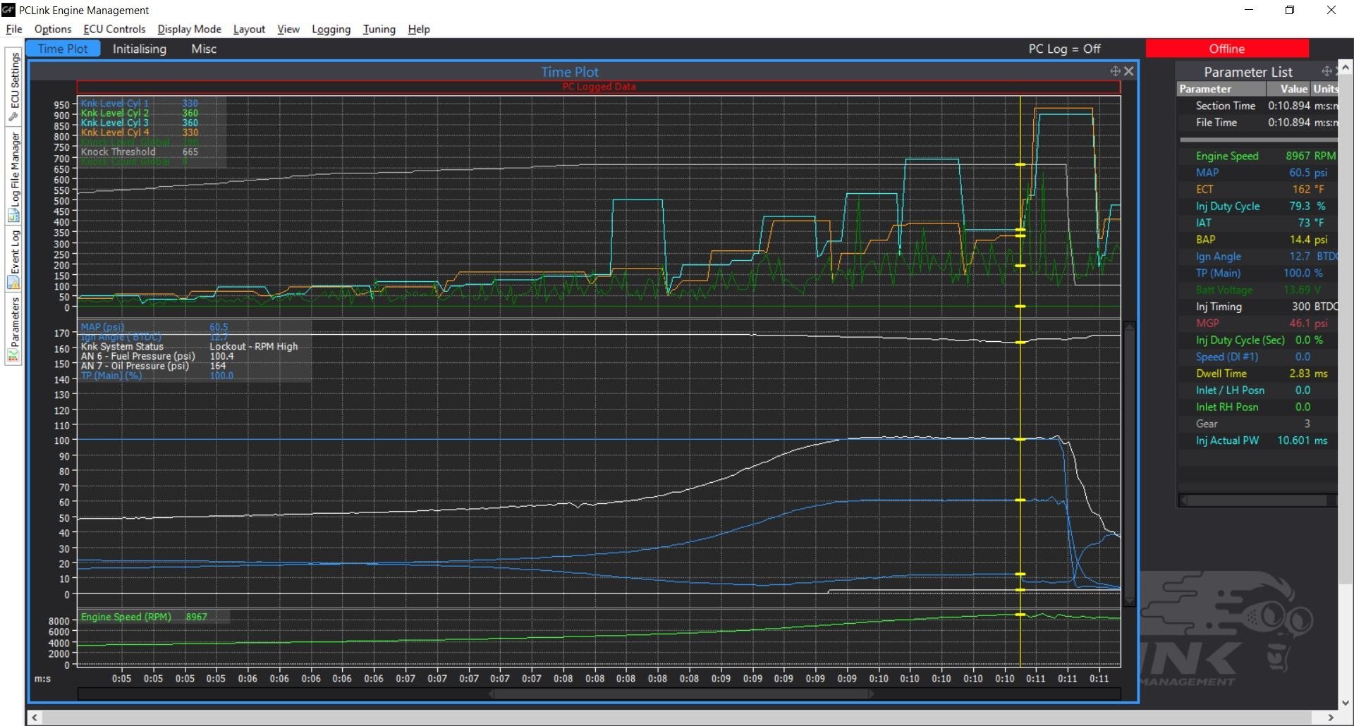

Not sure what those knock values equate to, but probably a bad trend the way it climbs. Still trying to figure out why I have this software on my laptop.

I was bored so I tried to figure out what is happening, but definitely something not good occurred at the end of the run and where I have the yellow marker. Also, I searched your inputs for the raw knock sensor voltage, but was unable to find it so perhaps you can let me know what parameter that is and I can pull up on the log. Would need to see the dyno curve, but your peak torque timing occurs about 1K RPM prior to full boost, which may or may not be correct. Before the end of the run the ECU yanks ~5deg of timing based on what appears to be excessive knock, but unclear because I don't know how the knock parameters were setup. Boost starts to break up and then the knock levels go crazy. The problem with the knock sensor parameters is that almost no tuners take the time to set these up because it is a PIA and does take some time. Also, there is a high rpm lockout on the knock sensor status at 7K RPM, whatever that does.
