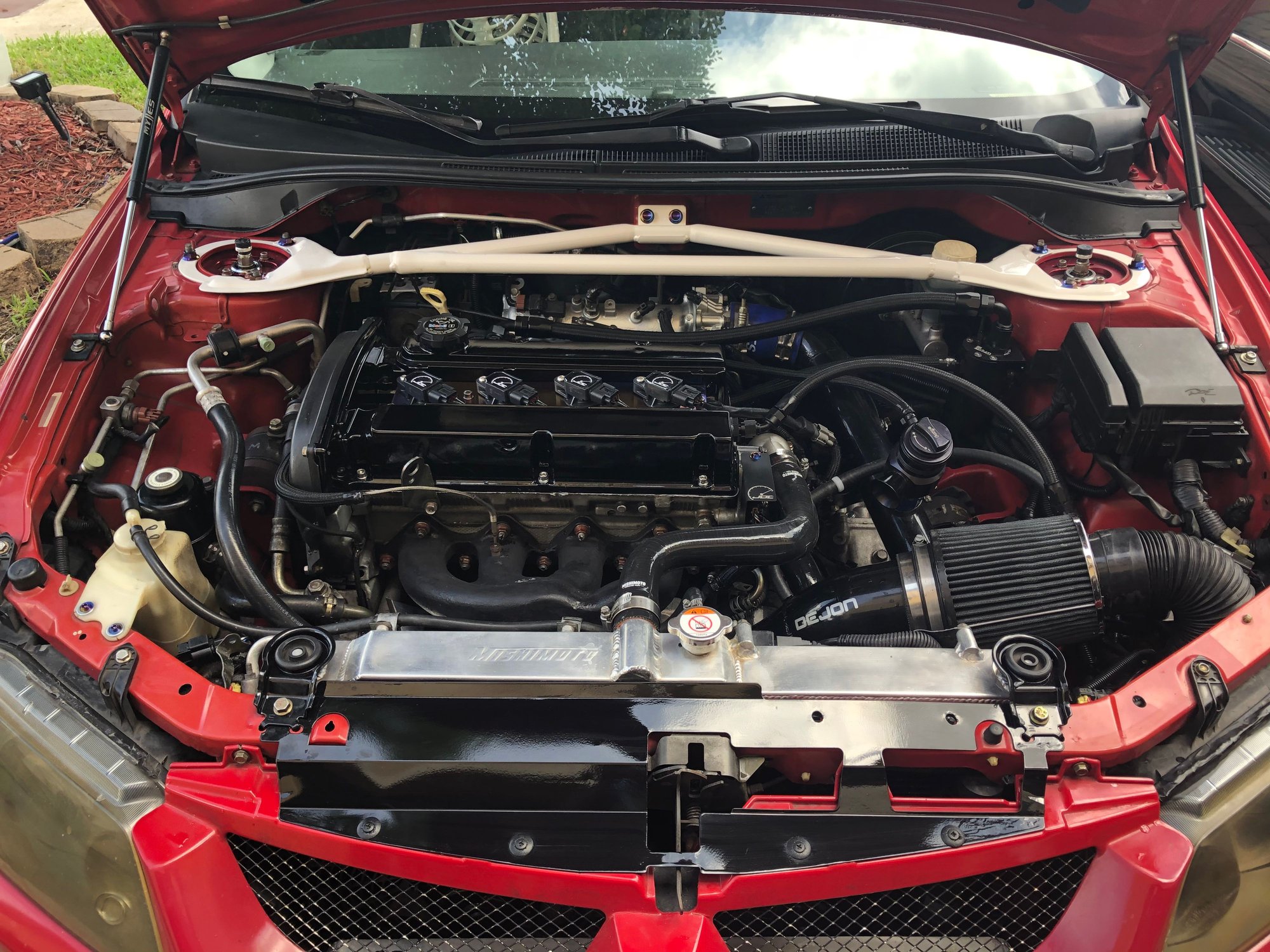

So I’ve been missing for a few years and neglected the Evo by letting her sit for over 2 years, no start nothing. I just recently pieced it back together and have determined that I need to replace the head gasket. While the head is off I may as well upgrade the head and I am leaning towards Head games. Any good reviews from them and what about turn around time. I plan on going with their 400-700 whp package. Any suggestions on what to tweak or just leave it ax is?
