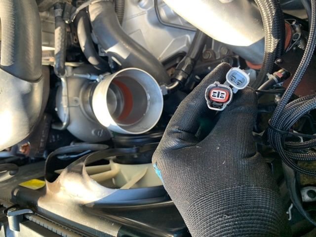

Post pictures of the plug

Letgetthisdone, I’ll take a picture of the plug this evening but I don’t think there’s much of interest there.

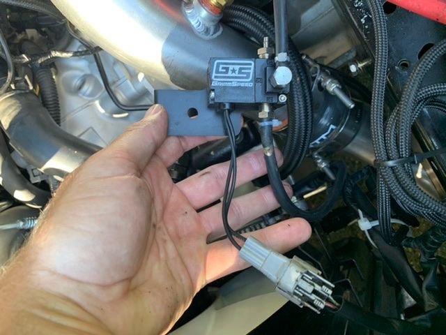

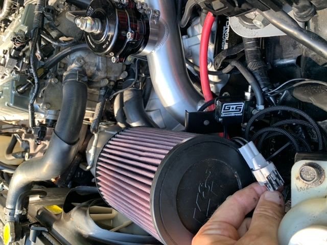

not sure if there’s much to make of this, but regardless I appreciate your help Letsgetthisdone.
