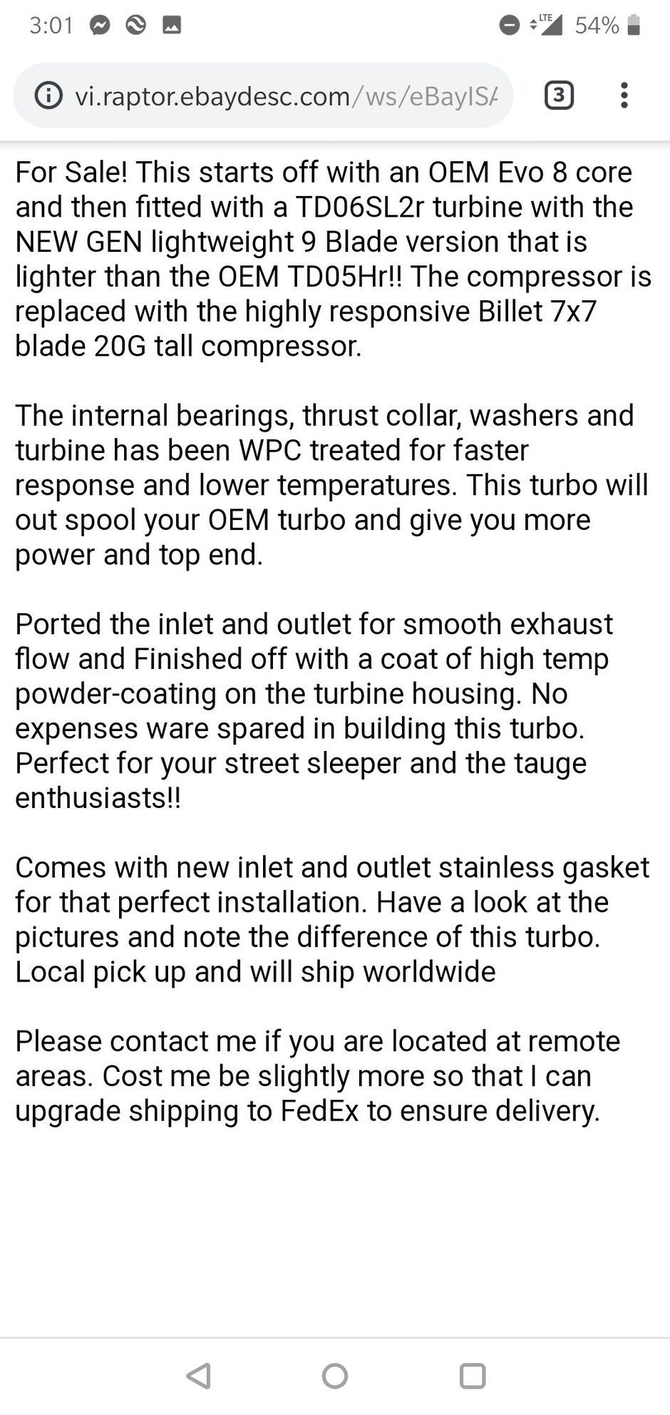

Who manufacturer the turbo?
TTE Performance?
Speed Spin Turbo?

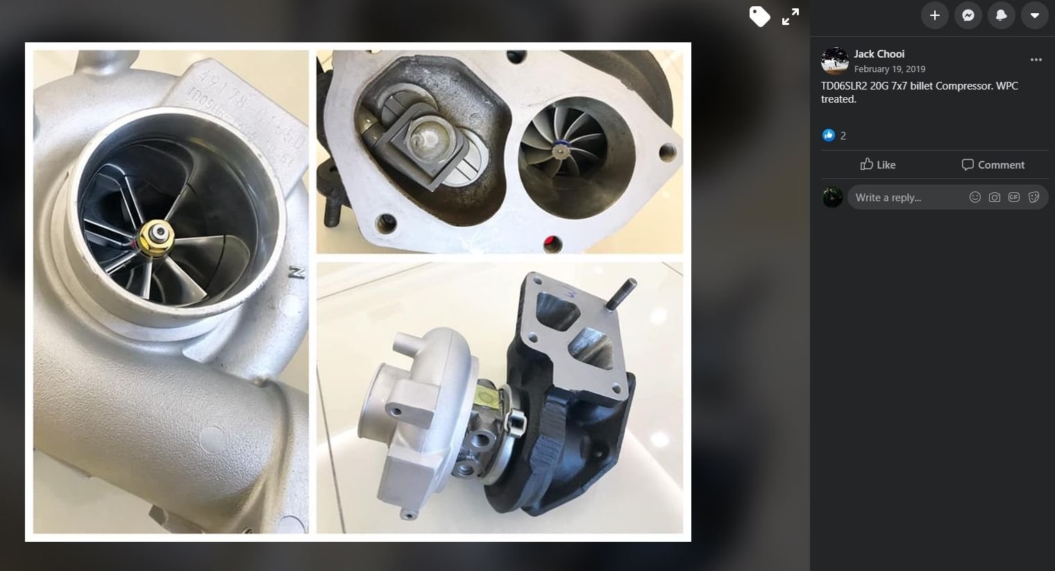

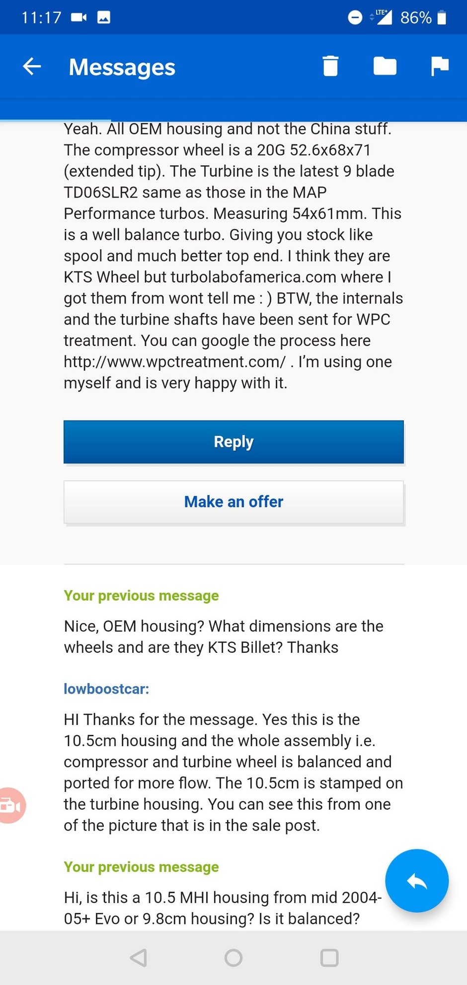

Actually unsure. I'll do some more research. Guy was based in Kuala Lumpur. eBay link is 100% dead but found this old ad in a Facebook Group + screenshots in my Email

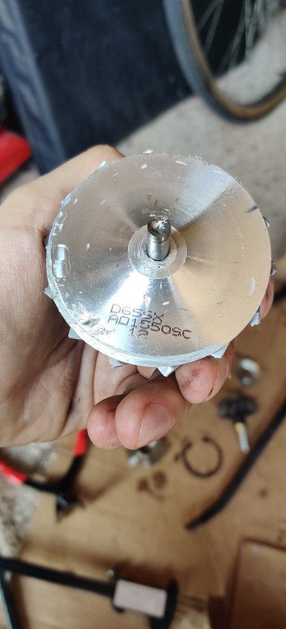

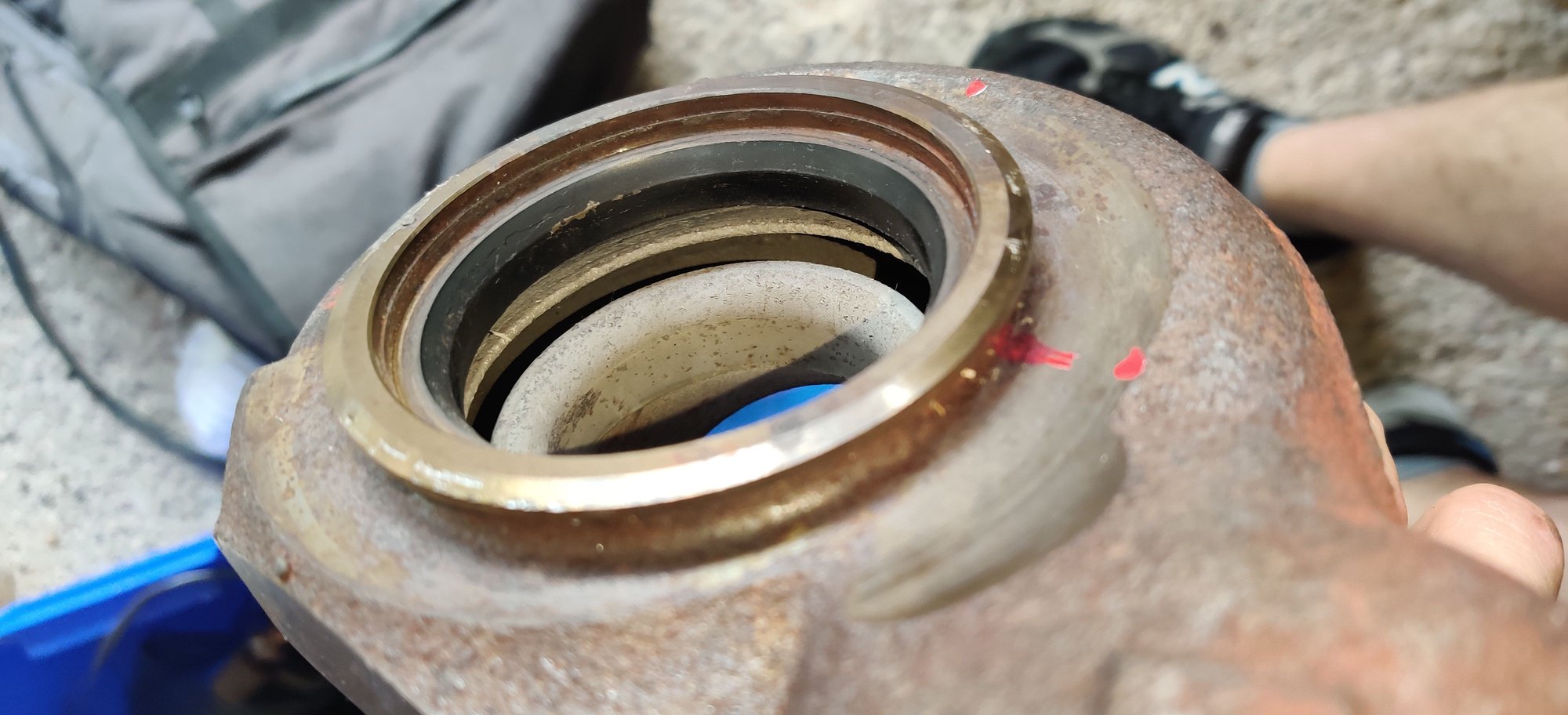

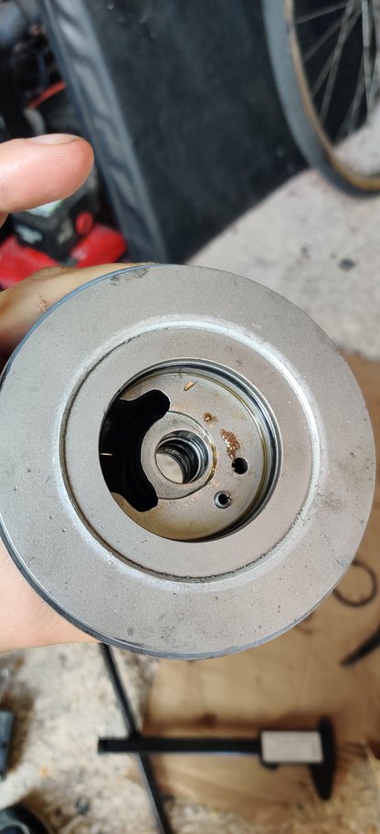

Thought I'd share some more carnage pics. Used two prybars to pop the turbo wheels off. Still tempted to just jam a inspection camera into the pan and check it that way. I drove the car for like 3/4 miles after the compressor nut broke off thinking that I just had a boost leak so I have a feeling the worst case scenario already happened.
Next turbo likely gonna be a FP54 or MHI 18K, have a feeling FP is gonna say both my housings are trash (this one has a chip, Evo 9 spare I bought has a burnt white volute due to high EGTs by PO) so may have to do a 18K. Gonna try Blouch too.

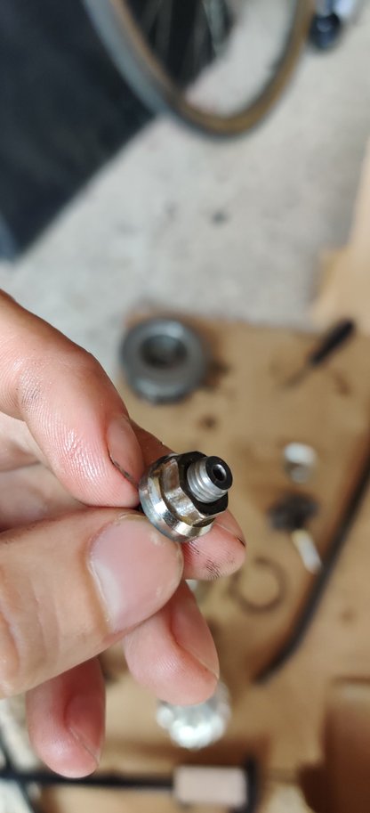

Compressor nut was balanced by grind marks pictured
Compressor is a KTS D656X, measured a little under 71mm and 52mm.

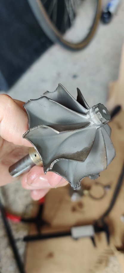

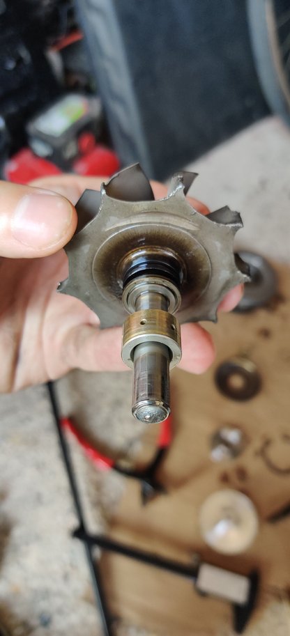

Turbine shows grind marks on the back from balancing, bearing did not look too bad. Measured a little under 61mm and 54mm

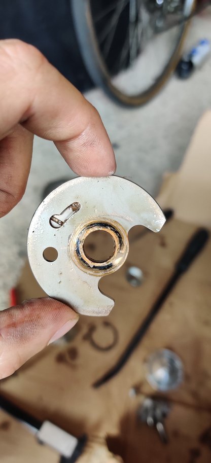

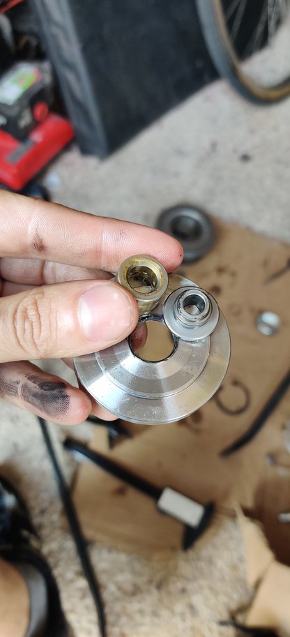

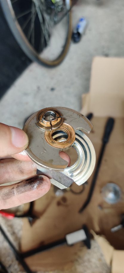

Bearing material from the thrust plate there
Thrust plate
No idea what the washer is that's cracked, that cover place is "opened up" like the shaft was grinding away at it.
Bearing doesn't look too bad either.
Turbine was balanced at some point after assembly.

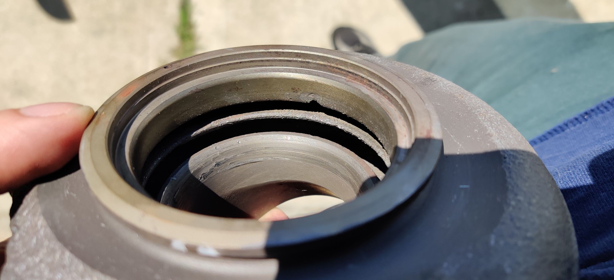

See chip and grind marks, this was from the turbo that failed with 54/61mm turbine. It's a coated and ported 10.5 MHI Evo 6 housing.
This is a Evo 9 Housing, had a stock turbine in it.
