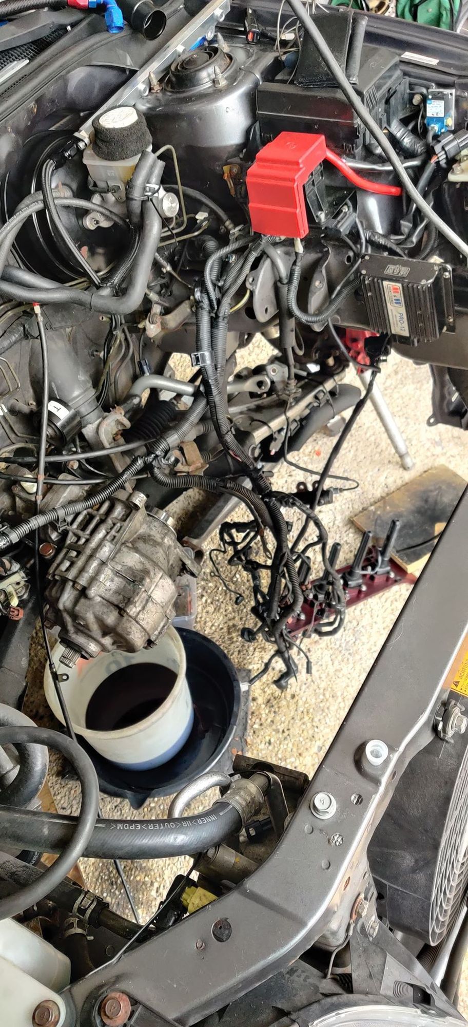

The engine was out of the car a week later, first time dropping a Evo engine entirely solo. Transfer case put up a fight coming out. Kinda just dropped it onto a handtruck then lifted the car over it.
Separated the throwout bearing and used a big prybar to separate the engine/trans. Wasn't that bad but not gonna lie, didn't feel too confident with my head/face under the engine dolly (had the easiest time separating the TOB from the access hole on the bottom of the trans closest to starter). Finished stripping it entirely and made sure to dress it for its trip to the machine shop.
