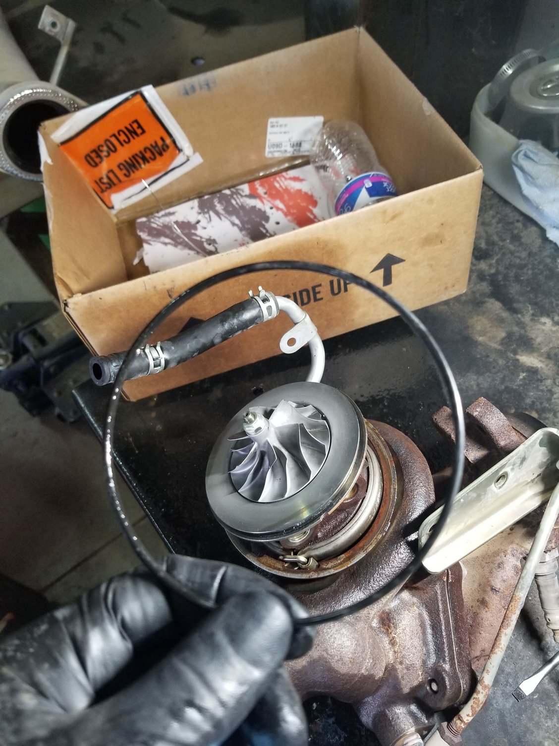

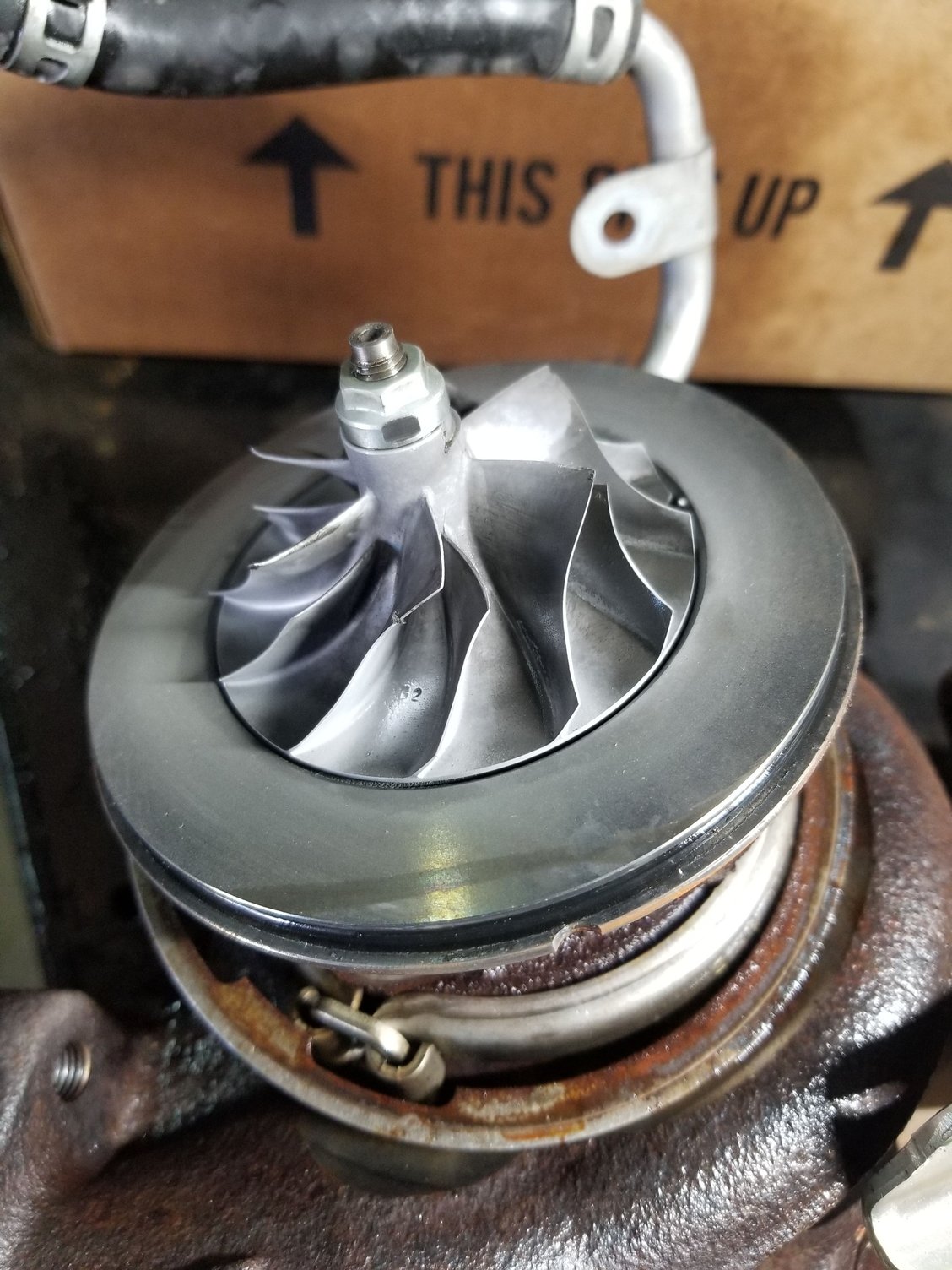

Quick update, i worked on my car today and removed the turbo assembly. I can confirm that there is an o-ring on the center section that seals the compressor cover. The o-ring was very brittle and cracked as soon as i tried to remove it. I am 100% sure that was the source of my boost leak.
I am going to try and source an O-ring locally first to try and get it fixed this week. I will update later when its fixed.

Wanted to update this thread as fixed/ solved. I was able to source an o-ring at a local hydraulic hose maker for all of 1 dollar. It was literally a 1 dollar repair haha. All of my bolts/nuts came off easy so i just went back together with some anti-seize. Boost leak test held good to 30psi.
