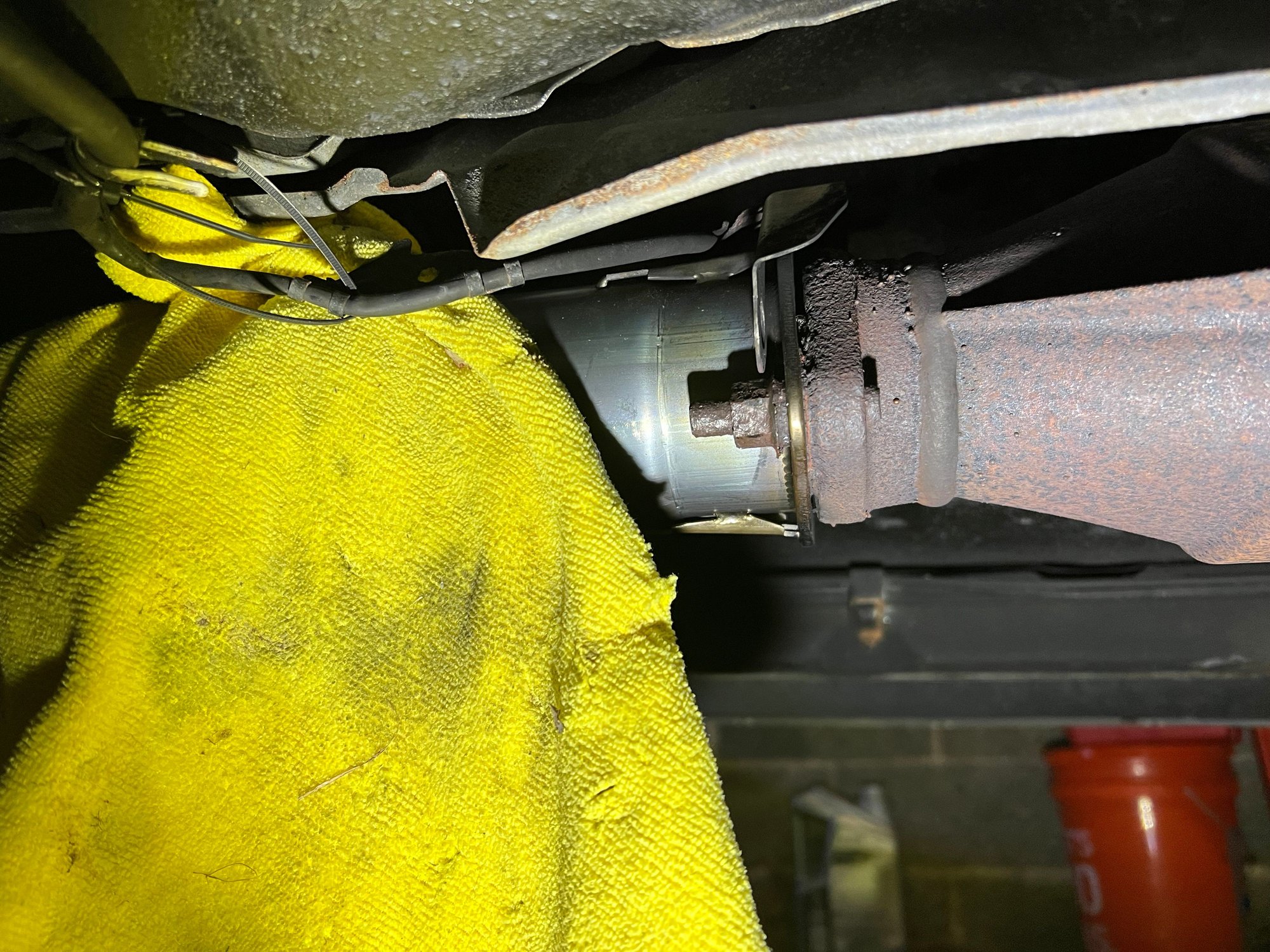

My exhaust gasket is shot so I'm trying to remove the midpipe to cat bolts, but having no luck... I'm trying to use a M12 stubby impact which has 250 ft/lbs of torque, so it might not be enough...
I've never used a torch, but my thought was to get a MAPP torch and heat up the bolt on the cat side and try to have the nut and bolt came out as one piece. Would this even work? Or should I heat up the nut on the midpipe side to get the nut off and then remove the bolt some other way?
Do I need to worry about the torch with my Greddy Ti? Years ago I saw someone selling a Greddy Ti with a cracked flange with the claim that an exhaust shop used a torch on it and it broke off...

Hit it with PB blaster every 2 hours for 24 hours. Try impact. If failure then torch it. Try impact. Failure again... time to cut.
I got so sick of all this, I replaced the four bolts for the CAT with TITANIUM hardware. Copper anti-seize wasn't doing the trick for me after a winter or two.

What’s the best way to cut it?
I have a hackzall with a 5 inch metal blade, but there is no way for me to rest the shoe on anything, so it seems too dangerous…
After I cut the bolt, how do I remove the bolt from the cat side? Can it just be hammered out or would it need to be drilled?

THIS will do it
Old Oct 16, 2022 | 07:15 PM
Jaraxle's Avatar
Joined: Mar 2012
Posts: 1,186
Likes: 261
From: New York
WEAR SAFEY GLASSES !!!!!
I had one of these wheels EXPODE once and it hit my safety glasses... I would be OL'ONE EYE if wasn't wearing them..

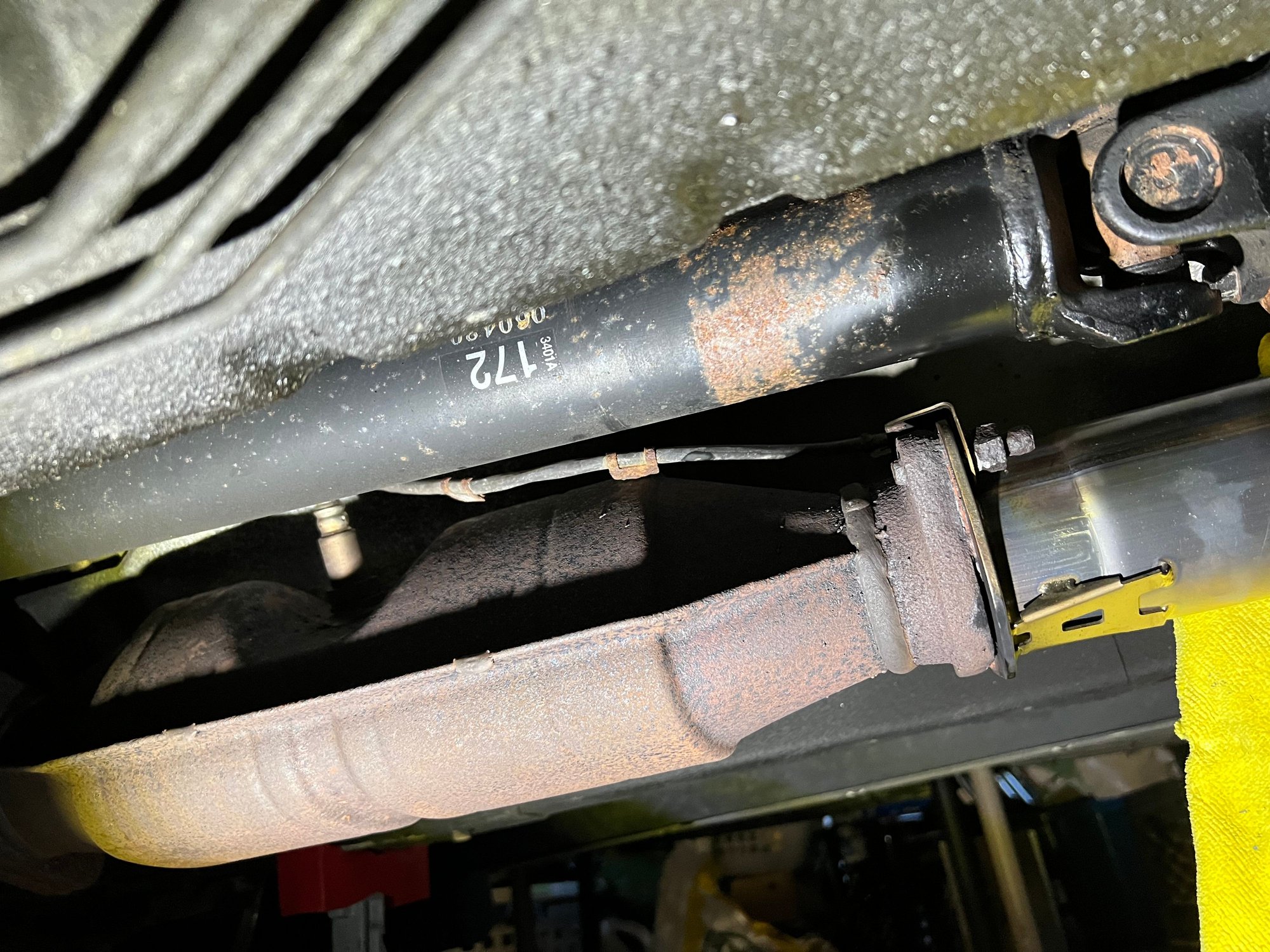

I dunno about cutting the studs out of the cat. Properly replacing them could be a huge PITA.
You try hitting it with penetrating oil? Sometimes when things are stuck, tightening it just a tiny bit can help break it free.
If that fails, bring the heat.
EDIT:
I see they are caked in rust. Some naval jelly or other rust dissolver will probably be really helpful.

^^^Good point. Kinda forgot the CAT has a permanent, pressed stud vs nut & bolt?

Nut breaker/splitter, but there seem to be room to hammer a wrench there

its a more expensive tool, but a magnetic heat induction gun is a great tool to add to a collection. I have a bolt buster, it works amazing whenever you can get to an area on the nut/thread side.

I sell the induction heating tools if you want one lol, but I would try heating it up with a torch and quench it with pb blaster. You may need to repeat it a few times but I haven't found one that wont come off with that method.

That needs a gas axe. No saving it.

That was my thought... There are NO THREADS visible anymore, and it is a rusted solid unit. Cutting it is the only way out.
