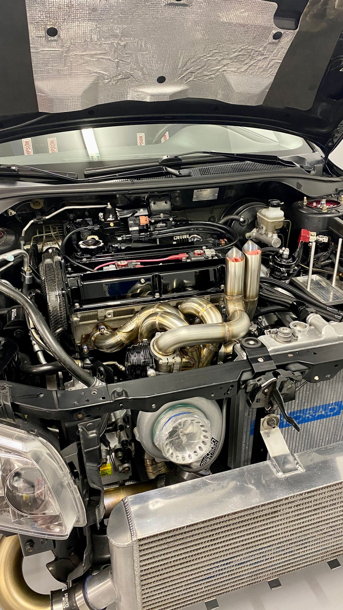

From: Virginia
I’m wrapping up a full build on my car and ended up switching turbos after it was complete 😂. The car had an FP Black and I ordered an ETS 6870 in a T4 TS 1.15 A/R. It was between the 6466/6870. A day later I rode in a 900+WHP Evo X with a 6870 and my mind made was made right then and there 😂.
