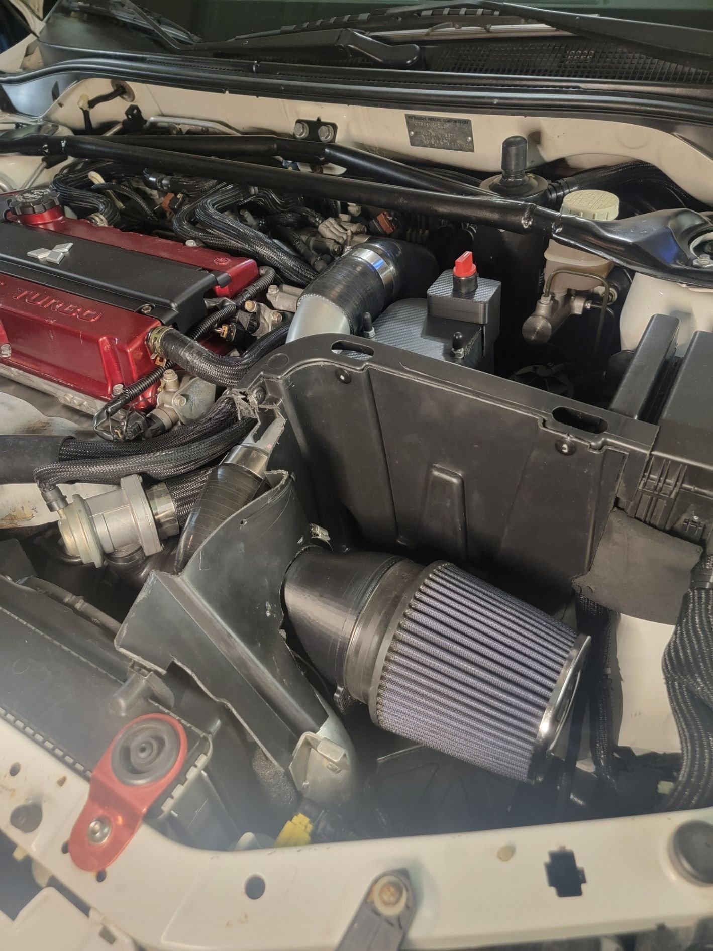

It fits just fine! Here is a pic of the test fitment using my kids play-dough to see if it hits the hood... which it cleared (play-dough remained turd shaped after closing hood)....
This is the best measurement method I have ever heard of! I don't have kids but I used my dog's turd instead and it fits perfectly! Thanks!
