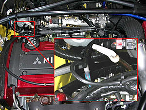

I installed my T fitting according to this boost gauge install write up. Here is the picture from the website..... I have seen it installed on the next hose over too.....Perhaps I just need to move the location and it restricting vacuum there is normal?

I think I might just run it to one of the lines actually going to the BOV....that would be a more useful and accurate reading I think, but still at the location its currently in....is there any reason why there would be no form of pressure or vacuum coming out of it....even after driving alittle?

Mine is in that location and works perfectly.
