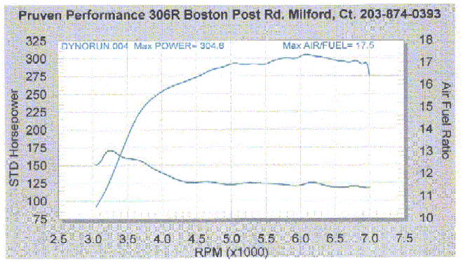

First of all here is the original dyno sheet of the guy who later switched to the HKS intake
His a/f is hovering about 11.2 - 11.3 / 1 - this is how his car left Pruven with the Dyno Flash custom tune

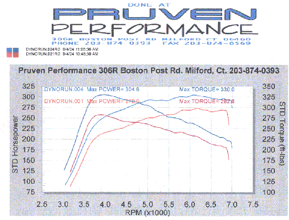

Here is his before and after whp and tq sheets

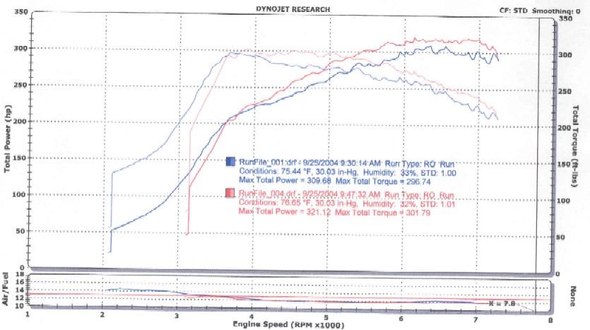

Apparently this is what proports to be his initial dyno pull at Turbo Tricks after he changed his intake for the HKS RS KIT - blue line and - the red line after the Turbo Tricks tune
The figures from the blue line are meaningless as when you change intakes the custom tune is no longer accurate. The main point is that the top dyno sheet is how the a/f looked when it left Pruven

Whats the smoothness factor on both of those different dynoes?? That will make a difference right there. THe graph itself looks pretty accurate if you ask me.

I am sorry I wont be involved but I know that TT is using smooth factor 0 , enough SAID..

As I was saying last night before they closed the thread. Take a look at how smooth the dynoflash power is compared to the heartrate looking TT flash. Again just my opinion...
1. Safty
2. Smoothness
3. Power
that should be the tuners priority list.

TT is using a smoothing factor of 0 and im willing to bet Pruven is using a smoothing factor of 5. If you have seen the difference when adding smoothing you would know the huge difference it will make
1. Safty
2. Smoothness
3. Power
The hearate graph your looking at ... the lower HP one is a dynoflash graph.
My list is ..
1. Customer service
2. Safety
3. Power ...

no bashing at all just saying what I observe, to discuss what ya'll have to say about what I'm seeing.
but also the dynoflash graph does not include the HKS RS intake, does it?
