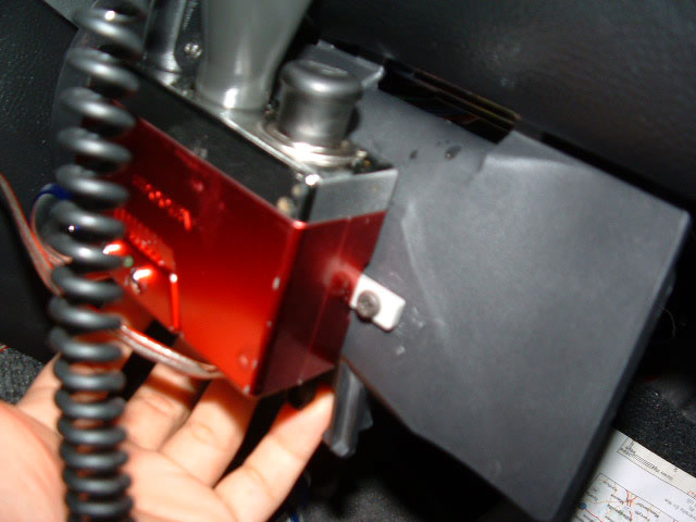

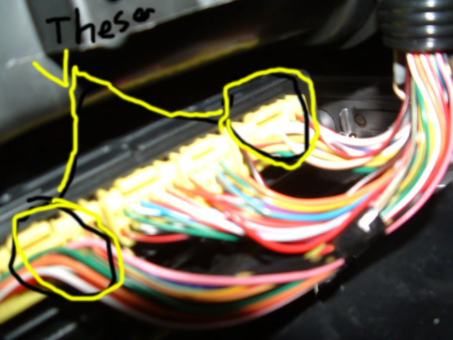

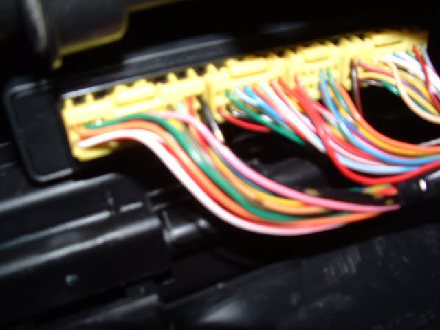

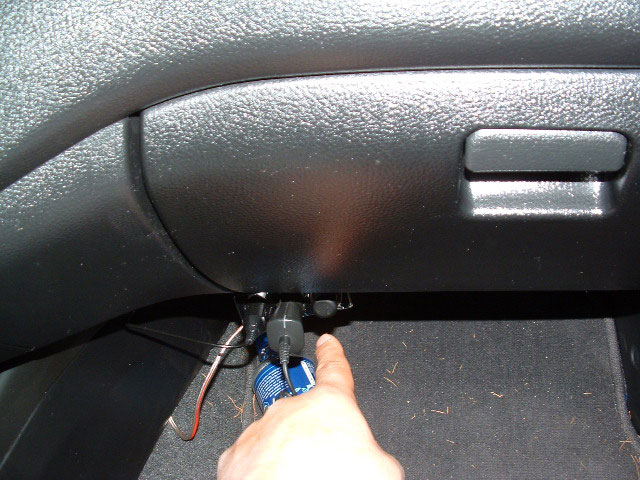

How to Reset your ECU without disconnecting your battery or even getting out of the car.
1 Locate the ECU Cover
2 Remove it the cover carefully from the engine side clips.
3. You'll see 4 yellow plugs.
4. disconnect the ones on the side of it for 5 to 10 seconds.
5. start the car, let it idle for 5 minutes or so
6. turn the car off, turn it on again, let it idle for 5 minutes before you drive.
7. Enjoy your warmth and the joy of killing the cel light. That and you don't loose your radio stations.
ps. don't mine the red thing, it's my multi power plug mounted on the ecu cover.
