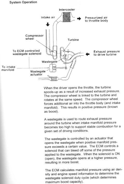

Attached Thumbnails here are the pics of the official tech training book-turbo.gif

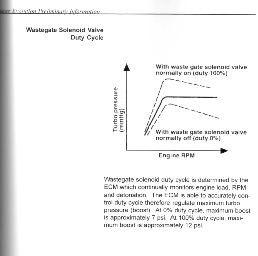

20 lbs of boost....where did he get that????
Attached Thumbnails here are the pics of the official tech training book-psi.gif

Hmm, 12 psi seems a little low. Thought the VII had like 18 or something.(?)

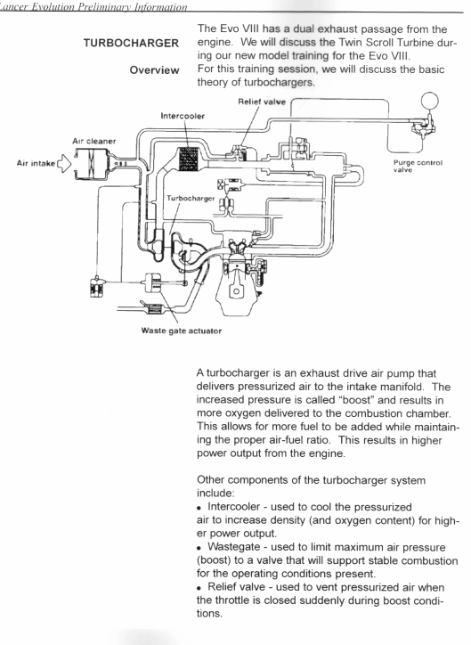

Attached Thumbnails here are the pics of the official tech training book-turbocharger.gif

Attached Thumbnails here are the pics of the official tech training book-system.gif
