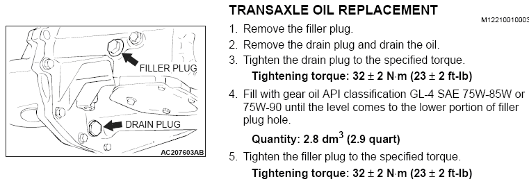

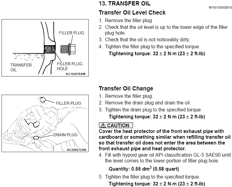

OK, I just had an transmision oil changed - i took about 20 min and 3 qts of oil.
Now
I also had a transfer oil changed (transfer case I understand) and it only took less than half a quart???
Is that what it should be?
I used the same oil - as mitsu recomended - is that ok though????
Please answer these questions for me
Seems like everybody says (including mitsu service) that I need 6 qts for it all
Where did they take that number from?
Do they mean front and rear diff - wchich is not recomended to change until like 60000 miles?
Thank you

In the How-To write-up on this, it says the transfer case and rear diff each require 0.58 qts. I'm pretty sure that's how much it takes.
Old Dec 10, 2004 | 12:29 PM
RallyRedEVO's Avatar
Posts: 450
From: iNt3rNeTs
That appears to be correct. Sorry I told you too much, at least you had enough!
I used the same exact thing in my tranny / front and rear diffs. Others have done the same, so you should be OK.
