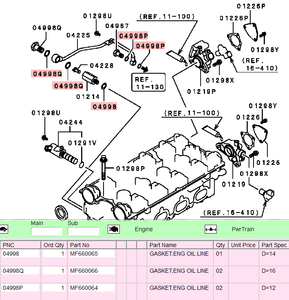

part numbers for the copper crush washers on the banjo bolts for the MIVEC line on an EVO IX????
Is this the MIVEC oil feed line? If so then this should help.
YUUUSSSSSS, finally, thank you!
