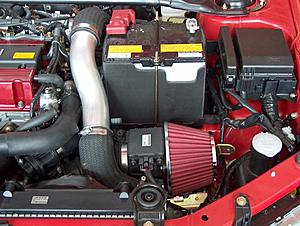

Ok I'm either going to go with a K&N drop in filter or an open intake filter from Buschur. My car is completly stock and I don't have any plans for any other mods anytime soon. So which one would you go with?????? I kind of want to hear the BOV more so I was thinking the open filter. But with the open filter do you think I'll mess up my ecu????? Also I'm on a tight budget.
Hers the open filter pic

K&N drop in works great and doesn't mess up your MAF signal. I have seen it make 7whp on my stock Evo.The Buschur would be Ok but without tuning I would not put in on your car as well as the K&N typhoon or HKS just about any intake systems just mess with it to much if your not going to get tuned for it.

Open element intakes have been known to upsect the ecu by causing turbulence through the maf sensor. Sputtering and stalling have been some of the complaints. Though these things can be addressed through thorough engine tuning. I would start with exhaust upgrades, since much of the evo's power is due to the turbo and the energy derived from the exhaust gases. Although engine tuning will give better results with an exhaust, nonetheless a 3" turboback exhaust will yeild better results than any intake. Exhaust parts are more expensive than intake though.
