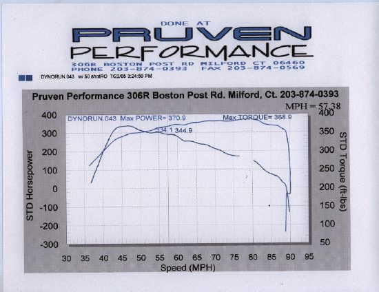

This dyno sheet is impressive and shows the decent power up top with no loss in tq over stock
While the Essex Turbo dual ball bearing TME did make more low end tq - it also does cost a boat load more money - - and the top end power was the same
370 whp in 90 plus degree heat is very good

Very good points Al, I am glad to see your voice of reason speaking out on this subject. This turbocharger does a good job at what is was intended to do - give some extra power over what is possible with the stock turbo. It was never part of the design criteria for the unit to get into the 450whp range. The turbo was intended to approach 400whp on race gas, the 441whp from Switzer is about 10% outside of the intended power output for the unit. There always seem to be outlying data points for any data that is collected.
Your 370ish whp in 95+F heat is a very fair representation of what to expect from this turbocharger.

See above dyno sheet - I see gains of 25 - 35 whp at 7,000 plus rpms easily obtainable
In the case of a stock turbo Stage 4 the whp would be about 340 in that heat - maybe 345
Also - the above sheet is held out to 7800 rpms while most stock turbo sheets we do end at 7,000 as the power is already falling off
I do not want people to get the idea that this WR is a bad turbo. Its a great turbo so long as you have resonable expectations of what to expect.

What gas was this 370whp using? Also, is this a Stg4 BR car? What boost!
