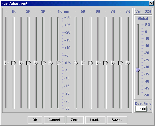

I did ask you what you are working on in this thread, but got no reply. I'll ask you again, then. What are you working on? You talk of adding timing to the stock ECU's timing maps. That can be done with either a chip, or a piggyback, or perhaps even an in circuit emulator (which is what has been used in the past, but they can be hard to get).
And DSMLink works perfectly. What you see in the slider window for fuel is an adjustment to the enrichment table in the stock ECU. So long as you exceed a certain level of airflow in the ECU, you end up on a single fuel map. The enrichment table is only used once the ECU has entered open loop. Otherwise the global fuel setting is used (great way to dial in larger injectors). It gives you very repeatable fuel settings. And since it builds on the factory ECU, the factory drivability is never impaired.
Same goes for the timing map. Once you exceed a certain airflow, you are guaranteed to only be on the top map inside the ECU. Adjusting the timing values in DSMLink which are added on top of that timing map gives you very repeatable results, and fantastic drivability.

Yes, it's still crude. Can you place RPM and load breakpoints anywhere you want (i.e. where they are needed). Can you add 1 degree of timing at 150kpa/3200rpm and -3 degrees at 200kpa/3200rpm. Does it automatically adjust timing offset to account for the changes that MAF attentuation induces? Does it allow you to determine what load reference (external MAP, stock MAF, TPS) you want to use for your igntion, fuel and boost maps? Does it allow internal storing of 10 different calibration files. Does it have a fully mappable built-in water spray control system? If it does, I apologize for ever thinking that something a lot better is just beyond the horizon.

Hmm.. So if I turn up the bass will that get me in the 12's, or do I also need to adjust the treble?

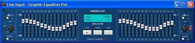

Will this get me in the 9's??
