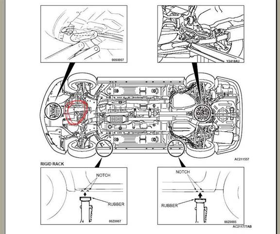

Likes: 14
From: Chico, CA (NOR-CAL)
Here is a diagram of the jacking points.
The front one is covered by the under tray, so I use a bump on the support beam located in the red circle. If anyone needs me to take a pic, I'll do that.

Where do you get these cut sheets from Mitsu? Service manual? If so, where can I get a 2005 Evo Service manual. All I have ever seen is 2004...
And yes, take a quick pic of your lift point, my curiousity is peaked while Im at work.
If you got a picture that would be great!
