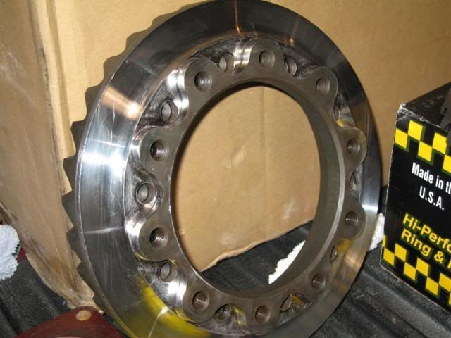

Originally Posted by Kryptonite
We did this to our ring gear recently to lessen rotating mass (note: this ring gear is NOT in the Evo, but you get the idea)
Started as 12 lb, machined 4.5 lbs off of it.....quite a common practice for 9" ford rear ends
Yeah I would not recommend this to anyone. With ring & pinion gears are already a weak point in the evo driveline. (transfercase anyone?)

The ring gear was just an example of what you could potentially do in some form of elimination of rotating mass....I wasn't suggesting to do it to the Evo, but there may be other items to consider. Just throwing out an idea used in alot of racing applications. That set up works wonders for us
