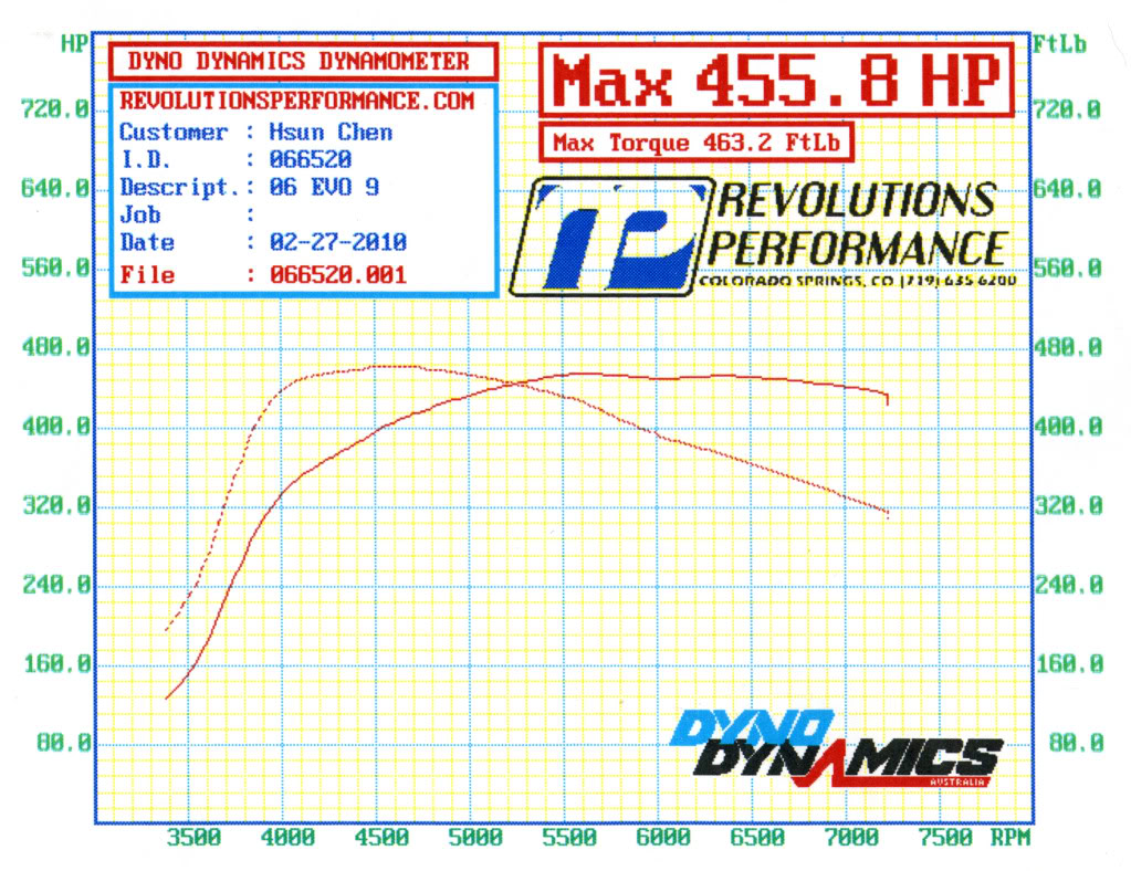

Originally Posted by Raistlin
My next items I am looking at getting would be turbo and FMIC. I am looking for a bigger FMIC that will provide gains above the stock but will also fit without having to remove any crash bars or what have you (I have read on here about people cutting things out to get one to fit).
As for turbo again I want something simple (again not looking for massive hp) that will give gains over stock. At first I was thinking going with just an evo IX turbo for the 10.5 hotside but after looking at prices I might as well find a new turbo that will give a bit more but still similar as far as OEM engine bay goes.
Basically I want to be able to pop the hood and not look like I am modded out of my mind. I want simple and clean looking.
Edit to add: Anything above 350 I would consider bonus. Though I am not sure with boltons only that is possible. At some later date I might decide to start doing engine internals but not at this time.
Raistlin
396.35 whp, UNCORRECTED (455.8 whp & 463.2 wtq @ 1:15 correction factor) with a stock block, stock head gasket, stock head bolts, stock Evo9 head (i.e., no porting or oversize valves).
Major mods: CBRD BBK full bolt-on turbo, E85, Cosworth cams, Supertech dual valvesprings, MIL.SPEC-ported OEM TB, MAP V2 ported OEM intake manifold, PPI-ported OEM exhaust manifold, XS-Power/SS Autochrome eBay FMIC, Precision 1,000cc injectors, single Walbro 255lph pump, Agency Power fuel rail, SpoolinUp COP ignition, tuned by Tobz Performance Tuning.
Please note that my CBRD BBK turbo is pretty much fully spooled @ 4100 rpm, which is pretty significant for both daily driving as well as driving competitions like autocross... feel free to compare my graph to other stock-framed aftermarket turbos that make similar (or even less) power.
- Hsun
P.S. Raistlin, the cheapo XS Power/SS Autochrome intercooler accommodates the OEM bumper beam - I have to run the bumper beam in the autocross class I compete in (SM).
