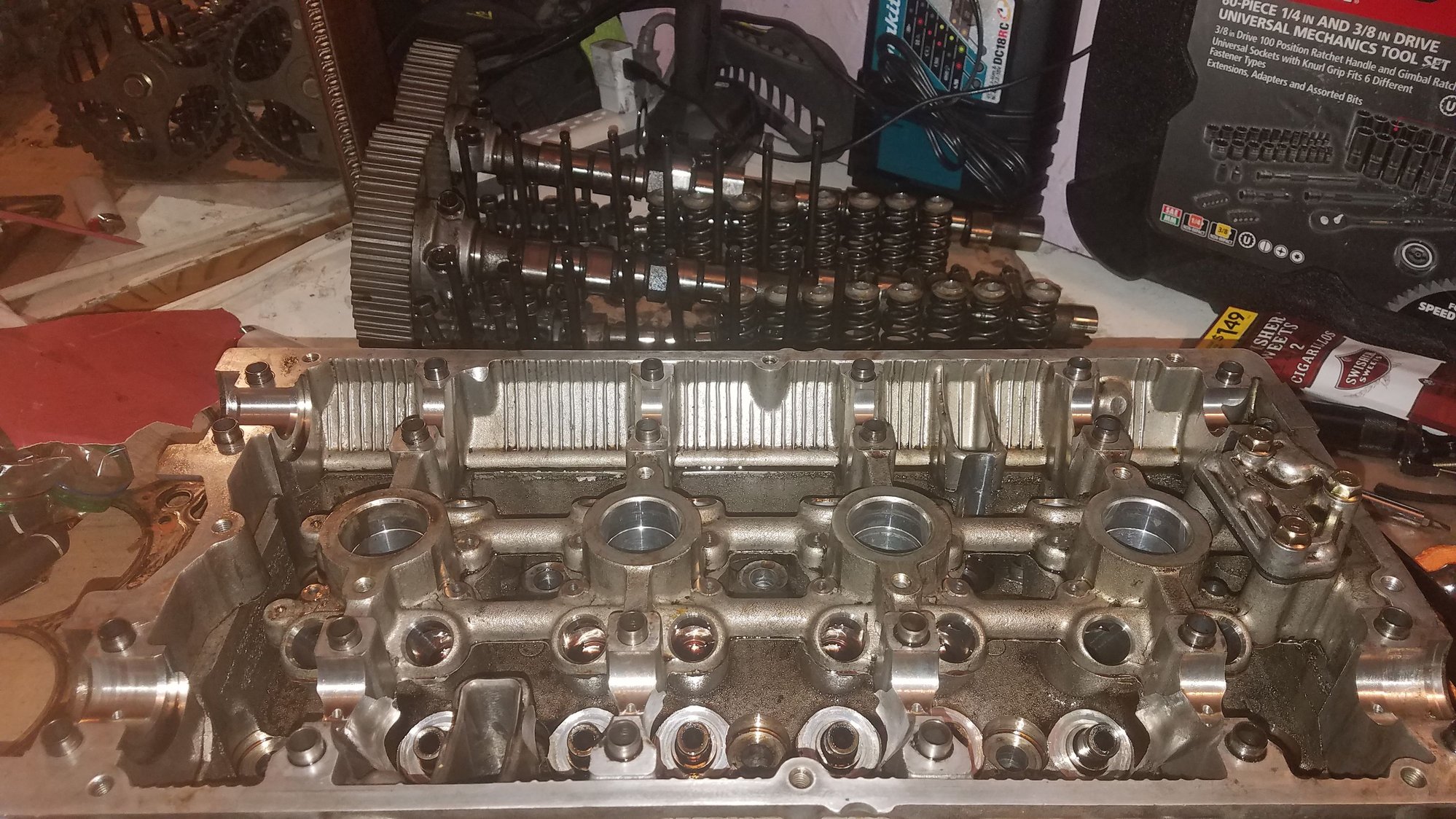

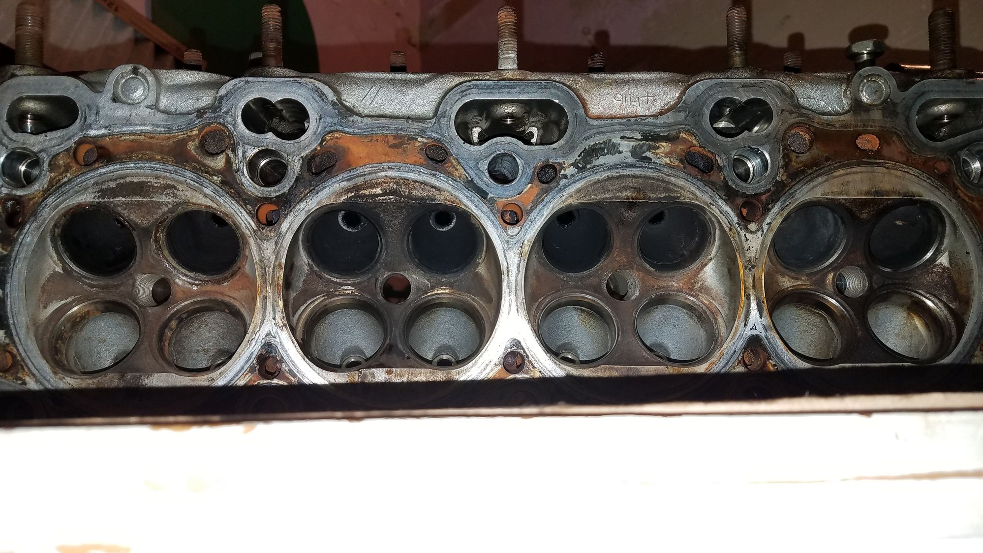

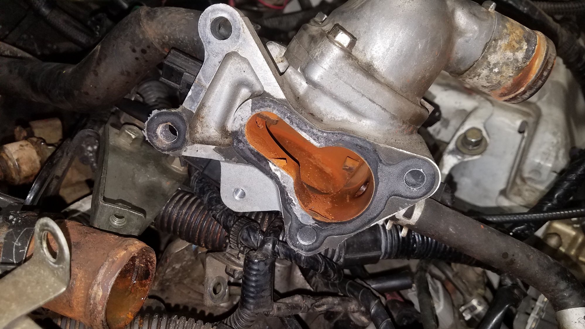

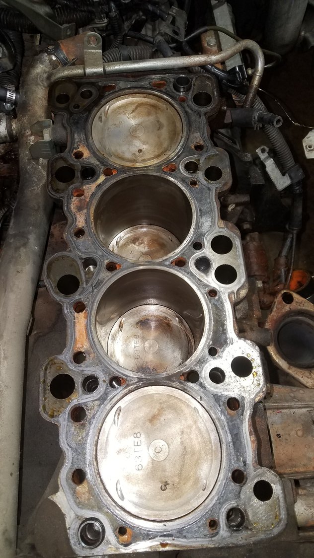

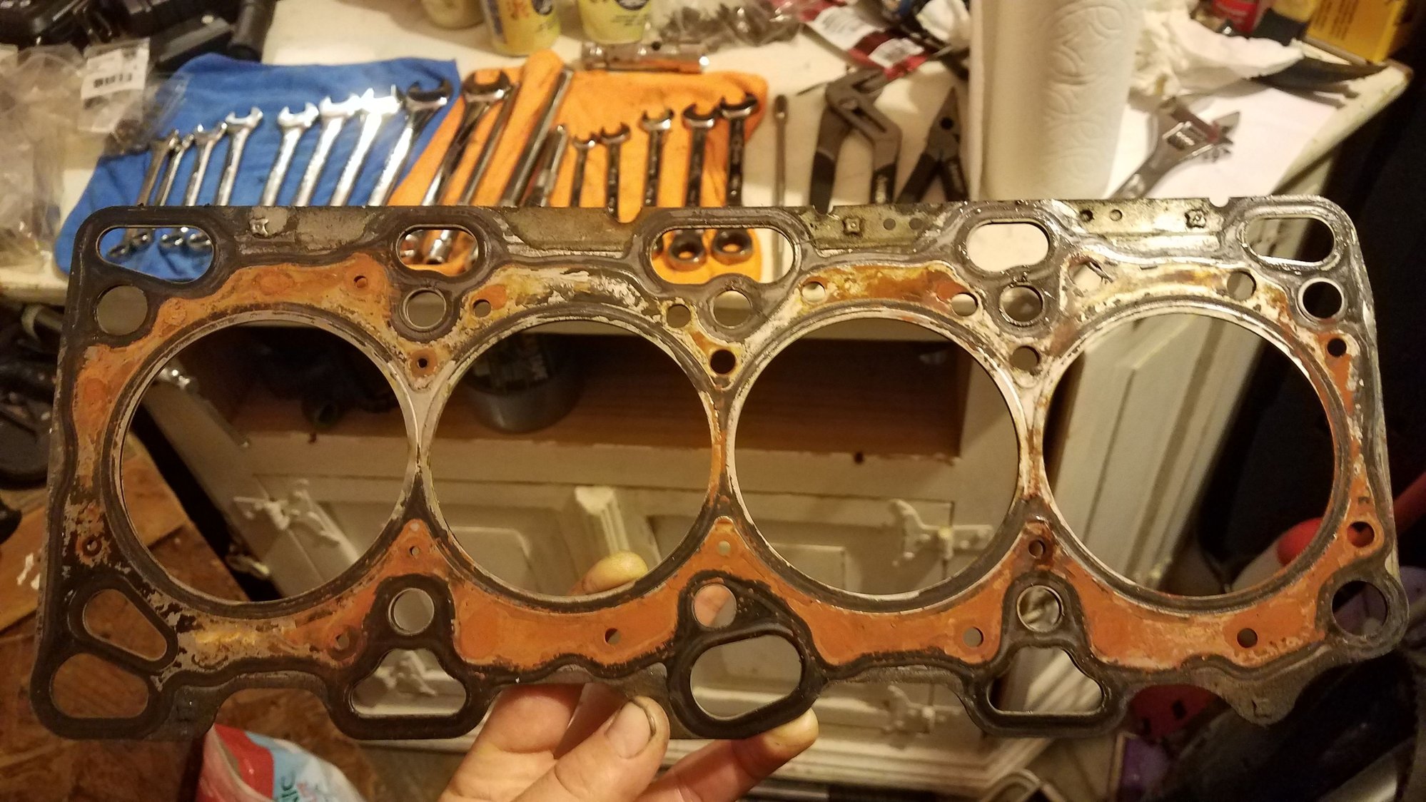

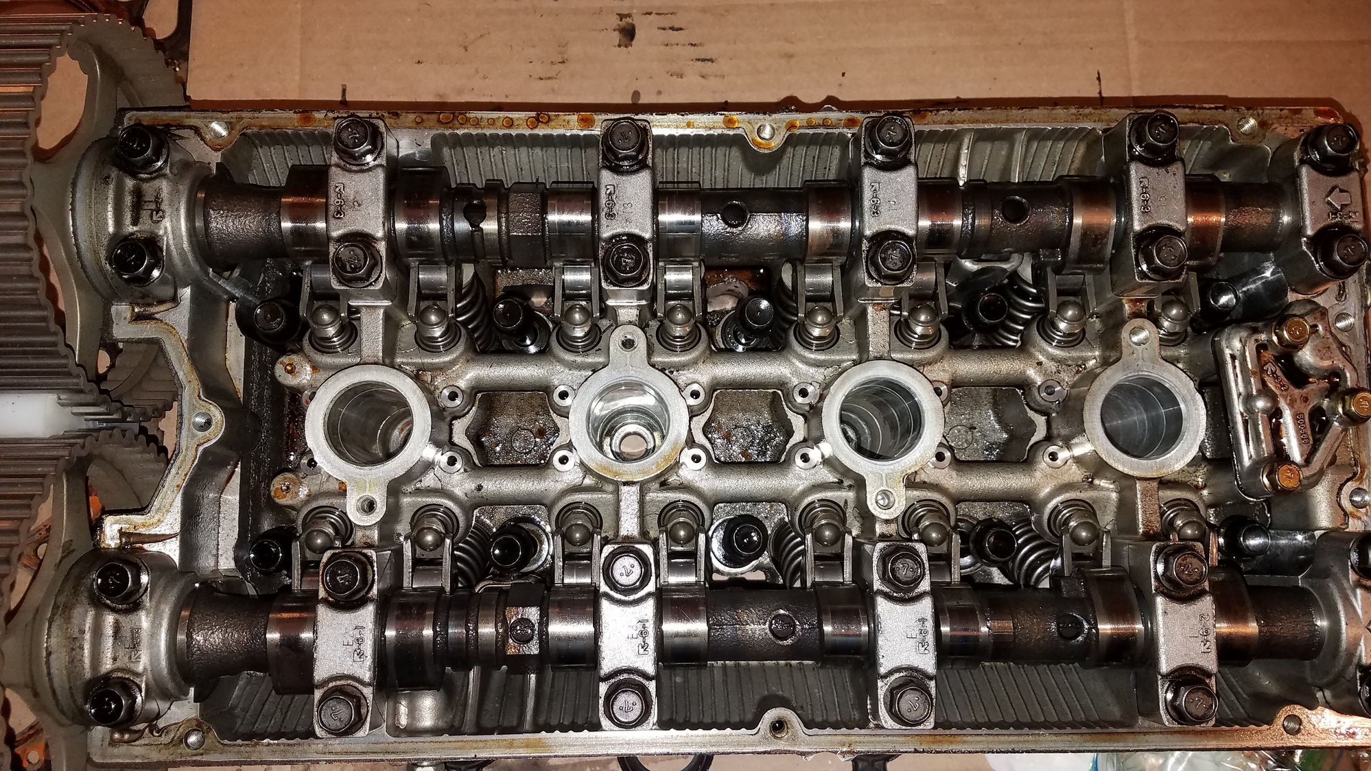

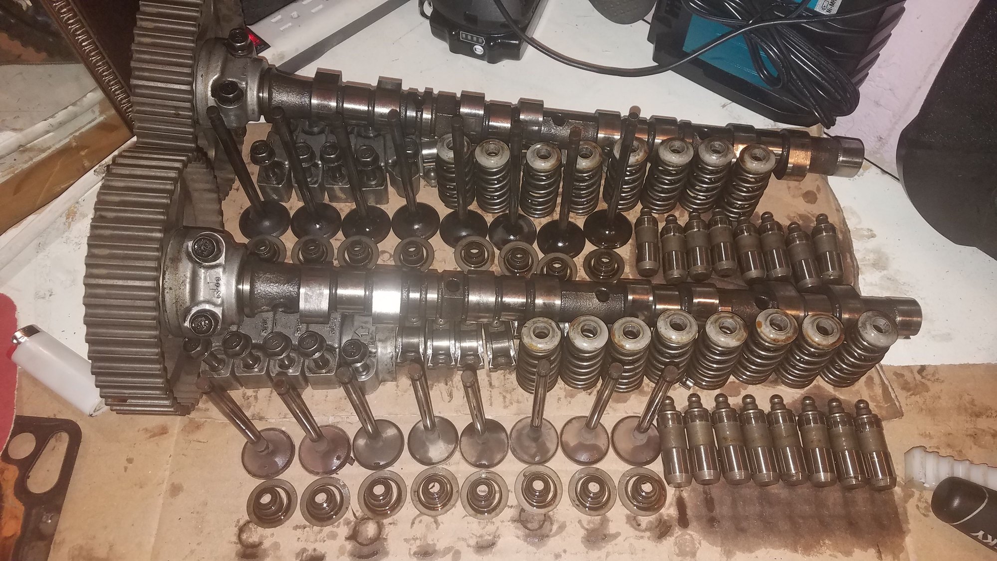

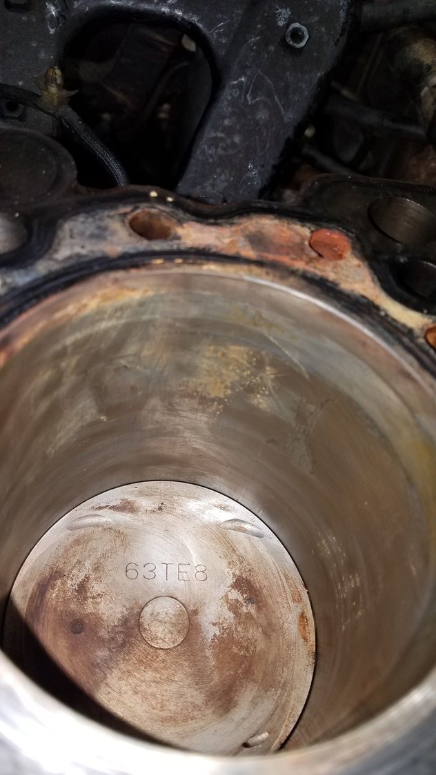

well, head gasket blown so i guess theres no better time then now to do a 120 k service, head rebuild, and some power mods. head gasket failure was from my own ignorance/neglect that i would rather not talk about cause i already beat myself up about it as well as my wallet haha, it is what it is and now to go forward. Rust is all through the passage ways of the cooling system so i have a lot of cleaning ahead of me. any rust cleaning methods would be greatly appreciated (soaking or spray scrubbing). after everything is clean and head is put back together with new parts ill be bumping the power near 500 hopefully.
MODS- Evo is basically stock how it sits with tbe, cone intake, licp, twin disc clutch, evo 9 bov, and aluminum radiator.
Im rebuilding the head with new all gsc parts: s2 cams, valves, lifters, valve seals, seats, beehive springs and ti retainers with arp head studs.
New bolt on mods are bigger intercooler, ebc, radium fuel rail w/ pulse dampener, fic 1050 injectors, walbro 450 e85 pump, and an Arashi TD06hr-r2 turbo with kinugawa wga. plan on duel 91/e85 maps

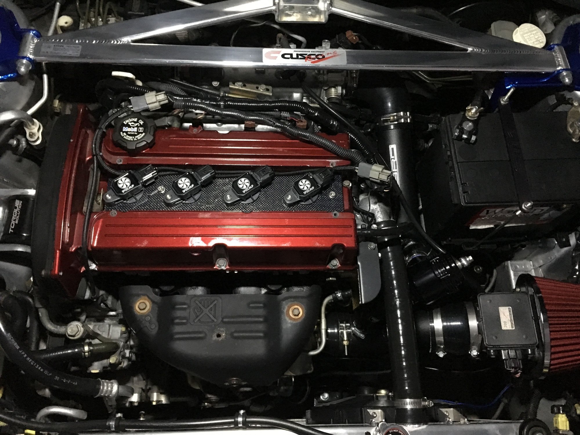

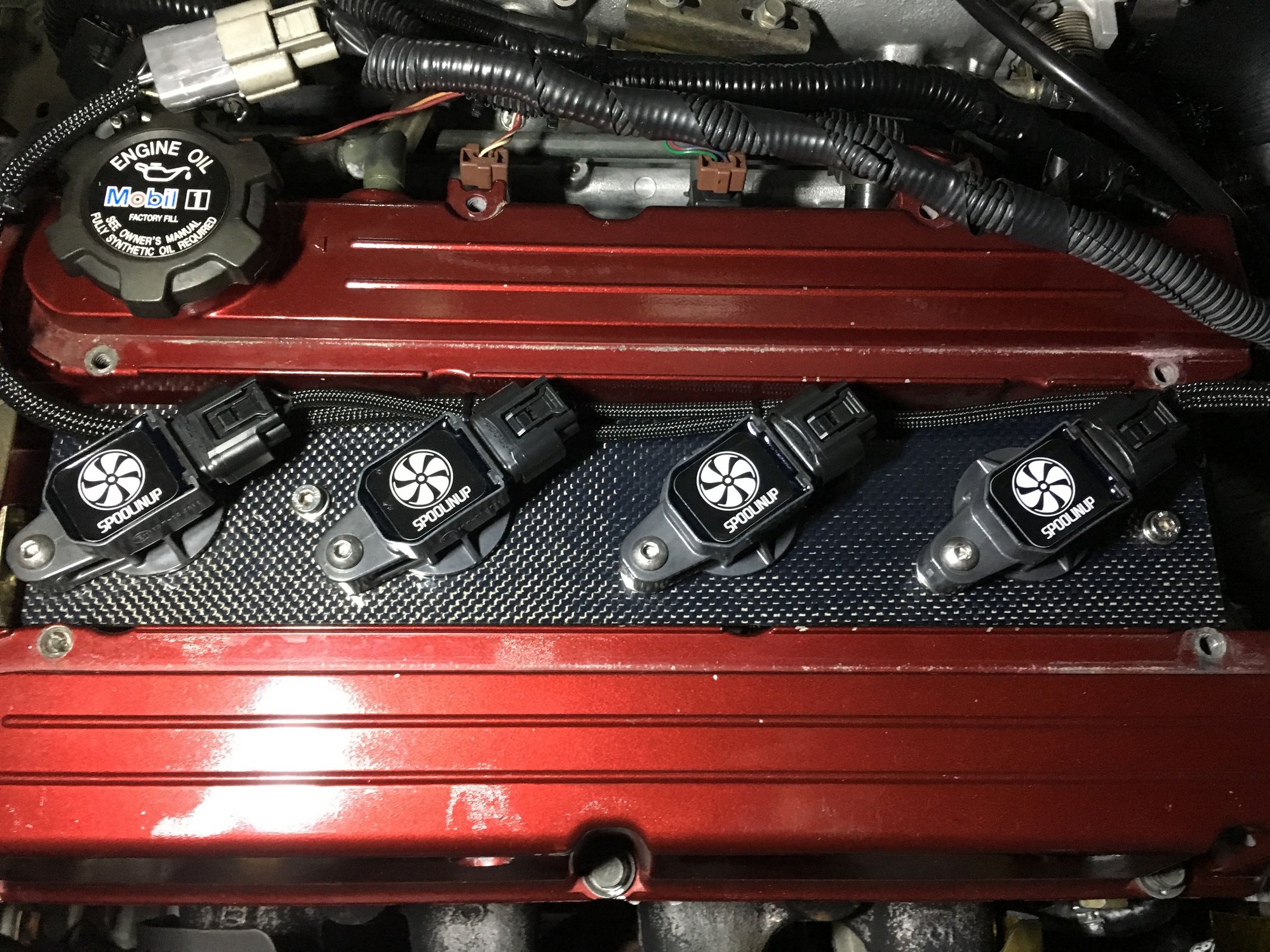

Installed Spoolinup Cop, still need to clean up wire harness a bit

Looks good, its been so long since I installed mine. It ain't as fancy as they are now I guess i have the old school set-up when spoolinup didnt have carbon fiber and stickers on top of the coils. Just the basic Toyota coils with the stainless base.
