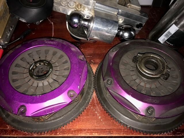

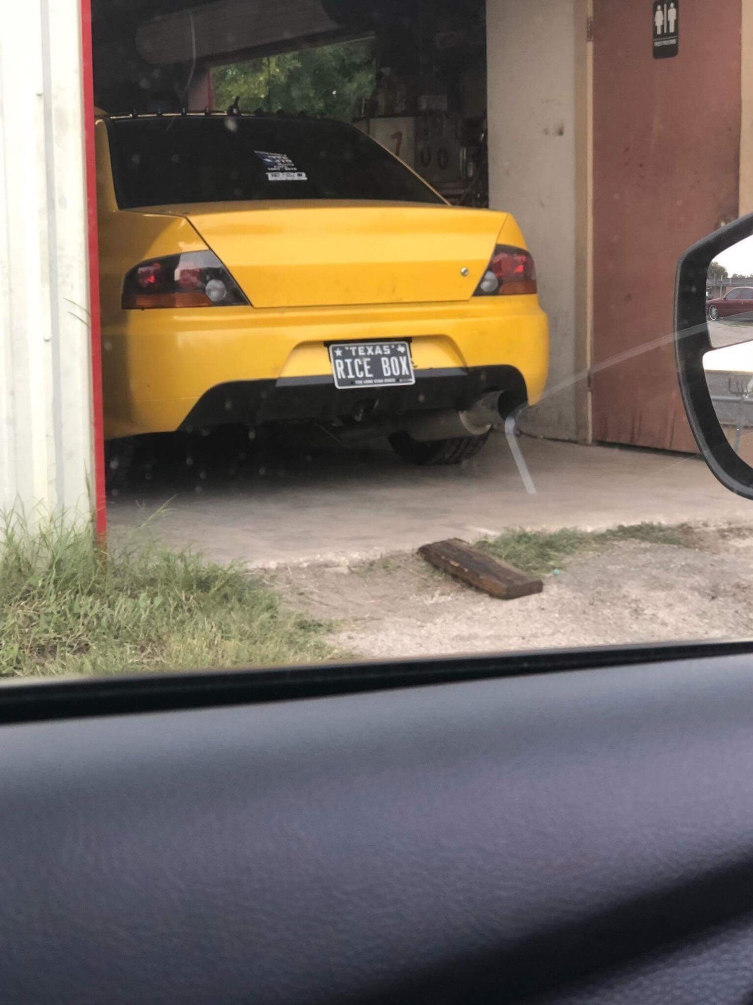

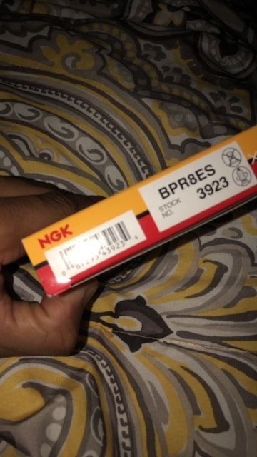

gave it a wash, got plugs for it, setting up a triple out of these two, got a front mount at a good deal,

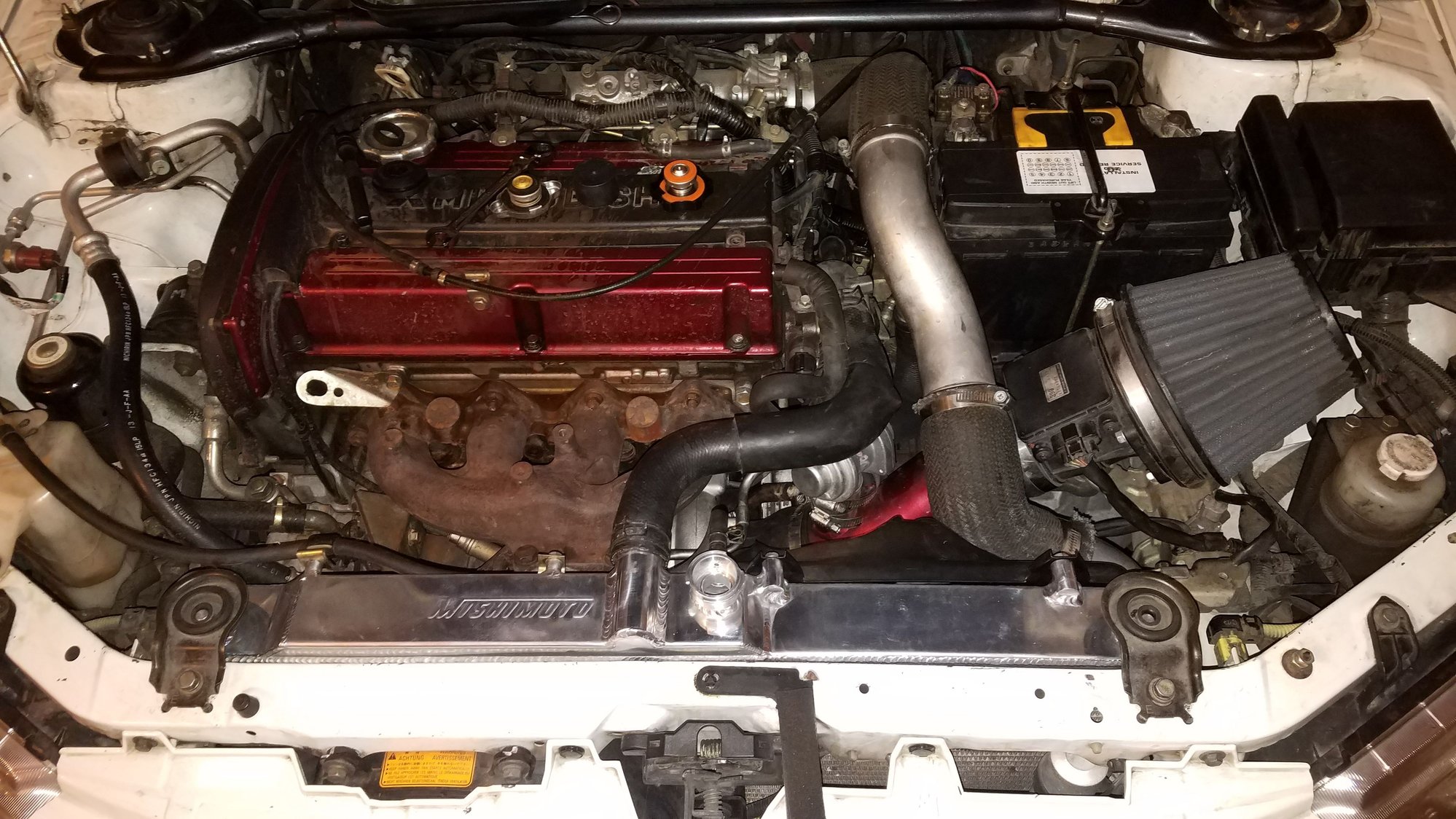

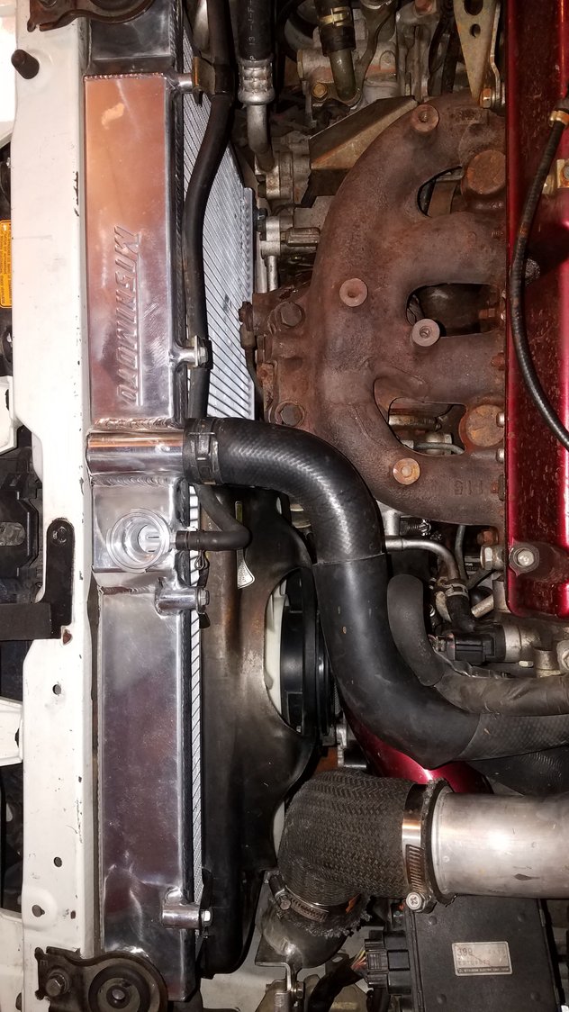

Finally got her breathing Again. New mishimoto radiator and replaced a turbo colant eye bolt. Forgot how much I enjoy driving it after sitting for so long
Was a tight fit. May need to get an aluminum fan to make some room in there
Old one was petty toast

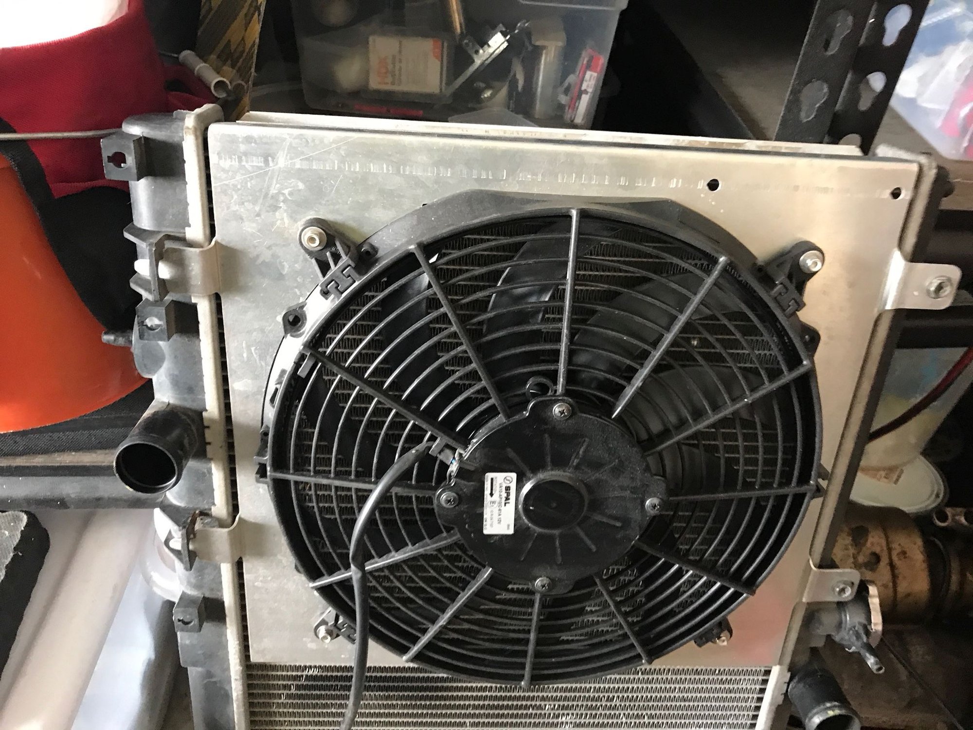

FOR SALE LET ME KNOW lol

Do yourself a huge favor and don't run their radiator cap. It's a19 psi cap, the water pump will not like it and it'll blow the weep holes out. Then you'll be replacing your water pump. Ask me how I know.
​​​​​​Use the stocker or another 1.1 bar cap!

Yeah I remember reading that somewhere before I bought the radiator, might have been you haha. I used the old one but its a replacement and not sure if it's 1.1 bar. Says 16 lbs on it. Think that will be alright?

How much for that aluminum fan? What kind is it? Haha

That's the right one.

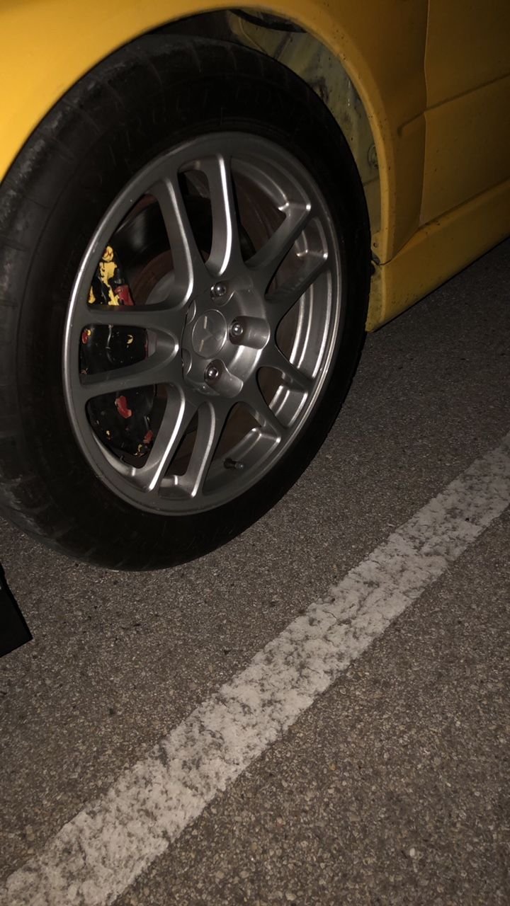

finally found center caps for the wheels and installed my new battery since las odyssey one blew

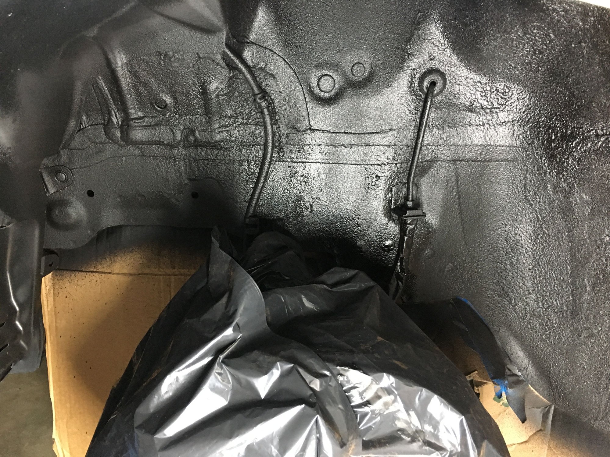

Winter prep... love Maryland winters
