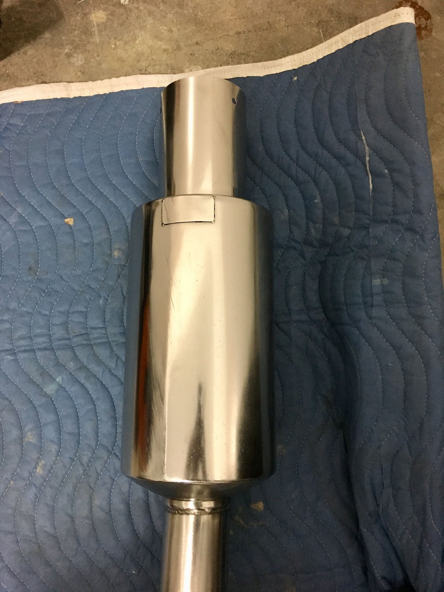

My exhaust has been chipping paint for a while now so I finally got around to cleaning it up as best as I could for an old exhaust.

What did you use to clean that, thats pretty good.

a little bit of everything haha jk. First I scrubbed it with degreaser and a scotch bright pad. Then i used a wire wheel that you can attach to a drill and just grinded the left over rust and paint off. Then go back to degreaser and scotch pads working your way from very course to fine. Then I used these metal Brillo type pads from 000 to 0000 gauge or size. After I was happy with the level of shine I wanted or could even get, I then used a combination of compounds,metal polish and last I used jet seal. I’m happy with it and I’m not repainting muffler after all that. If you want more details let me know.
