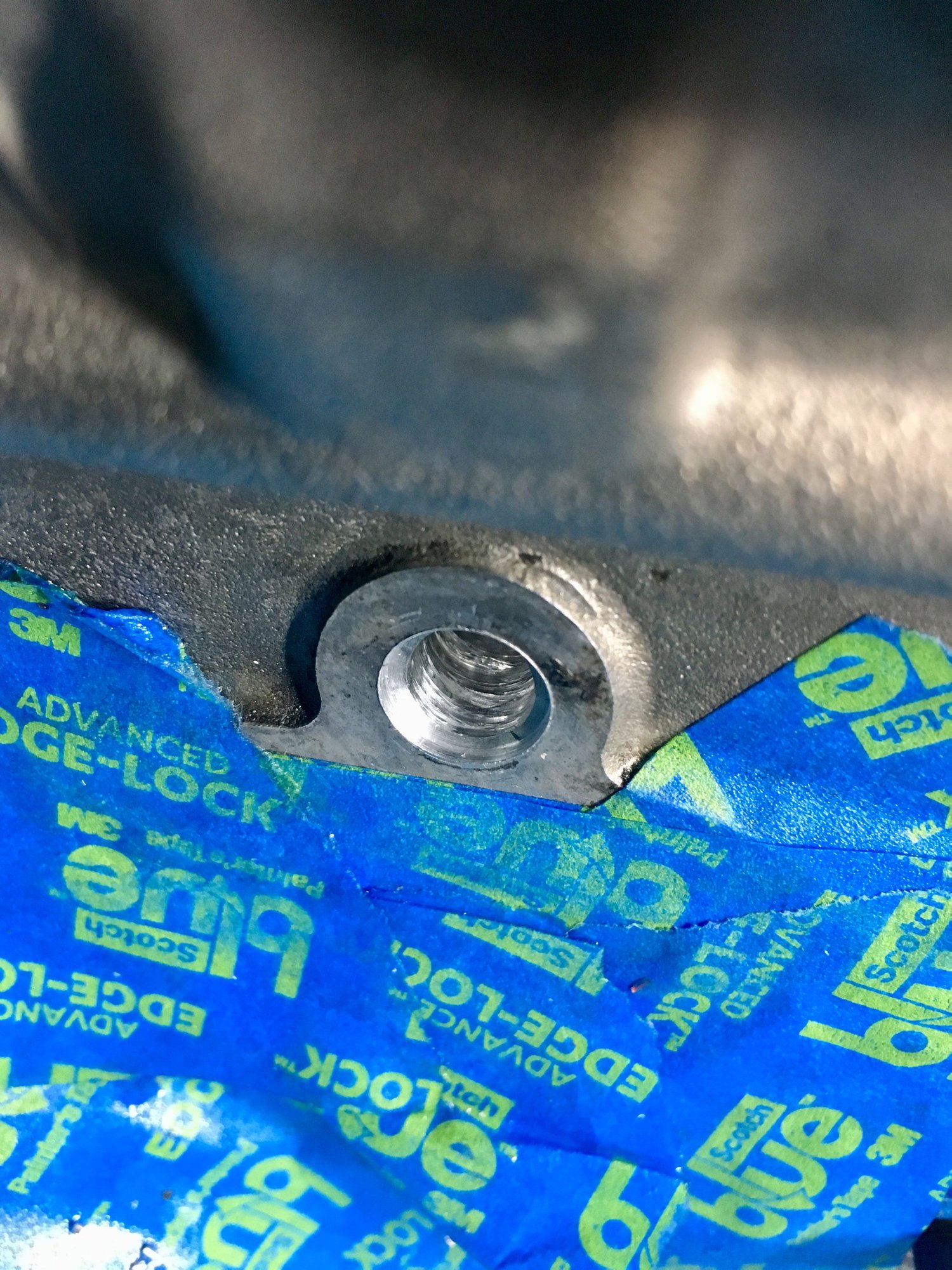

Got home from work and saw my stripped manifold stud and it’s stripped inside the cylinder head but it won’t stay tight and won’t get tight fml.. red loctite is not working. Any recommendations? Heli coil , time-sert, new head? Ugh
i just tightened this as tight as I could get it and it looked like this after a 30 min ride home.

I would heli-coil first. That should hold fine, if it fails, you could always JB weld it in

thanks I’m going to give it a go this weekend, keep you guys updated.

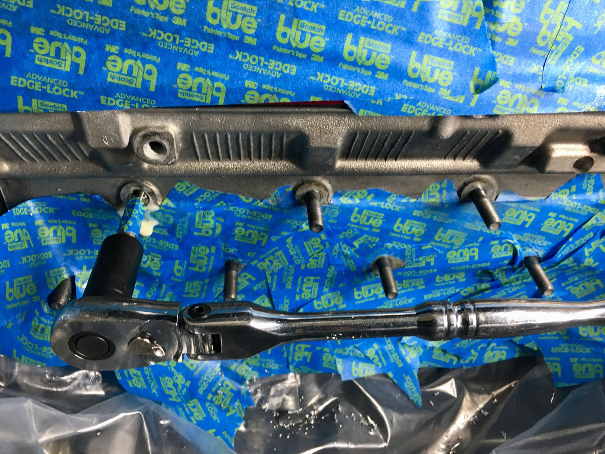

Wrapped downpipe , engine cleanup and hardware cleanup like chasing threads and tapping etc while I’m waiting on my time-sert kit to get here.
This is the hole that needs the repair.

Time sert kit came in and the cars all fixed just gotta wait 24hrs to fully cure to test it out.

Got the turbo and other bits all installed and everything torqued down !! My repairs worked yay lol.

Nice job on the repair of that stripped stud hole. That is how I would have done it. Hopefully that nut stays tight for you as the thermal expansion coefficient for cast aluminum and steel are different. I think it should be fine.

Thanks , however now the lower one is stripped out ugh.. I’m gonna pull head now and get it fixed or get a new one and add some goodies to it. I’ll keep you all posted or make a build thread maybe.
