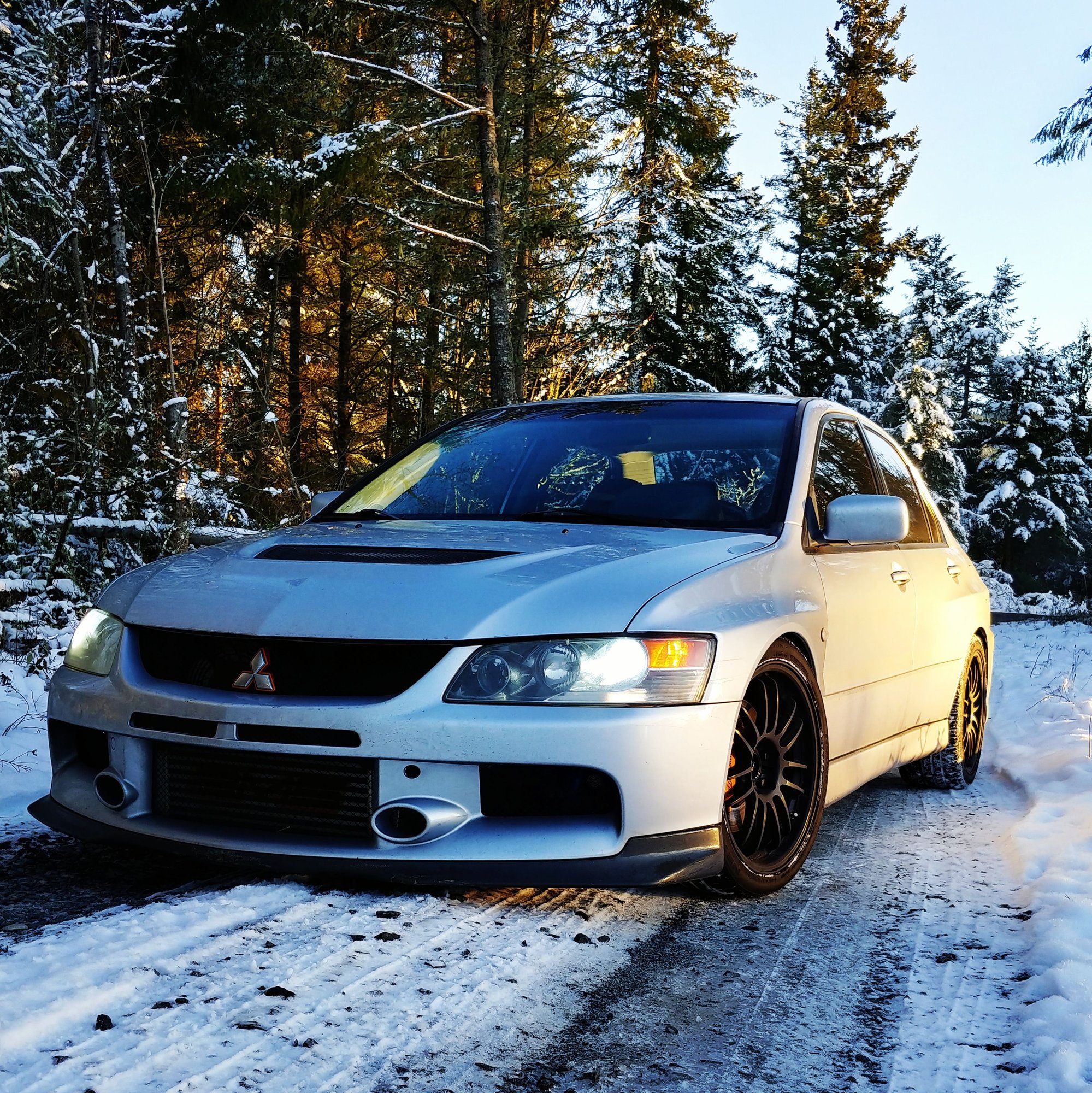

Picked up a new IX, silver SSL. Two owner car with a clean carfax. Previously a California car with 127xxx miles.
GSC head work
GSC 272 cams
FP green
HMBC
ARC heat shield
Fujita intake
Fujitsu intercooler pipes
ETS fmic
Invidia exhaust with Magnaflow mufflers
Open dump with knockoff Turbosmart gate?
RC 1650 injectors
Egr delete
Agency Power fuel rail
Racing Demon COP kit (can't find info on this)
KW Robi spec Clubsport coilovers
Volk RE30s
Stock block? (Awaiting new borescope arrival)
Innovate gauges
Carbon lip
Carbon type C trunk spoiler
Yesterday I changed the plugs and ran a compression test 140 across on a cold block. I can live with those numbers. I have ordered evo scan as the tune could use some work.

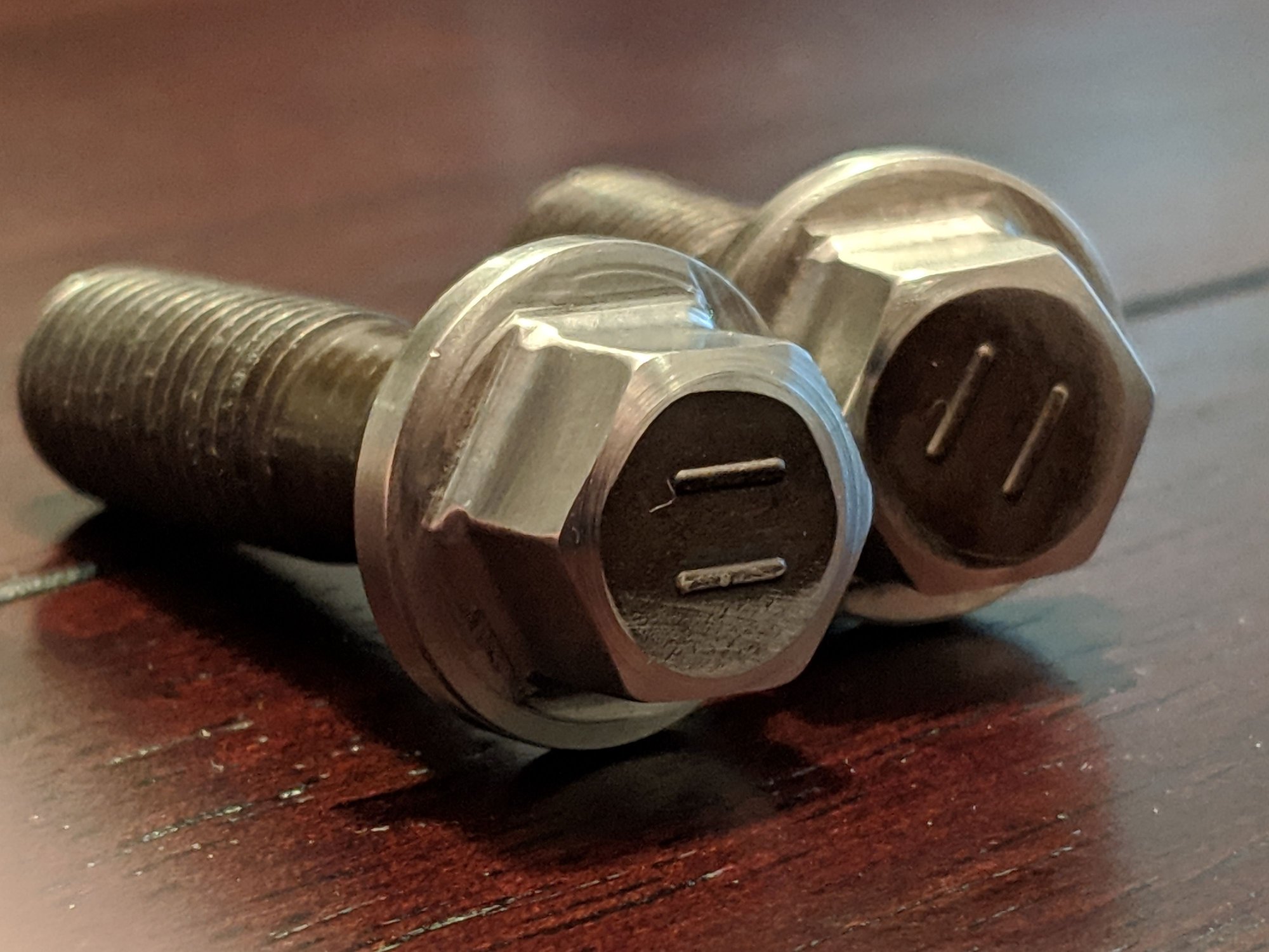

Gave these metric bolts some ‘Merica today. Took the OEM MN119783 turbo to manifold bolt, reduced the head from 14mm to 12mm, trimmed lip off head, reduced flange etc didn’t take very long and nothing half assed. Perfect fit, won’t break off like Arps, can get tools on easy, 1G in the rear makes it OEM all the way around. Perfect FP cast manifold bolt kit and I won’t be drilling out another ARP. Glad made a couple extra lol!

^^^That looks mechanically clean
Saved both pics for my work SS

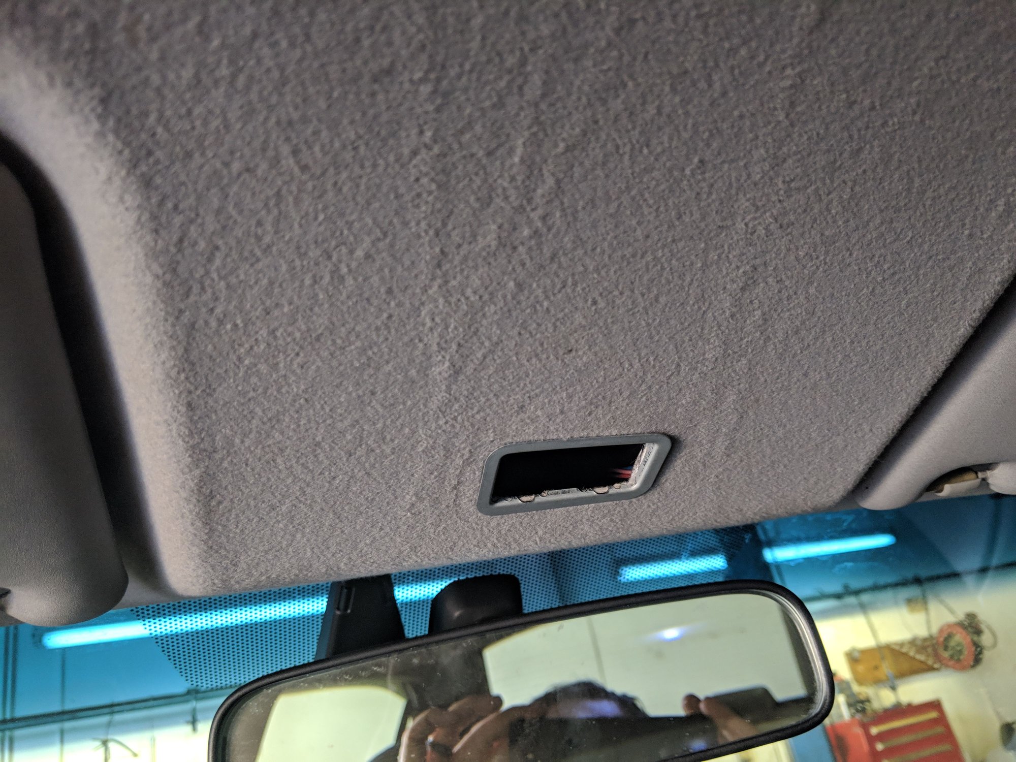

Sucked it up and cut a hole in my headliner. Moved the microphone from behind the dash trim to the roof using a '19 Mirage microphone bezel (microphone was incompatible, but the Outlander microphone snaps into the Mirage bezel).
