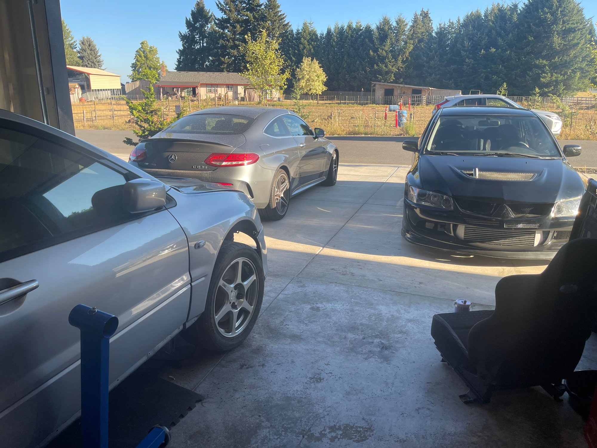

we bought another one
already needs work after driving it home, we’re assuming the IAC died. This morning I attempted to run some errands and it was stalling every time thr clutch was pushed in, couldn't keep the car alive unless it had constant throttle. I didnt even make it off of my street before having to obnoxiously keep it running back to the driveway
Anyways, going thru all the old threads, and is one of these IAC recommended over the other? there’s AC254 and AC571. I’m going to buy both now just in case, but curious what others opinions are.

wont let me edit post, keeps saying server error
Anyways popped the IAC off the silver evo, and slapped it in the new one. back to running normal after doing the relearn. the other one was toasted lol, no movement no clicks just dead.
I also thought it might’ve been a boost leak after visual inspection because the IAC’s bottom bolt to the TB is “missing” but when i pulled the IAC there it was snapped off in the TB. I’m going to attempt to back it out but worst case does anyone recognize this TB mfg/pn/etc?

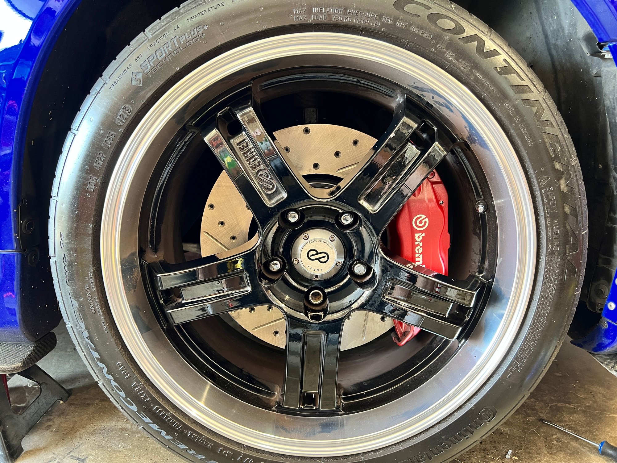

Replaced my brakes and rotors with Stoptech Premium and EBC Red pads. And found my tie rod end had play so replaced with MOOG ES800874.

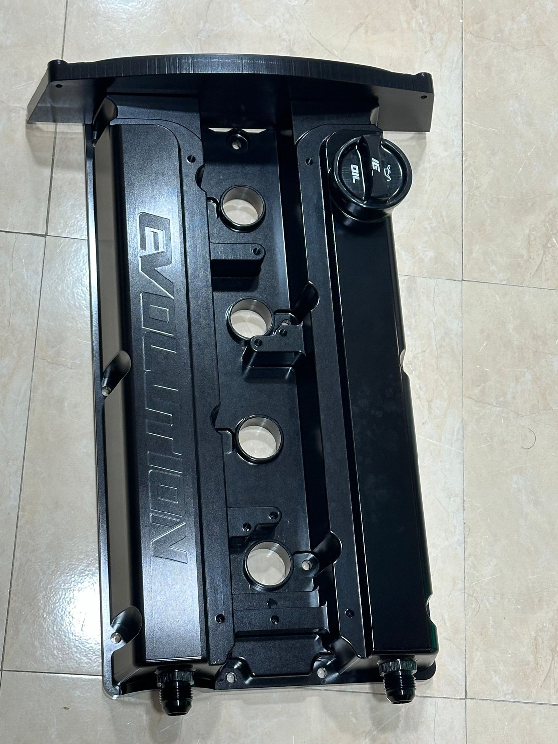

Got in my Ichiban billet valve cover.

Looks awesome! What was the lead time on this? Any reason you went with Ichiban? Any issues with installation?

About 6 months, first one got lost in the mail and they sent me a replacement. Frontline Fab was OOO when I was ready to buy a VC, HyperTune never responded to my emails. I haven't installed it yet, hoping to have it done by next weekend since I'll be installing the IE CAS housing, IE Billet thermostat, all new OEM coolant/temp sensors, thermostat.
