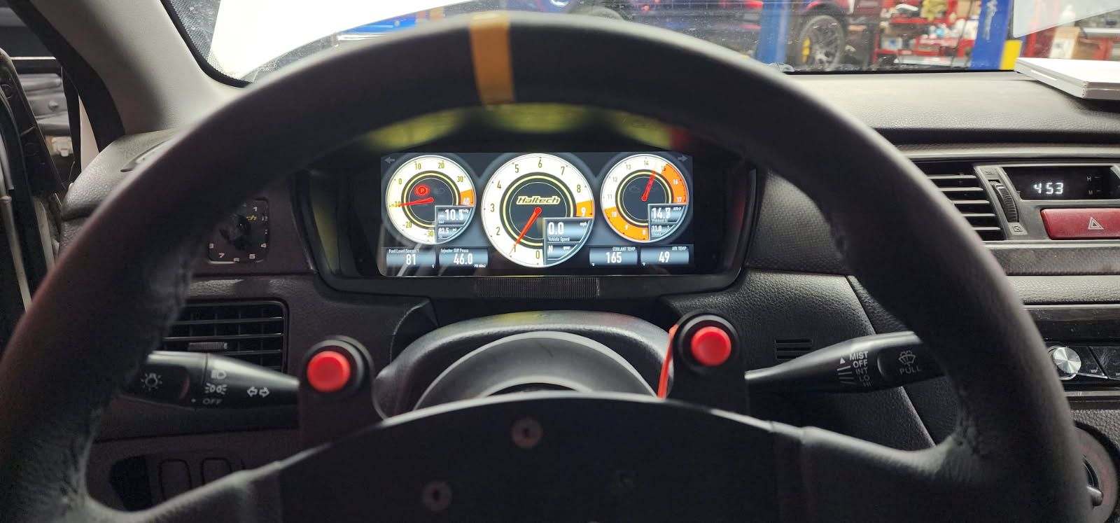

I replaced my IC-7 with a UC-10, swapping out new bearings to refreshing up the motor, rpf 1's 17x9.5 and 17x9 for slicks.

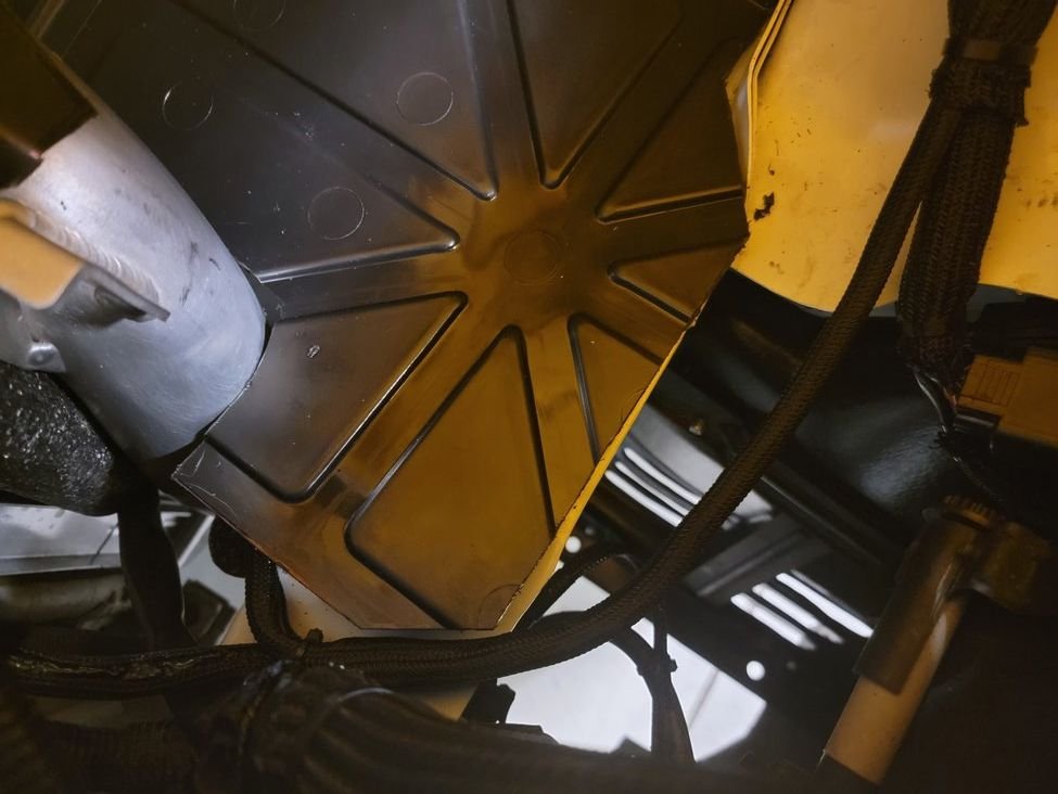

Worked on the Wire harness for the 2nd year in a row. Trying to clean it up more then i did last year.

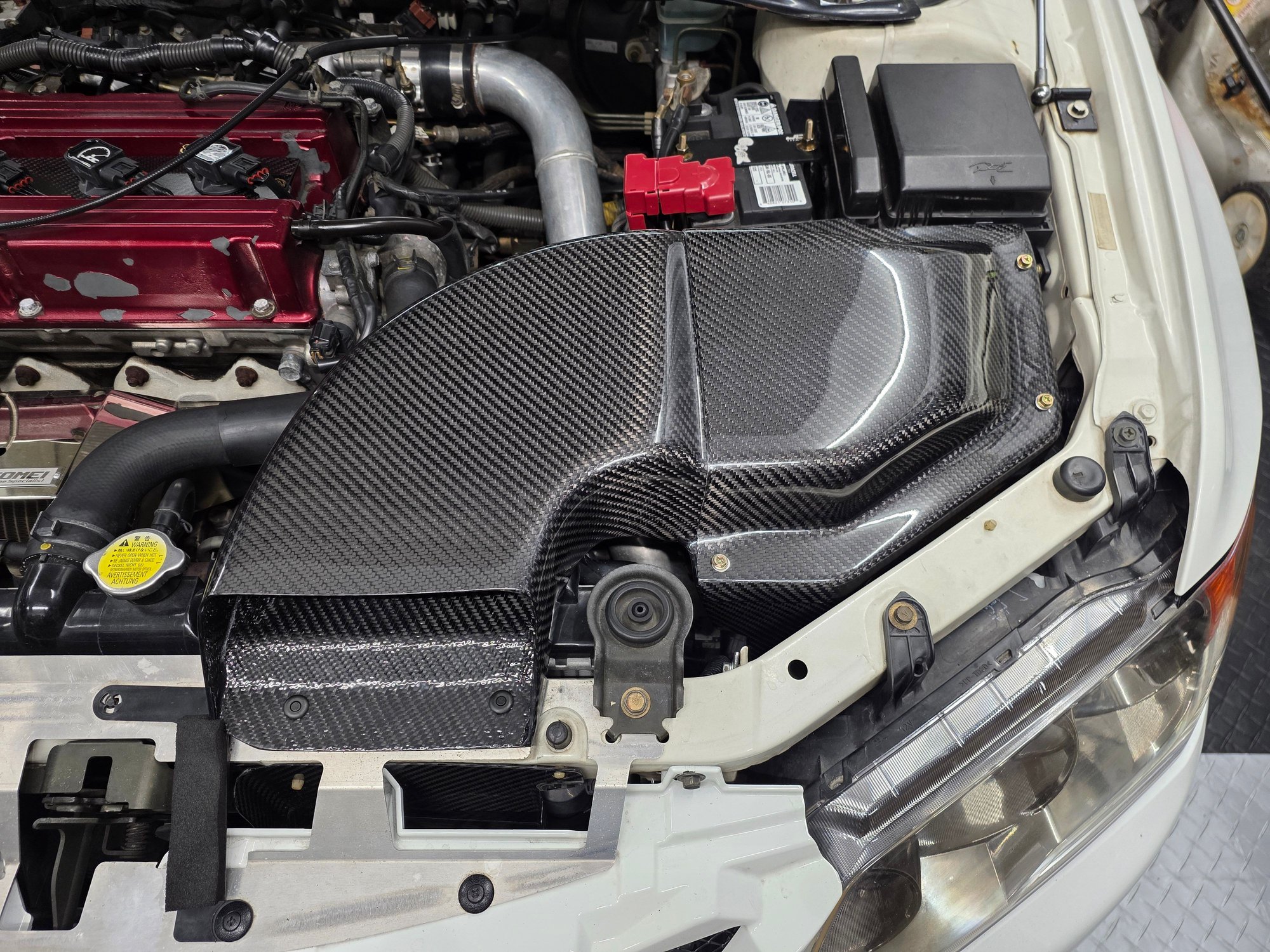

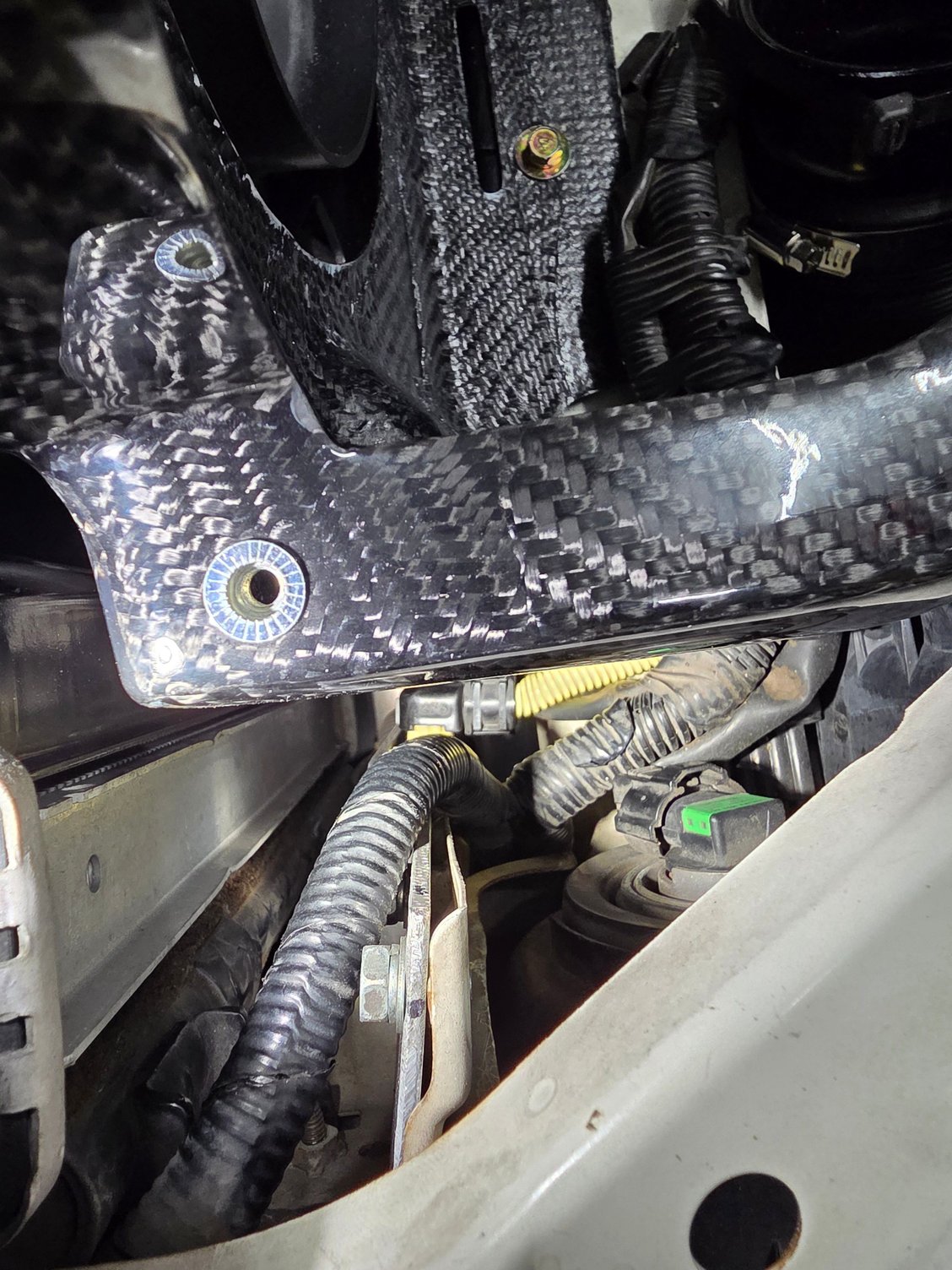

Installed a CF intake box from RPG Carbon which is a copy of the HKS Kansai box. Quality was great but had to modify a few things to get it to fit as I suspected from old posts. Mainly relocating the SRS airbag sensor and cutting a slot for the radiator fan shroud bracket. Also used a naca duct to route even more fresh air to the bottom of the filter.
I wanna do something like this and have it lead up to my turbo. Being I relocated my acd to the trunk I have all that room. I wanted to do this to like an airbox, then have it go from the air type box to the turbo.
It's pretty easy. Just have to remove the front bumper. Bought zip ties, double sided tape, and 2 pieces to make it work:
I'm not sure if thats necessary or even beneficial unless the belly cover is missing. on mine the fender liner already ramps up all the air coming thru the airdam. I just needed to block the frame side
