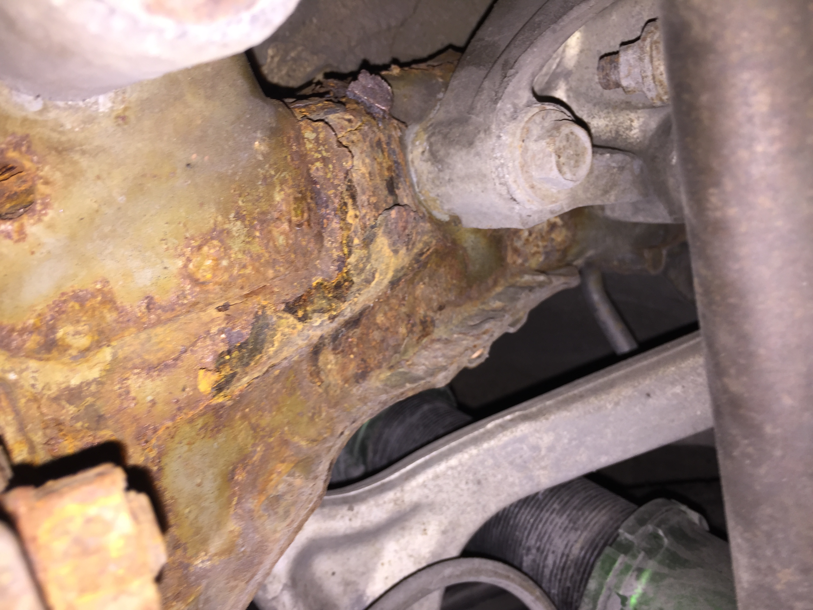

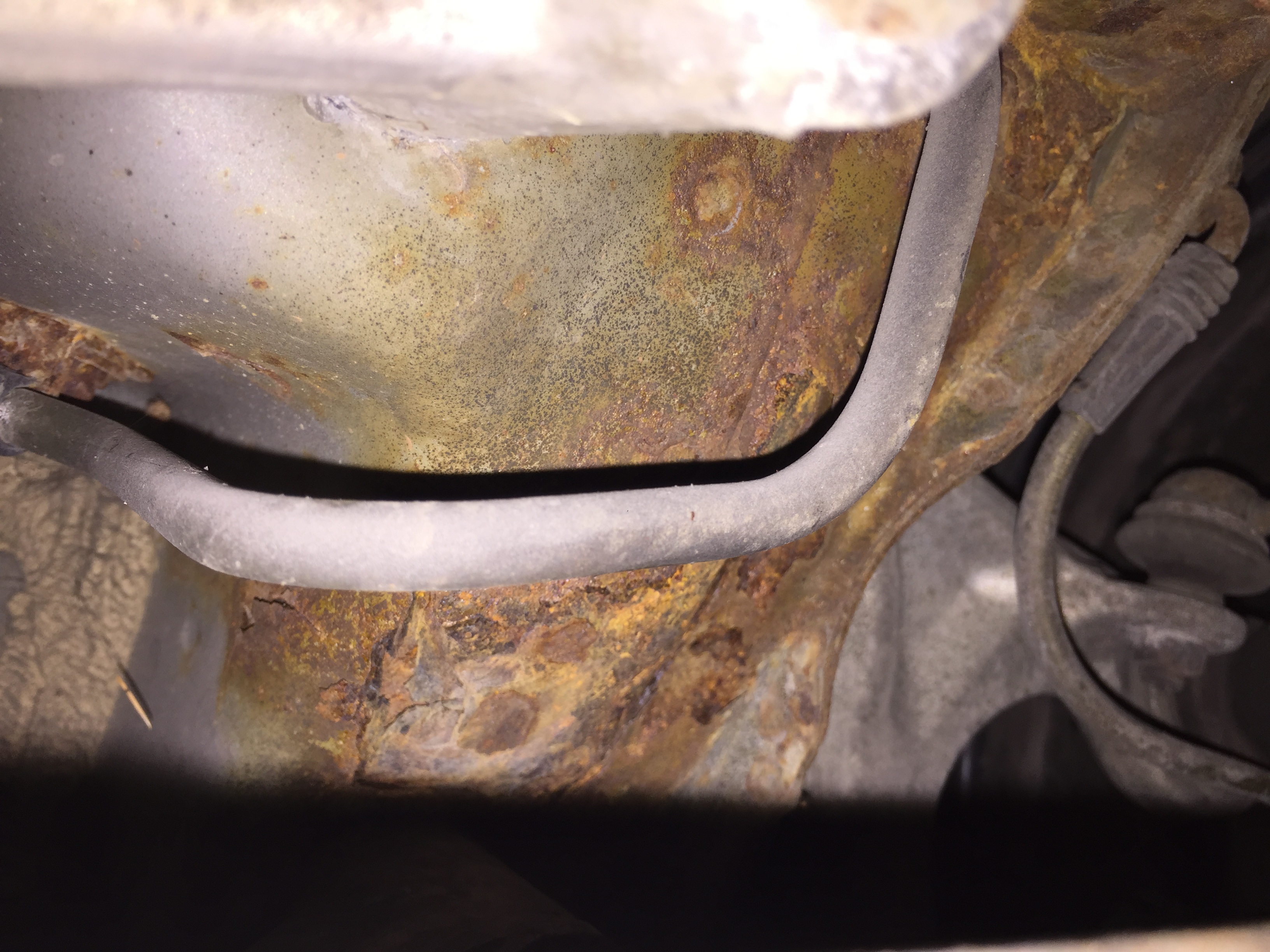

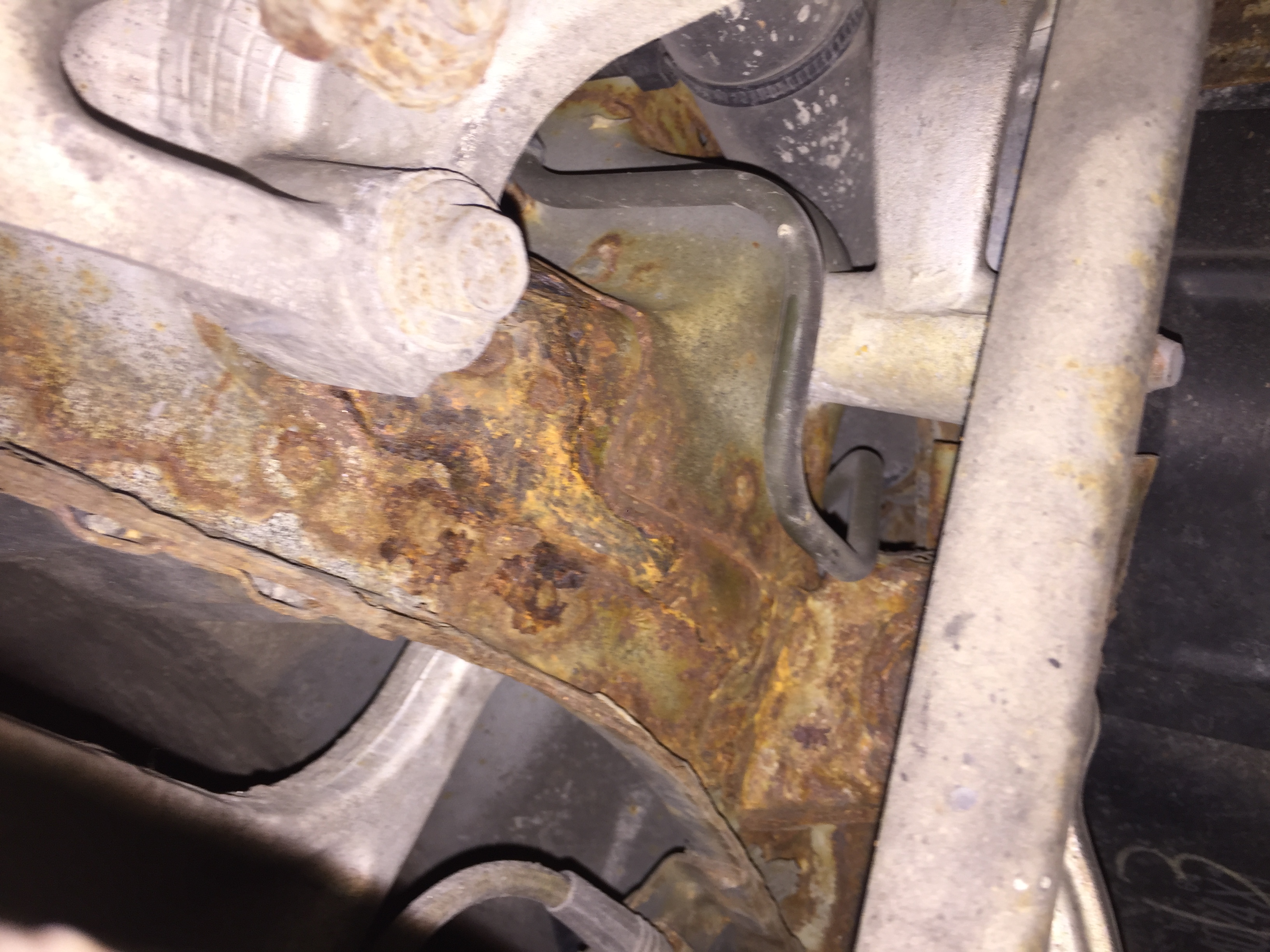

I was reading through this thread and had the car on the lift, so I decided to check the area that people are finding some bad rust on the rear, well prepare yourselves. From what I have seen its actually not that deep and mostly surface rust. My current plan is to take off the rear suspension/subframe assembly and wire wheel it and then try to fab up some new metal to weld in. Has anyone done that rust repair DIY on this car before? Any misc tips that could help the thread? Something specific to evos?

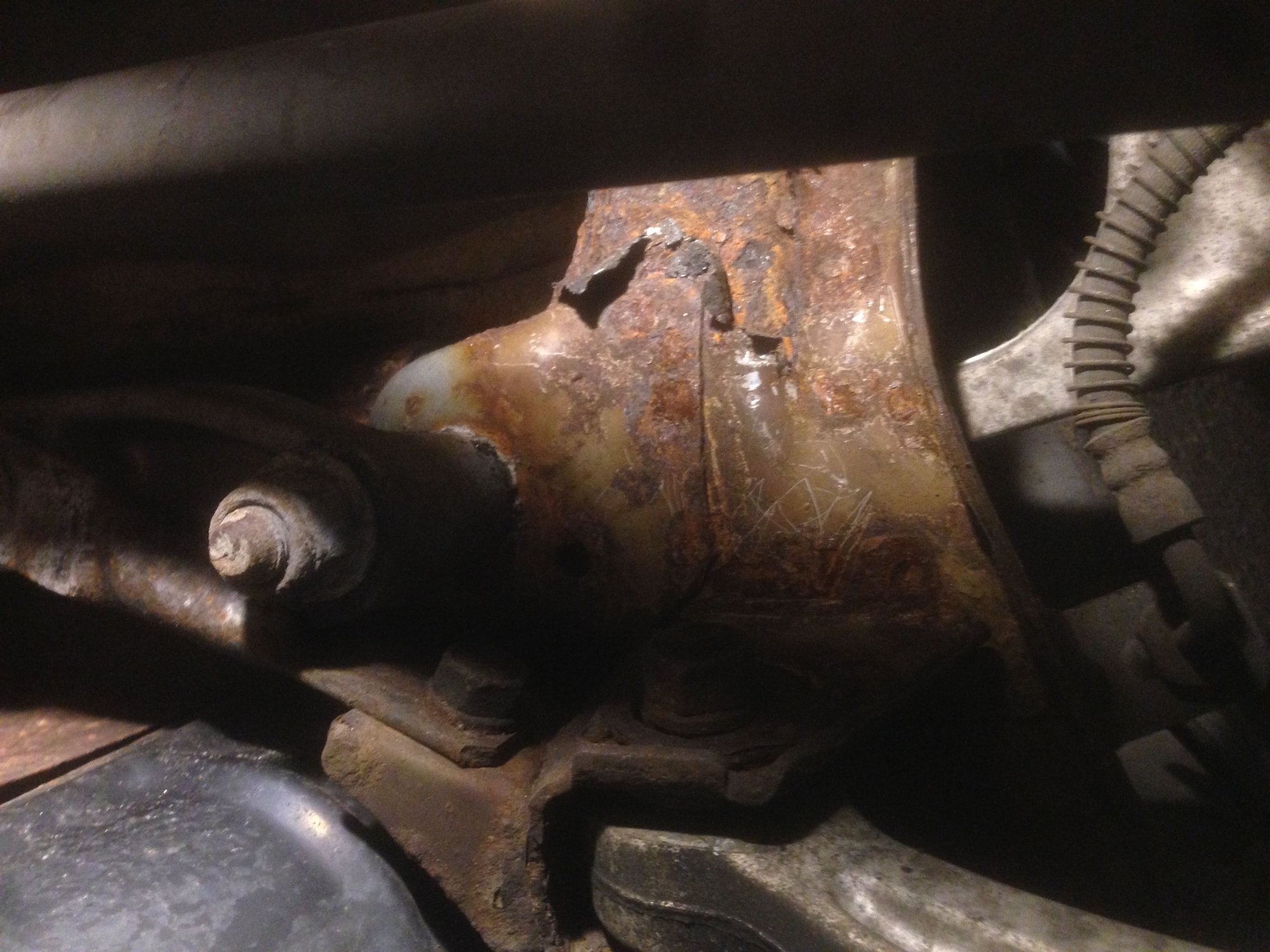

never seen this happen before, anyone else having those issues?

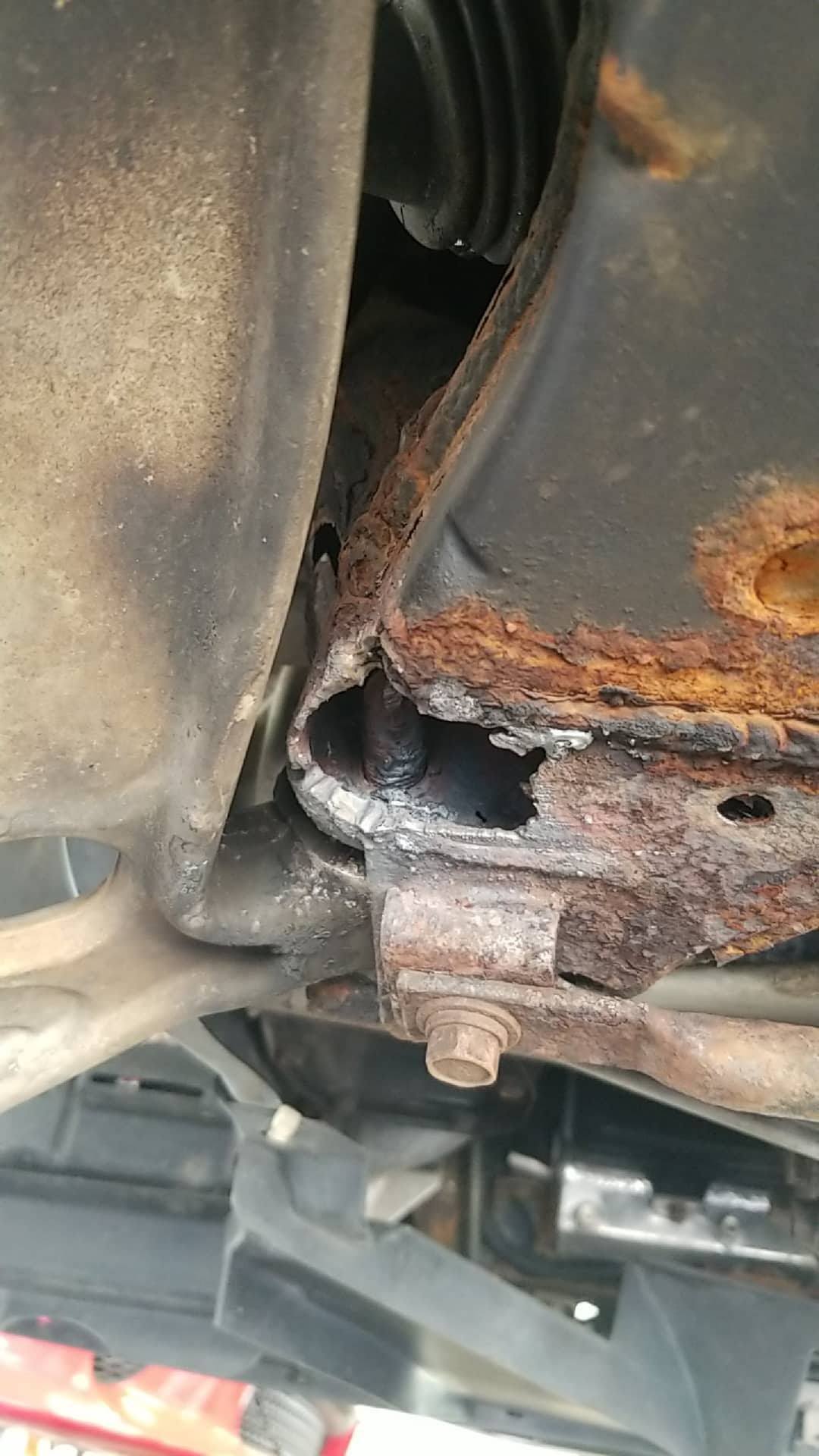

Front cross member that was supposedly treated by Mitsubishi dealership a year ago.
