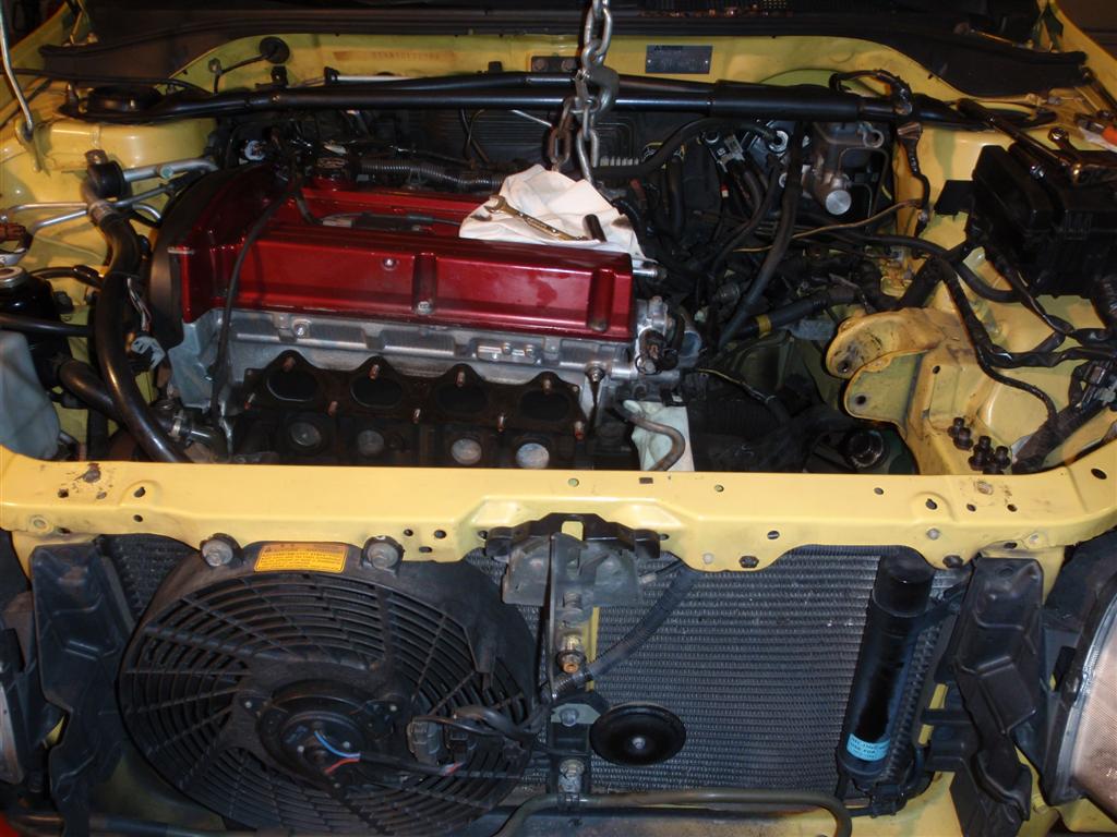

So here is the picture of the setup when I bought it (this is from the sellers post) notice that left radiator bolt
Here is the custom radiator bolt hole that was made by forcing a 17mm bolt through it. NICE.
Here I begin tearing it down for the clutch change. At this point I have already decided this turbo setup is half-assed and will be changing it out for a buschur kit. I am a little frustrated at this point, knowing I am now going to have to change out the turbo setup for something that will be proper. But the worst is yet to come.
notice the turbo and the oil.
so the Tilton clutch came out relatively easily, other than a few stripped bolts and rusted tight bolts on the exhaust.
oil in the intake
the turbo, definitely been leaking for quite some time!
the gate setup.... wow
The nicest piece on the motor, the shearer manifold (i will be reusing this on the new setup)
So everything from the turbo setup is now off the car... and I begin thinking about doing a stage 3 buschur head

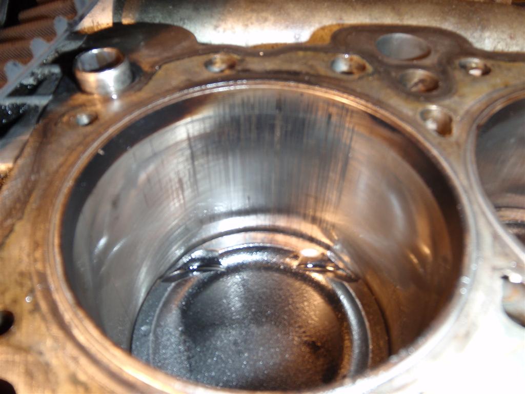

So I decide since I have the motor pretty well torn down, i might as well get a Buschur stage 3 head. Honestly, i wish i wouldn't have opened the motor to see what I found. I took the head off today and find this:
cylinders #1 & 2
cylinders #3 & 4
Cylinder 1 is really bad, the scores are pretty deep.
