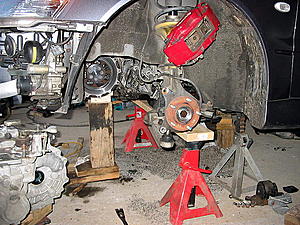

Thanks for the input. I'm a big step closer to finding out what I've got as I finally got the tranny out. Dropping the subframe ~3" made all the difference.

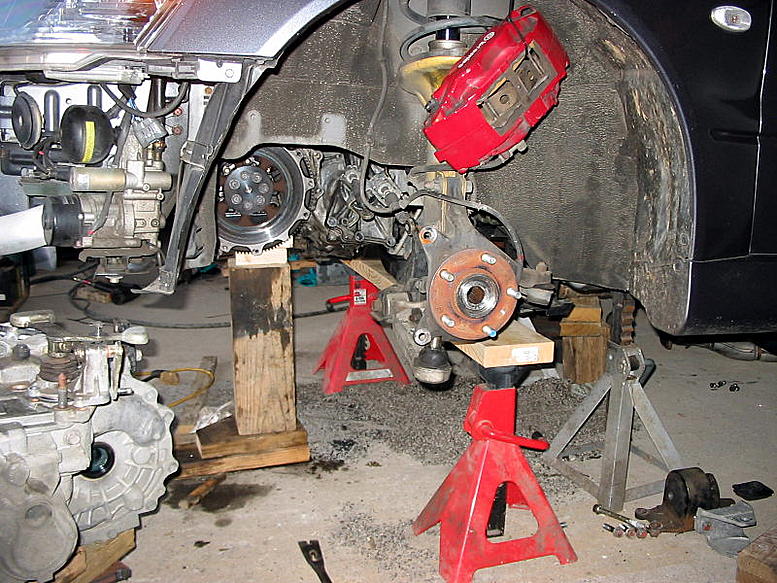

And . . . it's out!
Attached Thumbnails Winter Project:  '06 MR Needs TLC-evo5.jpg

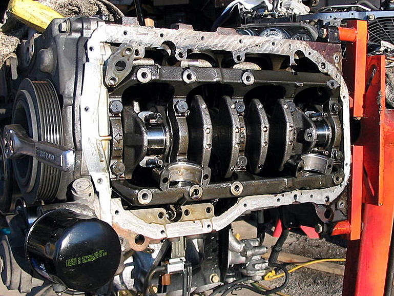

Old Dec 30, 2009 | 01:53 PM
Ardent's Avatar
Joined: Dec 2009
Posts: 57
From: Virginia
So the fun begins!
Everything looks good here. . .
Attached Thumbnails Winter Project:  '06 MR Needs TLC-evo6.jpg

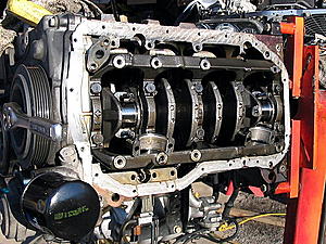

Old Dec 30, 2009 | 01:57 PM
Ardent's Avatar
Joined: Dec 2009
Posts: 57
From: Virginia
. . . and it looks good here.

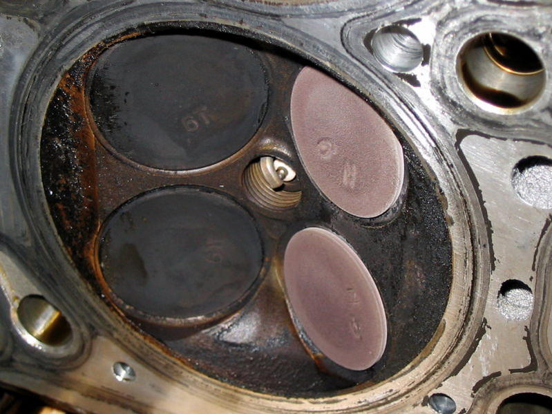

Old Dec 30, 2009 | 02:01 PM

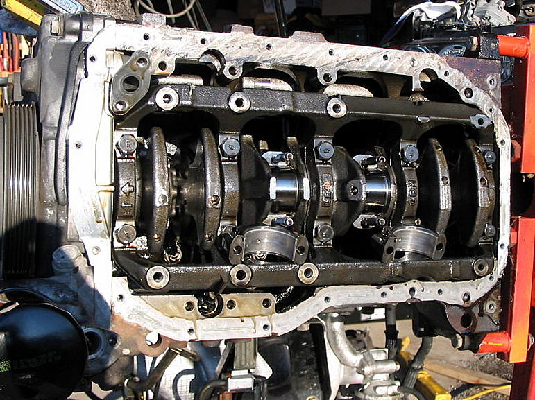

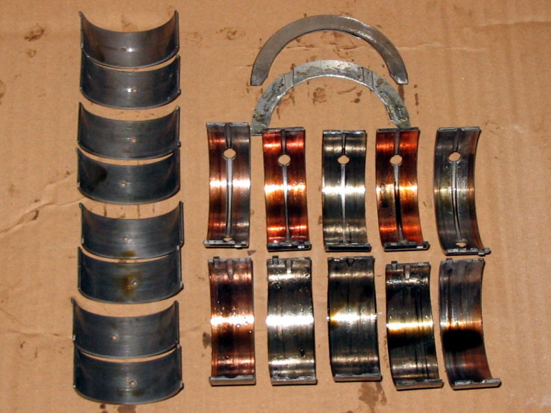

Ardent's Avatar
Joined: Dec 2009
Posts: 57
From: Virginia
Here's the problem!
Notice the bearing tangs missing from the center bearing since it had spun. Also, it's not showing copper because all of the copper is missing. I found it in the oil pan though.
Attached Thumbnails Winter Project:  '06 MR Needs TLC-evo8.jpg

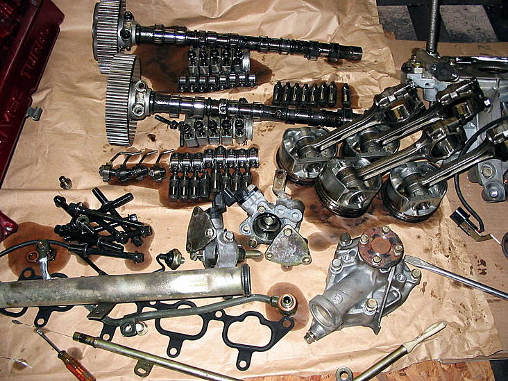

Old Dec 30, 2009 | 02:05 PM
Ardent's Avatar
Joined: Dec 2009
Posts: 57
From: Virginia
One of the piles of parts:

Old Jan 9, 2010 | 01:31 PM
20gmr's Avatar
Joined: Jan 2007
Posts: 874
From: hershey pa/williamsport
oil pump failure most likely. Take the oil pump pulley off and look closely at the bore in the front case. Also don't forget to take apart the mivec cam gear. That thing can hold some serious amounts of metal.
