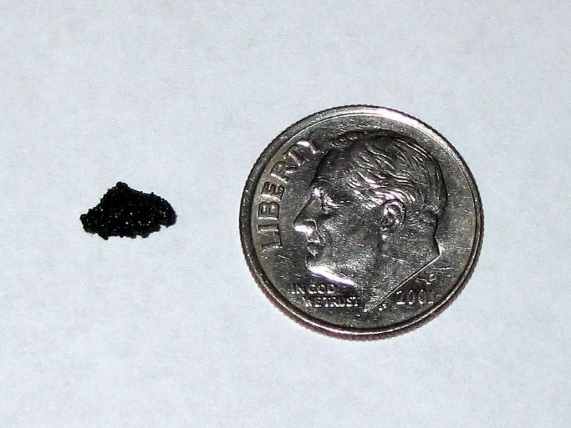

The oil pump checks out with amazingly little wear. The factory machining marks are still visible on the aluminum end plates.
I have found what appears to be a possible failure mode.
The two front oil passageways cast into the block had large amount of casting slag. The passage from the oil filter to the main bearing tunnel was the worst. I was able to easily chip out a tic tac sized chunk of slag that is hard as a rock.
A small piece of debris breaking loose from this location had nothing to slow its transit to a main bearing.
Suffice it to say that some die grinder work has rendered these passages quite clean and shiny.
I've not seen another engine with this much slag and it couldn't have been in a poorer location.

Here's a shot of slag that chipped out of the oil passage:

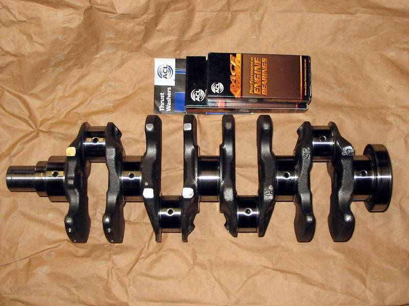

Some parts about to go back together . . .
Attached Thumbnails Winter Project:  '06 MR Needs TLC-evo12.jpg   Winter Project:  '06 MR Needs TLC-evo13.jpg

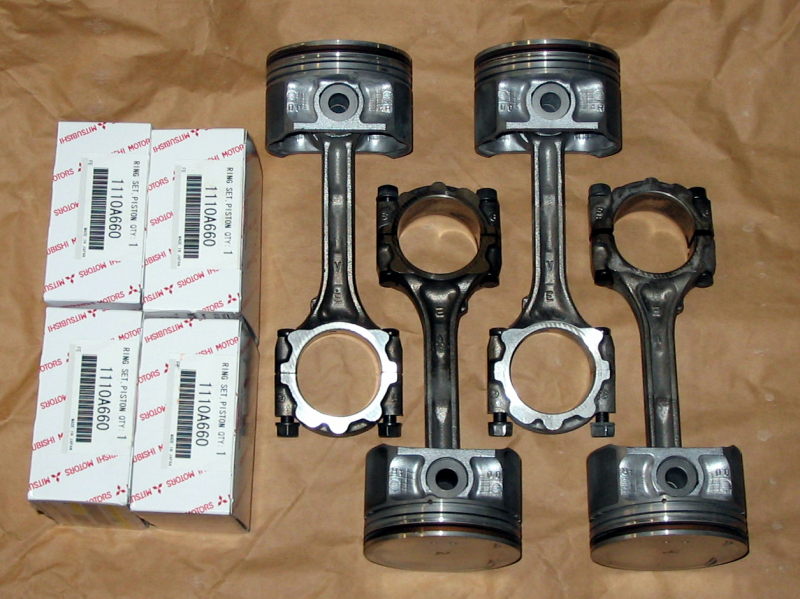

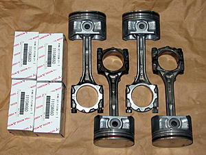

. . . once I get a new one of these:
Attached Thumbnails Winter Project:  '06 MR Needs TLC-evo14.jpg   Winter Project:  '06 MR Needs TLC-evo15.jpg

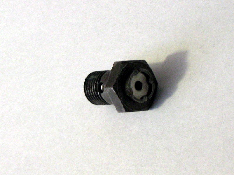

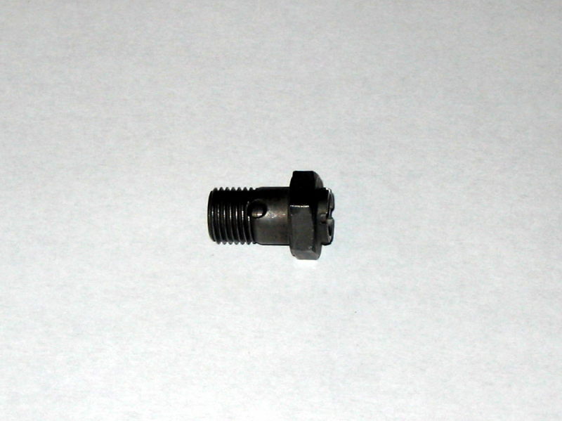

While cleaning the oil squirters and bolts, I found that the piston in one of the bolts was sticky and could be make to stick open as shown in the pics.
