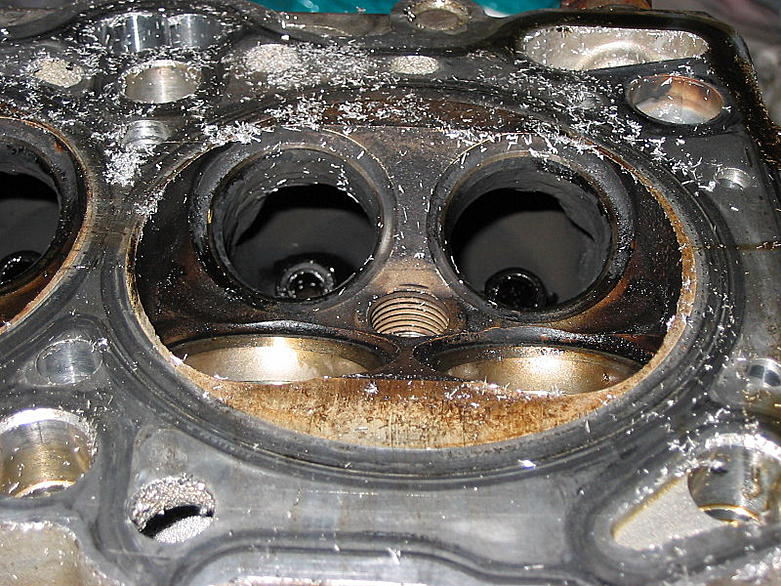

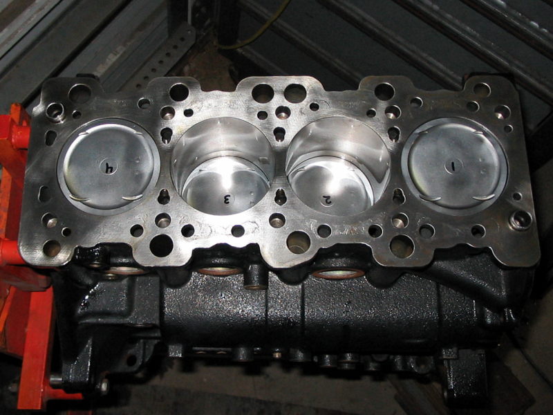

I've got the head disassembled for casting flash removal, mild porting and a thorough cleaning.

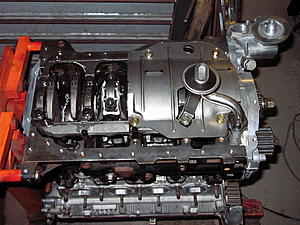

The shortblock is ready:
Attached Thumbnails Winter Project:  '06 MR Needs TLC-evo16.jpg

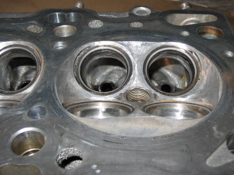

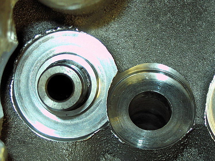

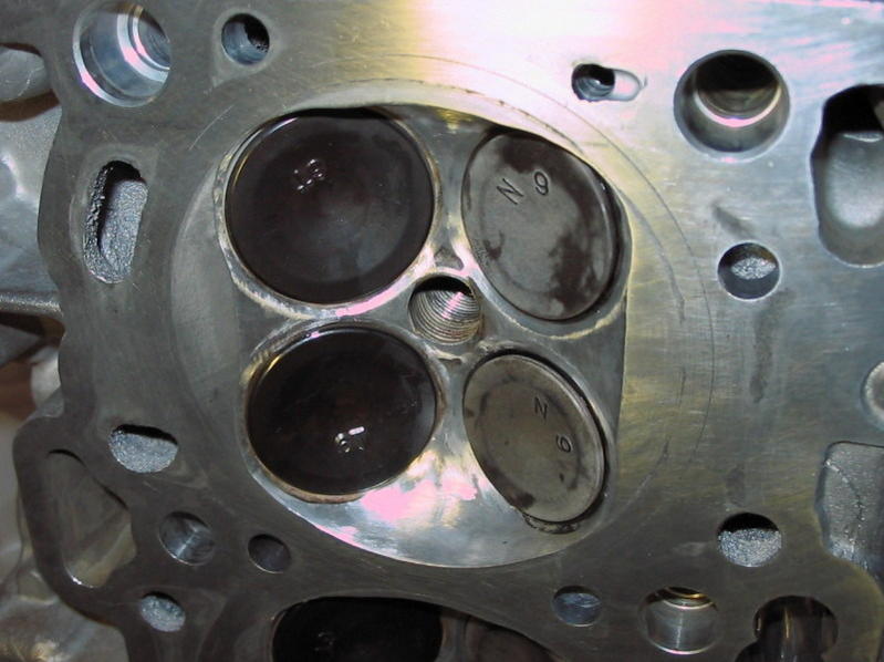

Some porting pics:
Attached Thumbnails Winter Project:  '06 MR Needs TLC-evo17.jpg   Winter Project:  '06 MR Needs TLC-evo18.jpg

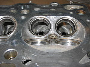

more
Attached Thumbnails Winter Project:  '06 MR Needs TLC-evo19.jpg   Winter Project:  '06 MR Needs TLC-evo20.jpg

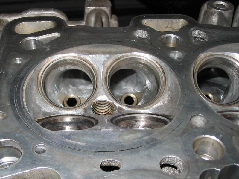

two more
Attached Thumbnails Winter Project:  '06 MR Needs TLC-evo21.jpg   Winter Project:  '06 MR Needs TLC-evo22.jpg

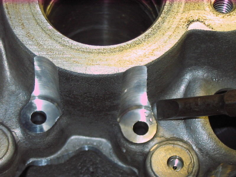

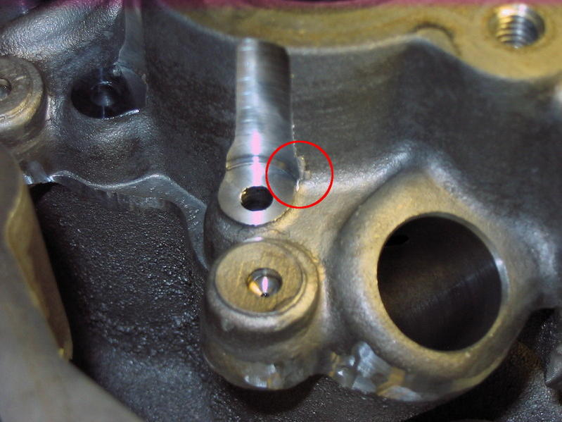

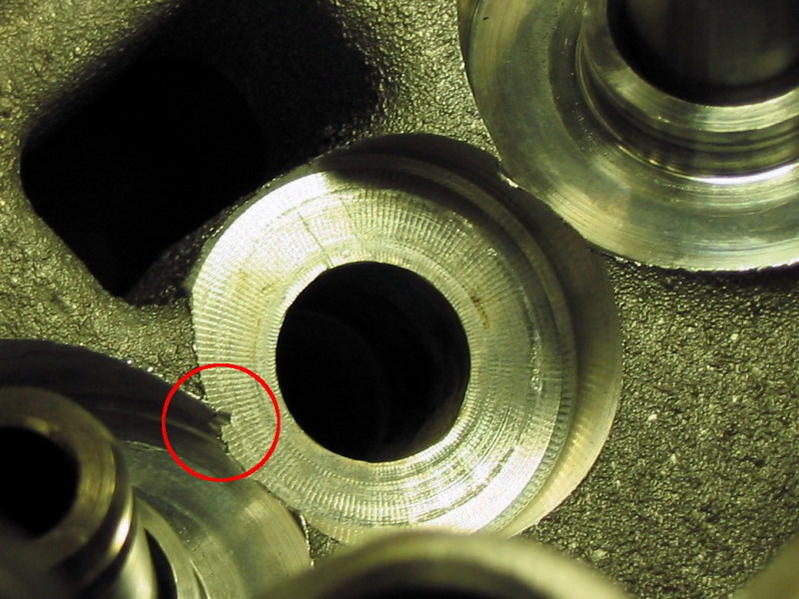

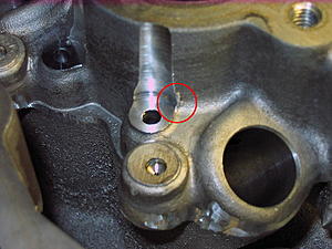

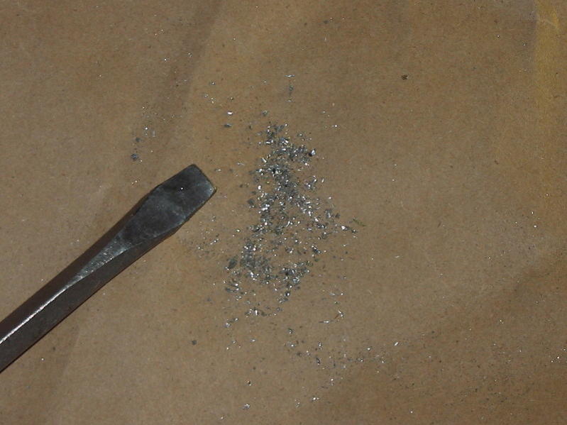

I ground the casting flash smooth in the area of the head covered by the valve cover, but found the machining flash to be worse. There seems to have been no post machining deburring performed at all.
Attached Thumbnails Winter Project:  '06 MR Needs TLC-evo23.jpg   Winter Project:  '06 MR Needs TLC-evo24.jpg   Winter Project:  '06 MR Needs TLC-evo25.jpg

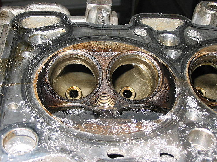

These burrs easily broke off and 15 to 20 minutes of work resulted in the pile of chips shown. That's a 10" screwdriver for comparison.
Attached Thumbnails Winter Project:  '06 MR Needs TLC-evo26.jpg   Winter Project:  '06 MR Needs TLC-evo27.jpg

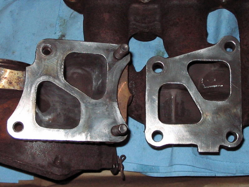

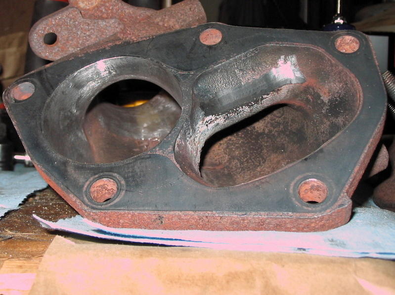

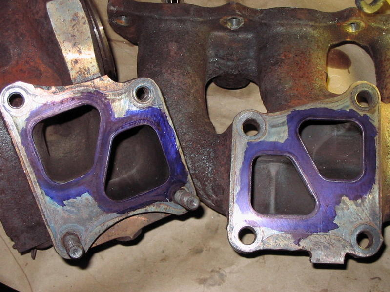

Port matching exhaust:
Attached Thumbnails Winter Project:  '06 MR Needs TLC-evo28.jpg   Winter Project:  '06 MR Needs TLC-evo29.jpg

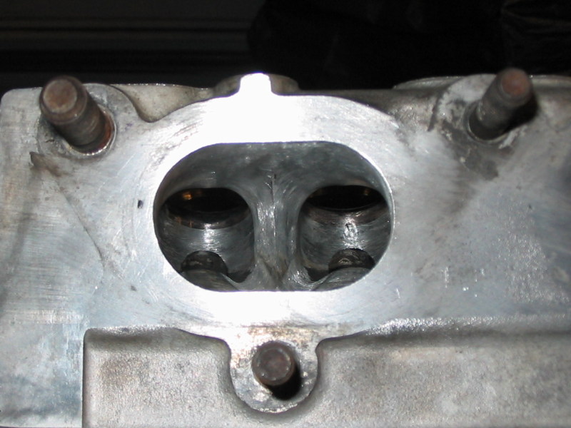

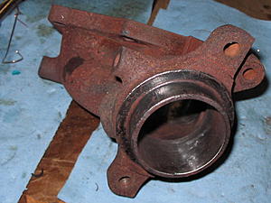

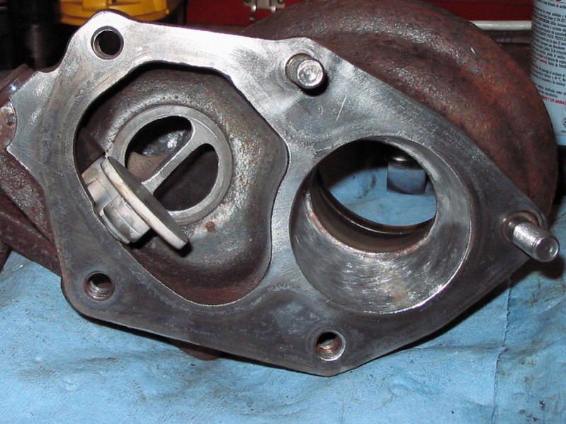

Turbine and O2 housing cleanup:
Attached Thumbnails Winter Project:  '06 MR Needs TLC-evo30.jpg   Winter Project:  '06 MR Needs TLC-evo31.jpg   Winter Project:  '06 MR Needs TLC-evo32.jpg

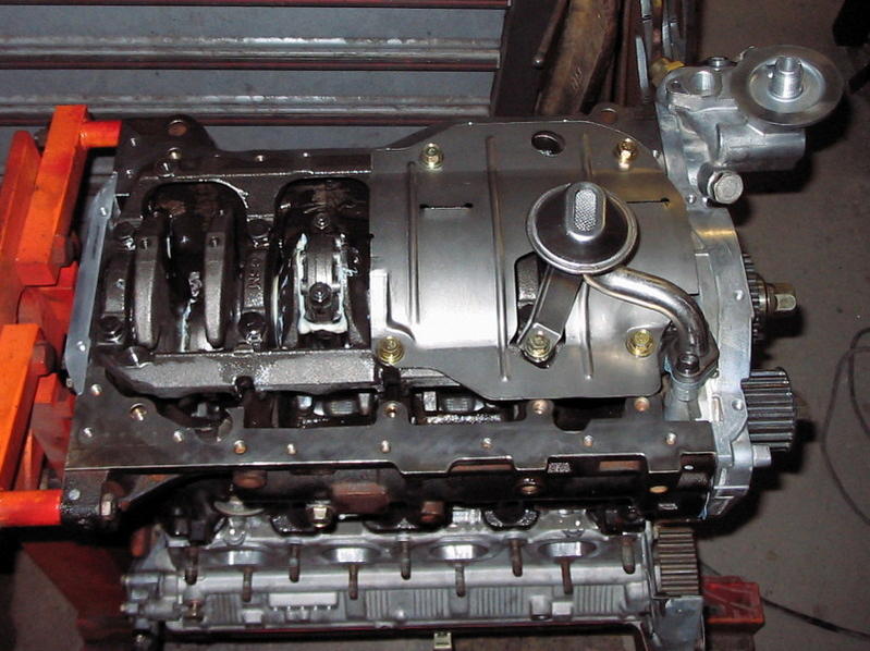

Bottom end shot:
Attached Thumbnails Winter Project:  '06 MR Needs TLC-evo33.jpg

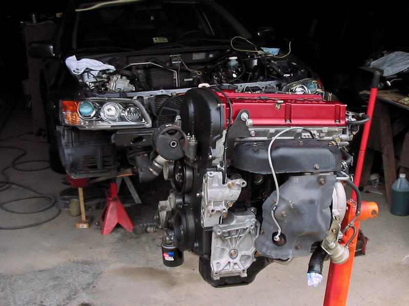

Ready to go back in:
Attached Thumbnails Winter Project:  '06 MR Needs TLC-evo34.jpg
