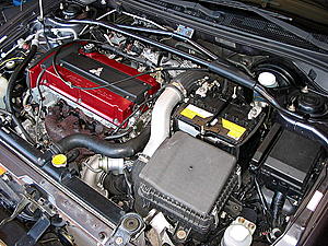

About to begin:
Attached Thumbnails Winter Project:  '06 MR Needs TLC-evo1.jpg

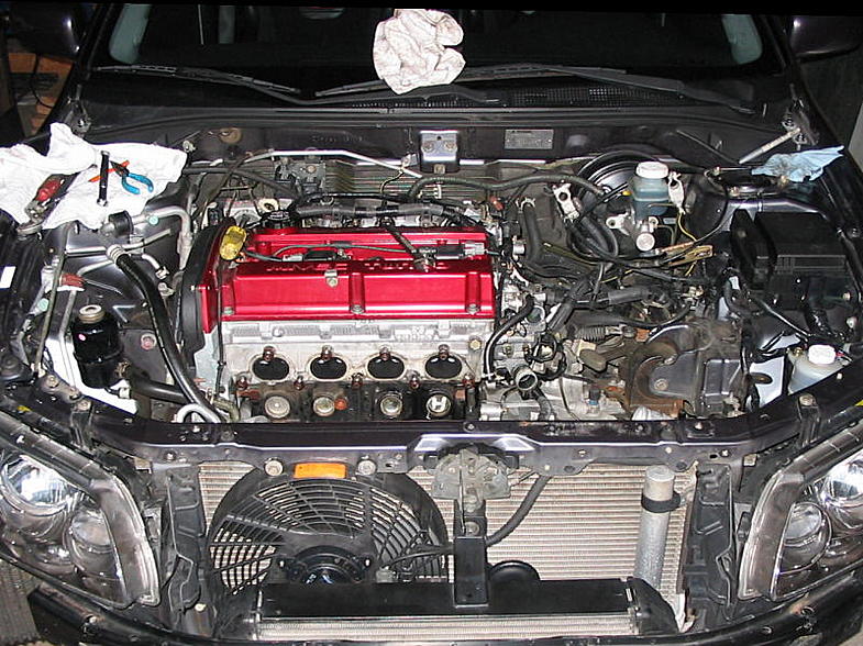

Engine shot:
Attached Thumbnails Winter Project:  '06 MR Needs TLC-evo2.jpg

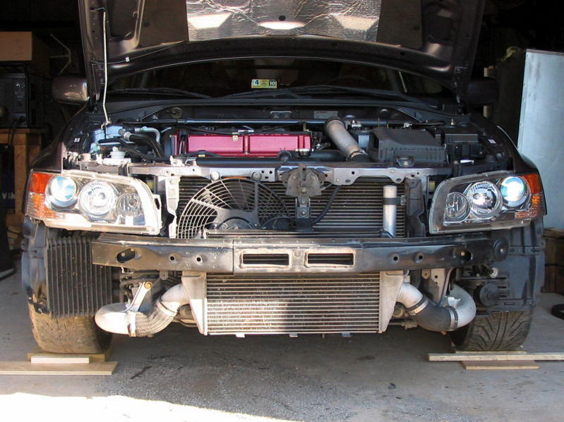

Initial pre engine removal disassembly:
Attached Thumbnails Winter Project:  '06 MR Needs TLC-evo3.jpg

Looks like the alignment is wacked. The passenger tire looks bald, while the driver's still has meat on it.
I think you're right, the RF wheel is also bent. I love previous owner(s).
