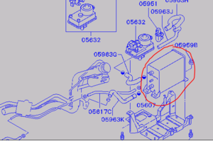

Originally Posted by Jehuty
which is evap canister
Your evap canister is located at the rear of your Lancer on the driver side (if memory serves correct). If you jack up the rear end of your car and get on a creeper you should see it tucked behind the rear bumper underneath. See the attached FSM diagram.

Checked this....everything looks good I think I'm going to do an ECU reset and see if it will make a difference. Last time the guy from Auto Zone just erased the code...sigh
