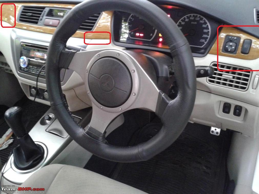

Hi,
I have a similar Question,
My car is a little different,
Is it the same way? Also I how do I remove the mirror control trim panel too?
thanks!
Old Jan 11, 2015 | 08:53 AM
evo8426's Avatar
iTrader: (27)
Joined: Jan 2006
Posts: 4,248
Likes: 9
From: Charlotte, North Carolina
Same way but for the mirror control you have to remove the bezel surrounding the gauge cluster which is 2 screws on the bottom side of the top portion of the dash.
Old Jan 12, 2015 | 09:16 PM
gregoryhouse's Avatar
Joined: Jul 2014
Posts: 11
From: In my Lancer!
thank you !!
Managed to remove it all last night. Wrapped them all in CF
