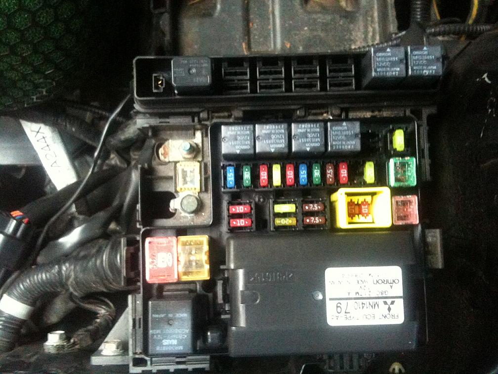

does anyone have a diagram of all the grounds to be checked? Also where is the starter relay. I just took my starter down to autozone it "failed." Was working fine a week ago. What gives?!

Does everything here look normal?
