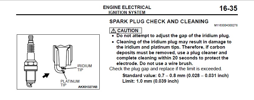

Old Jan 3, 2011 | 09:34 PM
Boosted Tuning's Avatar
Joined: Jun 2005
Posts: 2,383
Likes: 8
From: Chico, CA (Nor-Cal)
The factory gap on an EVO 8 is .028-.031. But I would recommend .025-.028
Attached Thumbnails misfire/sputtering?-untitled.jpg
