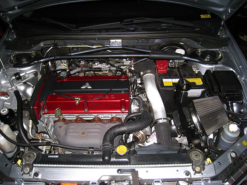

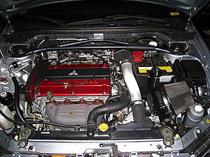

Yea. I had AEM intake before and fitment was . First of all, size of filter is huge therefore it rubs against hood when its closed. It filters really good though. Also they put bov wrong location. It's right under upper radiator hose and I had to squeeze bov in tight space. Other than that, I loved loud spool sound.
Attached Thumbnails Aem Intake welds? and coupler?-img_4641.jpg   Aem Intake welds? and coupler?-img_6155.jpg

fitment is definitely terrible, but main concern is also the welds that are in the intake? is all of yours like this also??
@Ryuartz - I believe the remedy to your problem from the bov hitting the radiator hose is actually trimming about an inch or an inch and a half off the rubber house from the uicp and it should clear it just fine.

I looked inside of AEM intake and welding looks same as yours. Maybe littlebit worse. haha. But outside looks really good though.

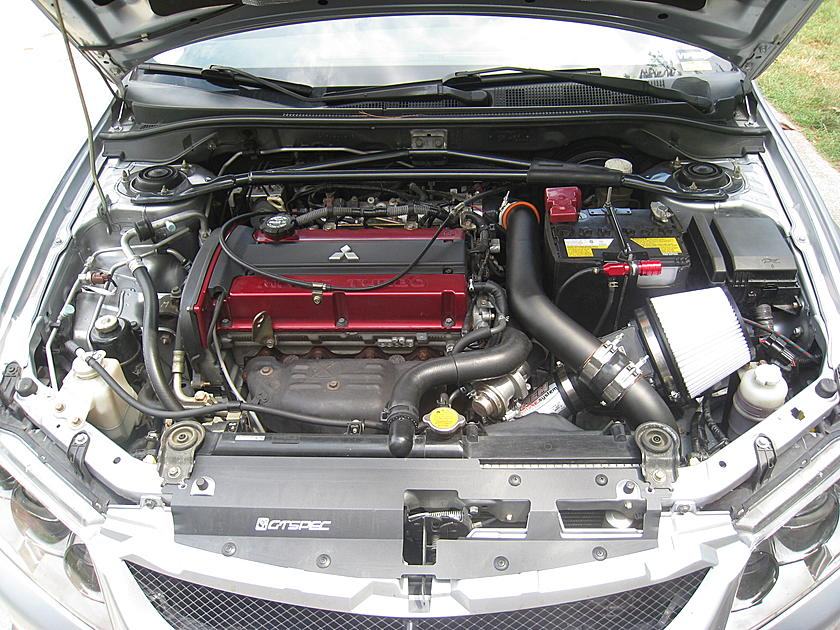

Don't know about turbulence but I've ran one for 3 years and never had any problems with something like "turbulence". Spooled really loud (the spool just echoed in this pipe) and makes the DV louder. Fitment was OK. I had some cheap no brand cone filter and it fit just fine. Then, I bought an Amsoil filter that was bigger and that fit just fine too. In order to avoid the filter from hitting the hood, you have to adjust the piping.
This setup worked great. I then removed my FMIC sprayer and it fit even better.
