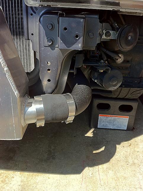

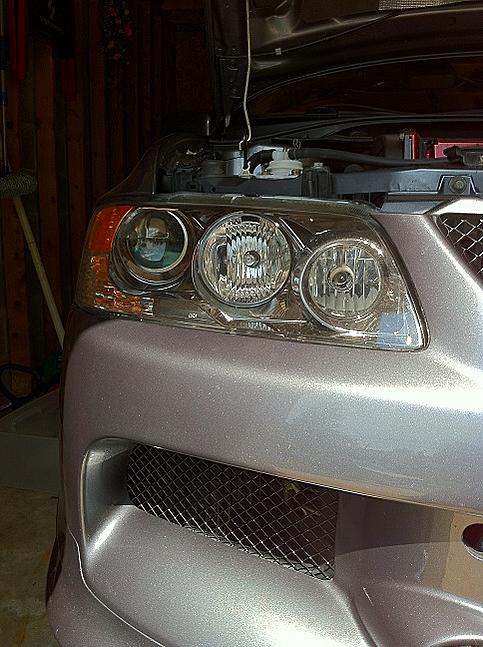

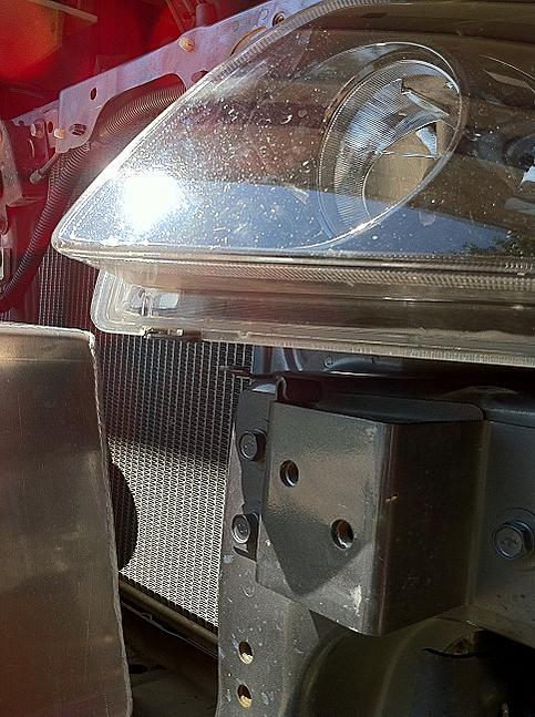

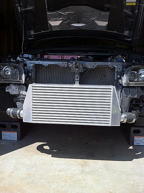

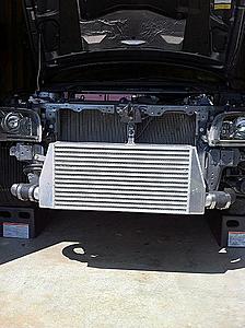

So got home from work and decided to give this another try. I ended up getting the bumper cover on, but serious gap below the driver headlight and then cover. I could pull up on the cover and it would get rid of the gap, but as soon as I let go it goes to normal. I did tighten, and fasten the cover up and it didn't take care of the gap. The passenger side fit good, maybe to tight actuall, lol. I took pictures of this, along with the bumper cover off. I still can not get the notched out part of the metal bracket on the cover to go on the bumper hook. I feel like taking the damn things off lol. To me its almost like the intercooler and piping is too low on the drivers side, and pulling the cover down, but when I look I can't see this happening. Let me know guys
