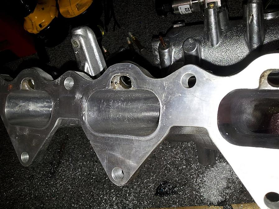

Ok Guys so this is my first time porting and I finished my intake manifold and about to start my head let me know what you guys think........CONSTRUCTIVE CRITICISM is perfectly fine let mw know what I need to do to get better or if I messed up somewhere!!!!

Also i couldn't get super far into the runners because the length on my bits......Let me know If I should port further in or if its fine??

You are on the right track for sure. Eastwood offers longer bits if you are trying to extract every bit of power out of the stock manifold. I would definately get a 65mm tb and port the tb flange while the manifold is off. The stock mani is a pain to remove

Ok I will look into eastwood bits because I do want longer bits for sure thanks for that info!!
Also yes I hate taking the manifold on and off lol....and I did port the stock throttle body a bit But I might upgrade manifold soon so we shall see...... I just want to know what the car makes with ported mani and throttle body with a 6266 turbo. s3 cams fully ported head ect...

you have done a nice job just gasket match the ports and polish it and get a telescoping gauge to measure the width and the height of the port through the runner in order to make all the dimensions the same throughout the runner.

Not shaby, just need those longer bits to get into those hiding places

quote=kevork87;10199708]you have done a nice job just gasket match the ports and polish it and get a telescoping gauge to measure the width and the height of the port through the runner in order to make all the dimensions the same throughout the runner.[/quote]
Yes I will do a gasket match and a telescoping gauge hmmmm never figured that but good Idea

Thanks for the comments guys longer bits are ordered and some more polishing will be done!

A telescoping gauge comes very handy, it came very handy for me bcuz where i live there are no machine shops who do cnc porting and port flow matching.
