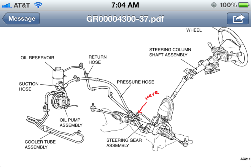

this is what i should be looking for?

Old Jun 6, 2012 | 09:40 AM
mekis13's Avatar
Joined: Sep 2010
Posts: 33
From: Kingston, PA
Yeah just follow those hoses and your leak should be somewhere around there at the connection or like the above poster said where the rubber and hard line connect. its hard to see because of the subframe but you can get fingers up there and feel around and from the top you can follow it most of the way.
Old Jun 6, 2012 | 12:28 PM
sr20det91's Avatar
iTrader: (59)
Joined: Jul 2003
Posts: 1,000
From: Deale, MD
Possibly behind the pressure hose on the return line. Its kind of hard to see in this photo, but there is a clamp there where the hardline goes into the soft line. I've seen them leak there plenty. It could possibly be the area you pointed out as well. Like the previous poster said, just follow all the lines. its a pain because its all tucked up on top of the sub frame but you can get to it.

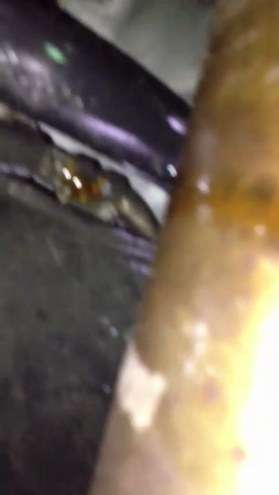

So guys that's the problem, looks like some sort of hard line? Can I fix this or I need to take to a shop?
http://i43.photobucket.com/albums/e4...y/4465f589.mp4

Old Jun 9, 2012 | 01:42 PM
sr20det91's Avatar
iTrader: (59)
Joined: Jul 2003
Posts: 1,000
From: Deale, MD
Its hard to see exactly where thats at from the video. More than likely you will need to drop the subframe to get to whatever line that is thats busted. Not a big deal if you know what your doing, but a shop will charge you alot of money for that. Fund someone local that will help you out with it. At least to let u know exactly what line it is u need to replace.

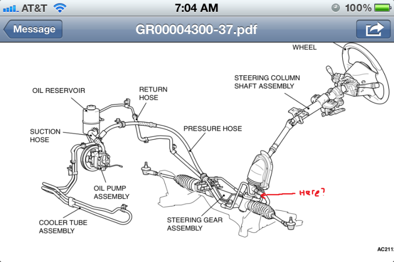

i found exactly! how can i fix this?
[IMG][/IMG]his?
[IMG][/IMG]his?
looks like the return hose. If you order a new return hose it should include that hard line, or maybe you can order that part separatly. If the hose is ok and its just leaking through the fitting, you may be able to get away with new crush washers for it. I cant remember if that line has a banjo bolt or not on it though.
