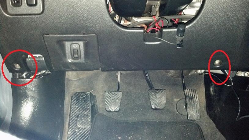

So basically these two screws and pull?

I'd first make sure there's slack in the wiring behind the switches. So take care of the wiring first if necessary.
I've had every panel off the dash the dash has and every one is an adventure. So, pull the screws and then do some careful prying until you get a sense of which way the clips go. Otherwise you are trying to break them off. Once it comes off it will look so simple but it pays to take your time.

What are the mini microphone thing in the picture, have 2 of thoose in my evo8 and I donīt know what it is...
