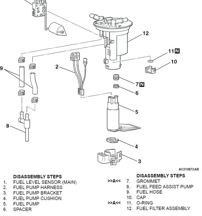

Does this filter look overly dirty/bad? I was wondering if this could cause me to run lean up top? Thanks

That thing in your picture isn't the filter it’s just the "fuel sock" or screen, it just keeps the big chunks out. The filter is up in the housing next to the pump.

That diagram doesn't list the sock separate from the pump. Does anyone know the part number for just the fuel sock?
