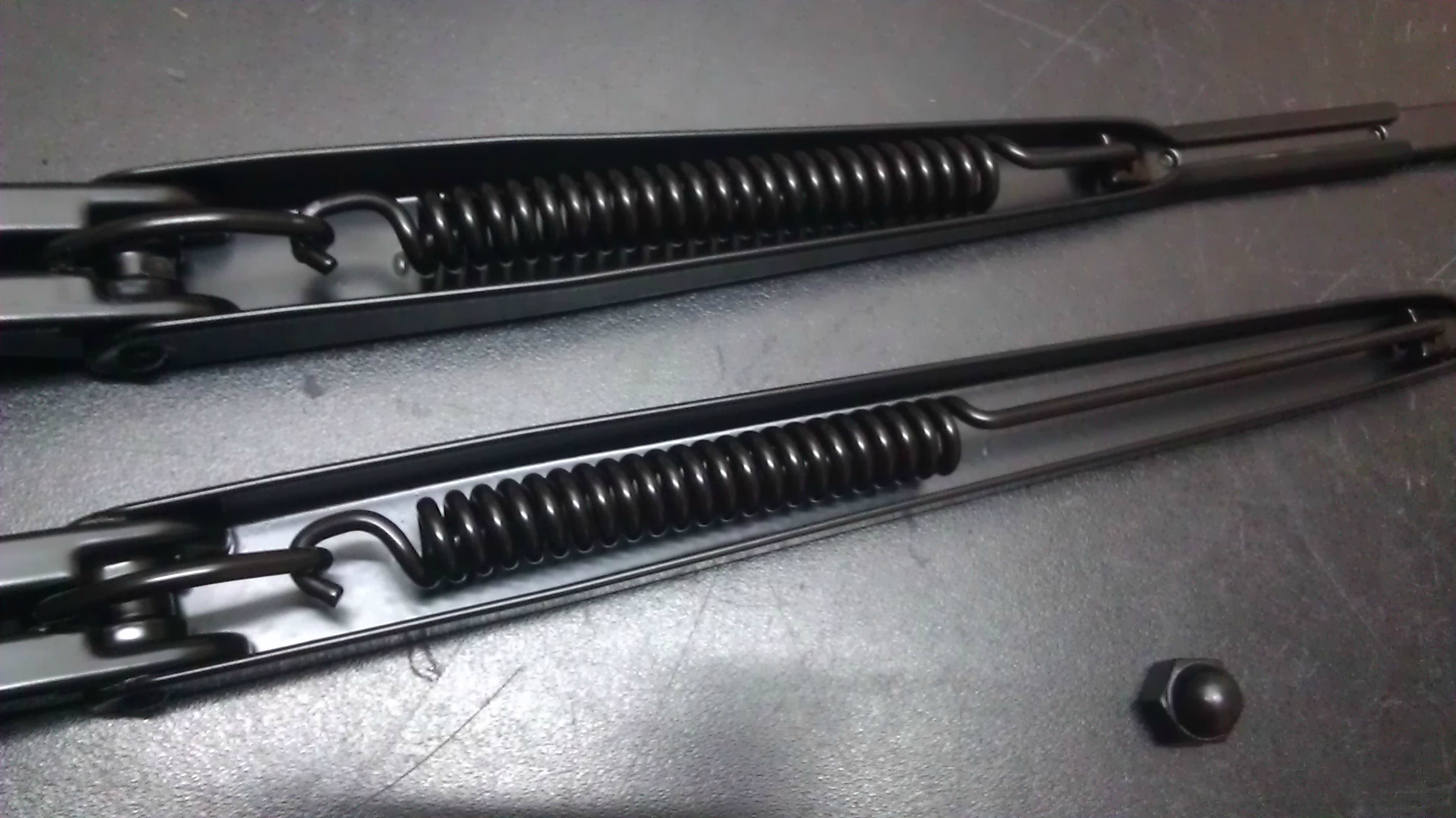

I'm diggin' the door lock things or whatever you call them LOL. Wipers too.

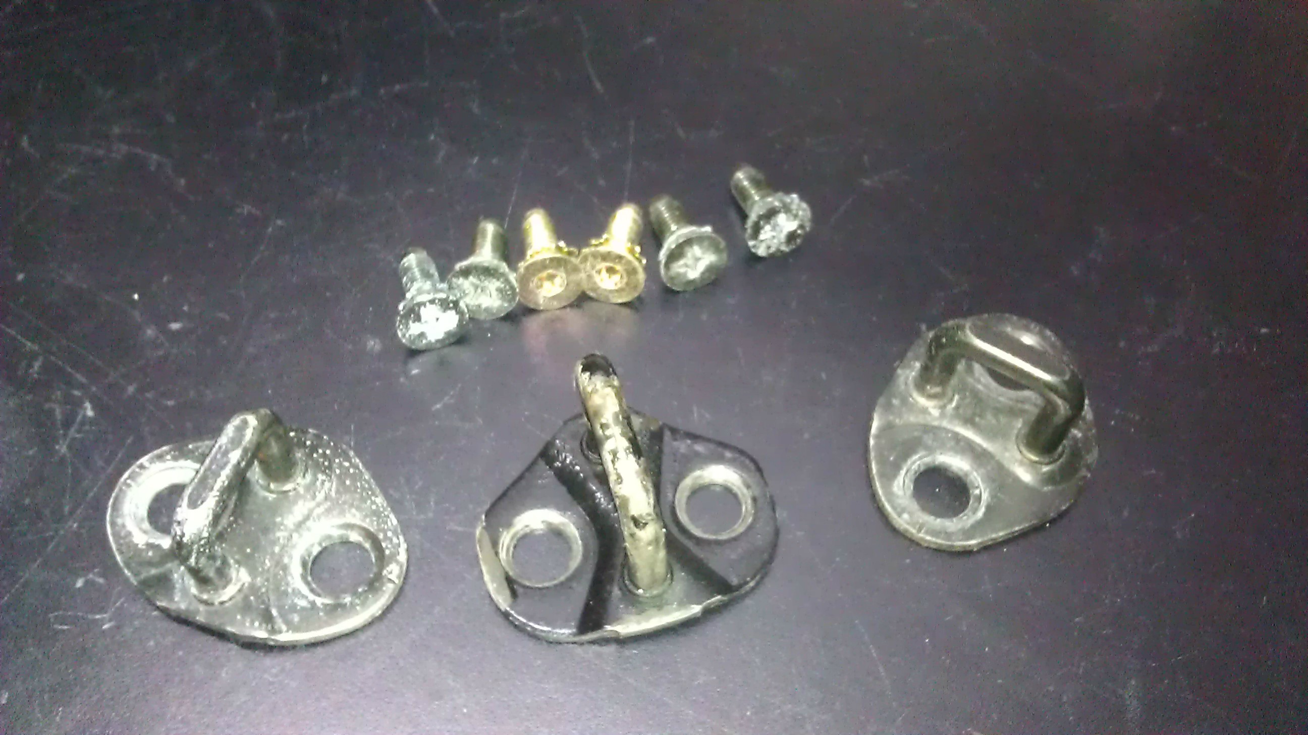

Lol thanks, I think they are called door strikers, but don't quote me on that.
And the door strikers before

Also, with the door strikers... You do realize that the powder will chip/flake/crack off the first few times you close the doors, correct?

I thought the same thing about the door strikers, but since I have 2 cars worth of parts, I had extras to test on. I have installed them and opened and closed the door at least a couple hundred times. They have not chipped yet, the matte black is just a little glossier where the latch hits it. Holding up great honestly.
