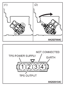

You just have to adjust the TPS. 5.00v full open, and i set mine at .073v closed. Just stick a multimeter lead in the middle wire, and the other lead to the negative bat. cable. ( or ground). loosen the tps so you can move the sensor itself. (key on engine off).
You can even just adjust it by using EvoScan. You just have to rotate the TPS until you get the desired %.

My middle wire doesn't read .065 it reads .65. .073v would be like 2% in evoscan am I correct? With those directions the tps should be lined up with the tab in the throttle body and rotated up correct?

Ya sorry I added a 0. it should work properly now.
